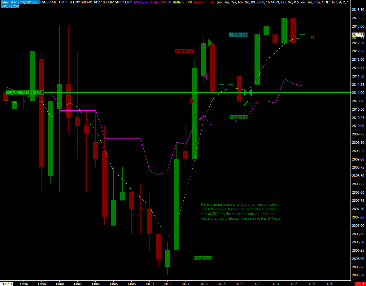

[2018-08-01 18:42:19]
Richard Chinn - Posts: 35
http://www.sierrachart.com/image.php?Image=1533148536407.png
This is from a chart running right now.
As you can see a position was opened on this bar.
The bar also shows a close on the same bar and at the same price in this case.
You can see that I've taken the snapshot a few bars after the bar and the position did not close
even though there is a message -1@2811.00 that a position close took place.

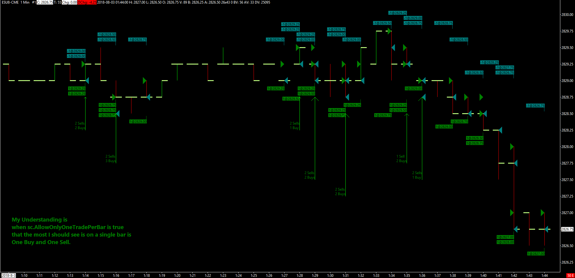

So here is what I did to prove it for you:
I deleted my Sierra Chart directory and downloaded the program again. It is version 1785. So I am working from a completely clean install.
The only changes I have made to the settings are:
Trade>>Show Order Fills
Trade>>Show Orders And Positions
The snippet below does make sure that sc.AllowOnlyOneTradePerBar is set to true.
I opened a 1 minute chart for the S&P500. I made NO changes to the chart or any of it's settings. I'm on Rythmic data service.
I wrote this short function (No fluff whatsoever) to prove what is happening:
#include "sierrachart.h"
SCDLLName("EntryTest")
SCSFExport scsf_EntryTest(SCStudyInterfaceRef sc)
  SCInputRef enabled sc.input[0];
  s_SCPositionData PositionData;
  sc.GetTradePosition(PositionData);
  if (sc.SetDefaults)
    sc.AllowOnlyOneTradePerBar = true;
    sc.AutoLoop = 1;
    sc.FreeDLL = 0;
    enabled.Name = "Enabled";
    enabled.SetYesNo(false);
  if (!enabled.GetBoolean())
    return;
  s_SCNewOrder NewOrder;
  NewOrder.OrderQuantity = 1;
  NewOrder.OrderType = SCT_ORDERTYPE_MARKET;
  NewOrder.TimeInForce = SCT_TIF_DAY;
  if (PositionData.PositionQuantity == 0)
    sc.BuyEntry(NewOrder);
  else if (PositionData.PositionQuantity >= 1)
    sc.SellEntry(NewOrder);
I ran this on LIVE data, SIMULATION mode.
You can look at my chart, generated from the function above, http://www.sierrachart.com/image.php?Image=1533264496906.png
and tell this is clearly not correct, at most we should see no more than 2 fills per bar, 1 BUY and 1 SELL,
but PLEASE run the snippet for yourself, you can see it is a complete function with NO fluff whatsoever.
I noticed running this snippet without any type of delay that the program will momentarily display a "Not Responding" message which does clear after several seconds.
My Trade journal correctly shows orders as Order Sent | Open | Filled in the Order Status column.
The additional displayed but not real orders shown on the chart are NOT listed in the Trade Activity Log.
This is what I expect because an actual order was not made and should not have been made because only one trade per bar is set to true.

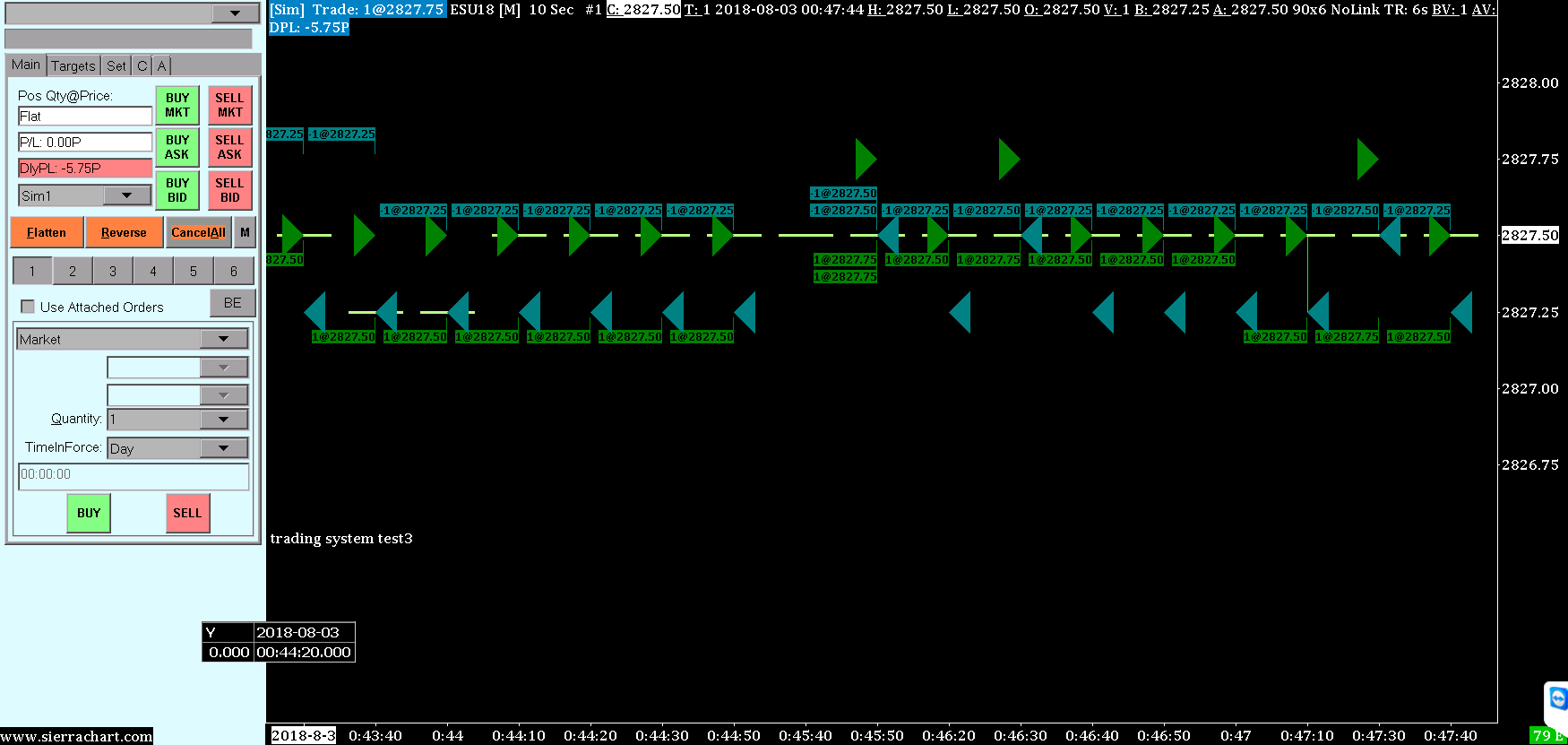

We will test that but the reason for this:
Is that study function is doing processing on all of the historical bars and may be generating a lot of log messages. You need to add a check to not do any processing when sc.IsFullRecalculation is true. We can see our examples do not have that check. We will need to update them.
We are quite certain that your conclusions are not correct.
We tested your system and sometimes we do see what you are seeing:
http://www.sierrachart.com/image.php?Image=1533271676928.png
We do sometimes see more than two fills on the same bar but that is just going to be a case of the actual timing of the fill itself. We would have to look into that to understand that better. We do not think it is a case, where the triggering itself is actually occurring for each order action type, more than once per bar. But we would have to verify that.
And all of those fills are in the Trade Activity Log. There is no way we can believe otherwise. We clearly see them. We can do a remote assistance session and show you.
Never in the history of Sierra Chart has anyone ever reported this and we have never seen this:
We definitively do not believe this to be true and it cannot be true.
