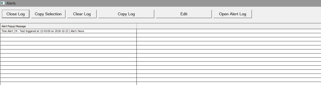

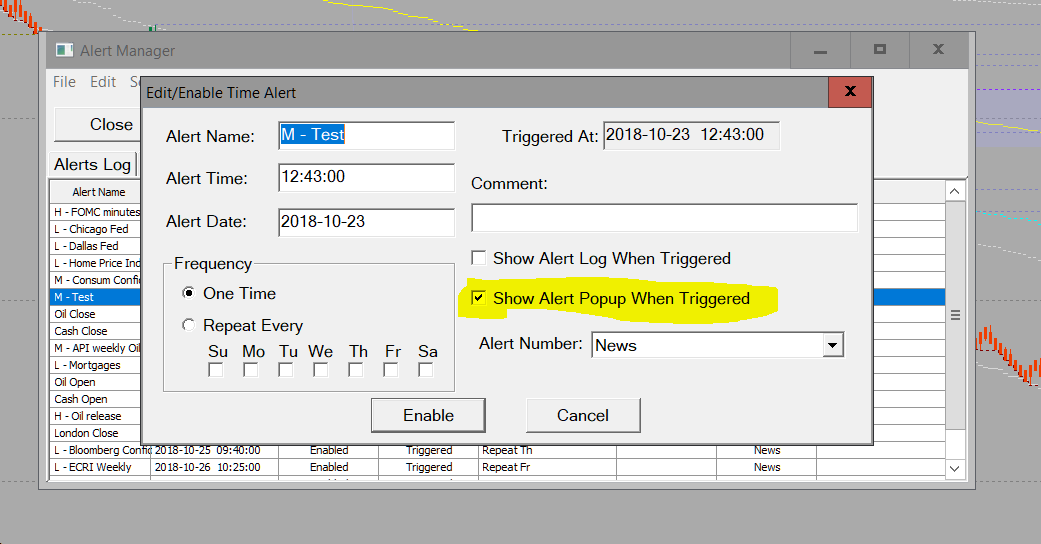

In version v1825 this still does not seem to be working correctly.
When a time alert triggers it now brings up the Alert Log window (see attached Alert1) even though the time alert is configured to show the Popup window and not the Log window (see attached Alert2).

[2018-10-24 23:44:12]
That window you see is the new Alert popup log for these types of alerts. It automatically clears them when you close it.

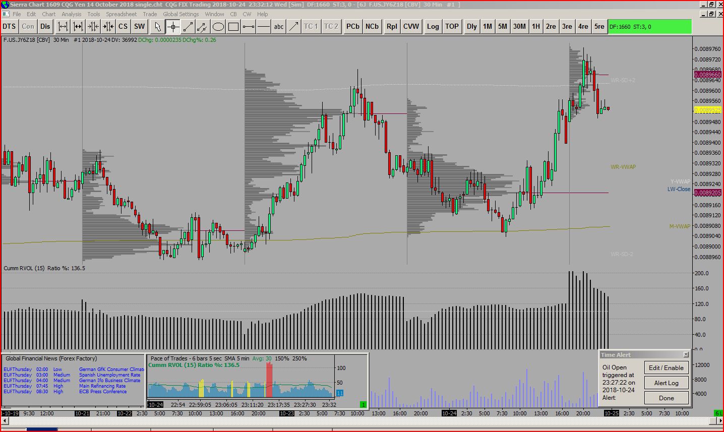

[2018-10-25 02:47:40]
User13668 - Posts: 296
I don't understand why you have done this as now the 'popup' window is no different to the alert 'log' window in terms of presentation and information.
A 'popup' should be a smaller window that the main screen it is 'popping up' on. But now it needs to be a large window to read the information.
I used to have the former popup window present itself in the bottom RH corner (see Alert3 attached) to warn me 5 minutes before some news item I had set up as a Time alert. I would then leave the popup window in place until the news event had passed as a reminder.
But now as you can from Alert3 attached, that no useful information is displayed as the configuration of your new presentation means a small popup window presents no useful information.
Why can we not have the old format of a true pop window back, given the alert log window already gives usu the information and presentation format that the new popup window does.

[2018-10-25 03:38:35]
Based on the screenshot you can reduce the size by 70%:
https://www.sierrachart.com/Download.php?Folder=SupportBoard&download=23061
Anyway, we do know that the buttons should be replaced by menu commands and that is something we have in mind already. That will give you more viewing area of the main list.
You can also get another monitor to put the Alert pop-up window on.
And the new window presents less information and is always kept cleared when you close it.

[2018-10-25 03:49:34]
I was just about to post an edit to my message to show you what it looked like under a previous version of SC and how I was using it to 'sit' on the trading screen as an alert (see attached Alert4).
As you can see the old 'popup' has no superfluous information like headers and menus.
I already use 3 screens, but having it in front of you on the trading screen means I am less likely to forget about the actual alert while trading.
Even if you had an option to hide the menu bar/items (like you have for normal charts) might help.

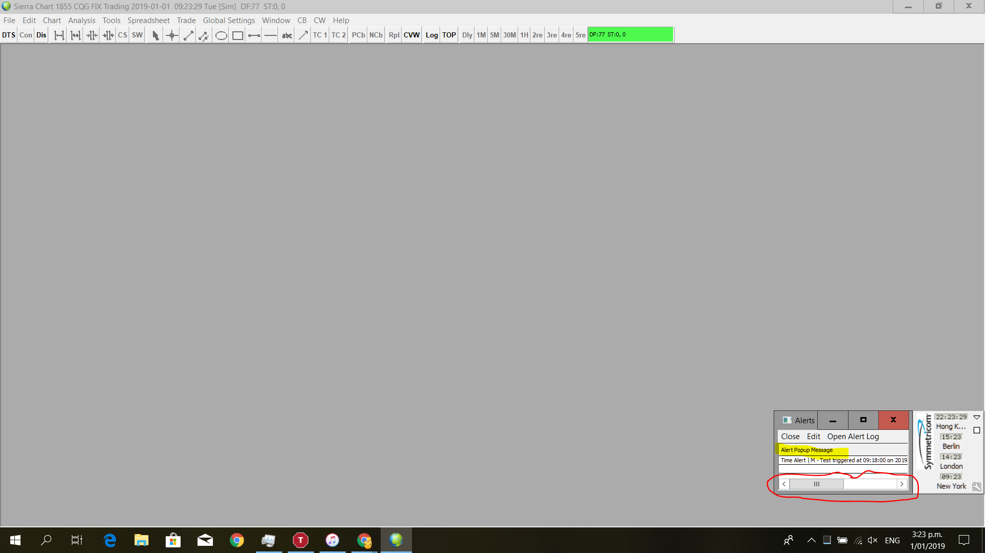

[2019-01-01 12:02:22]
Have a look at this in prerelease 1855.
[2019-01-01 16:35:21]
Thanks, I can live with that.
I do however question the value in the name "Alert Popup Message" taking up valuable screen space (see attached - yellow highlight). We know what the dialogue box is, plus the Title Bar already tells us that, as well as the words "Time Alert" appearing to the very left of the actual alert message.
In addition it would be even better if we had the option of turning on/off the scroll bar (circled in red) like we can on other SC windows as a means of saving even more screen real estate.
Appreciate you considering the above.
Cheers
imageSC Popup Alert.PNG / V - Attached On 2019-01-01 16:34:53 UTC - Size: 153.37 KB - 589 views
[2019-01-01 20:23:00]
We apologize for this. This was an oversight. This will be removed.
We will see what we can do in regards to the scrollbar.
For an understanding of the basis of these changes, it relates to general development and changes to standardize the Dialog type windows to a common code base for uniform code and easier maintenance and also to allow porting to another operating system more easily.
