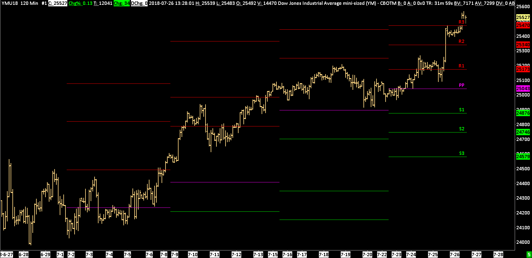

I cannot upload a copy of the chart. In settings the only setting I have changed is the time period type to weeks. All other settings have not been touched. All I am trying to do is see the weekly pivot point on other time frames as well not just the weekly time frame. For example, I would like to see a weekly pivot point applied to a 15 min and a 1 hour time frame. How can I do this?
Thanks again!
[2018-07-26 18:40:49]
Here is an example:
http://www.sierrachart.com/image.php?Image=1532630289126.png
