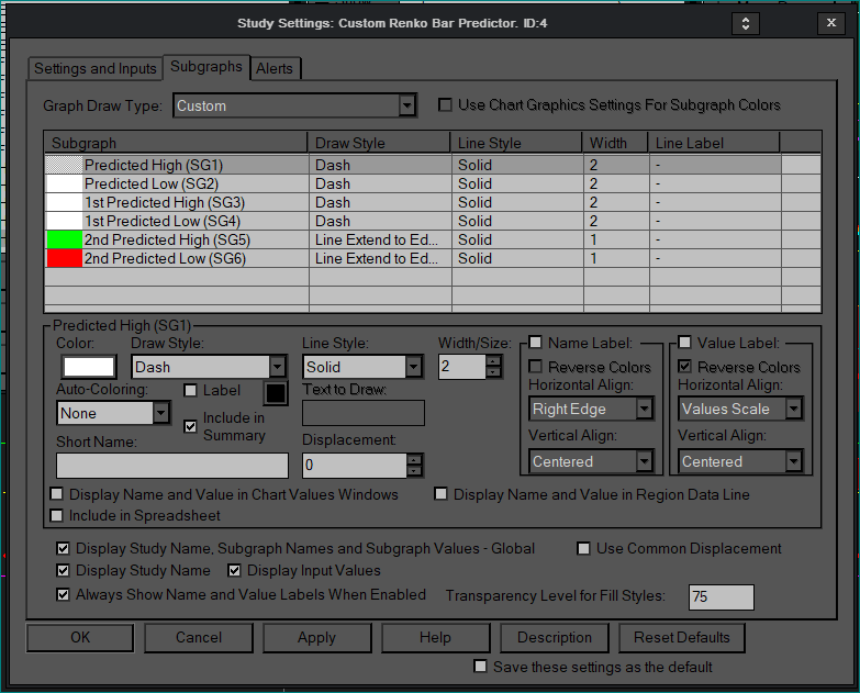

Xfanman1 - Posts: 320
Engineering, I've attached images below of my modified version of the Renko Bar Predictor that has added inputs for multiple targets and/or offsets. I find this VERY useful when choosing entry location and targets. If you haven't finished the update to this study yet maybe other users would find this added flexibility useful.
Thanks!
Scott
Date Time Of Last Edit: 2018-07-16 19:02:43
imageRenko Bar Predictor.PNG / V - Attached On 2018-07-16 19:01:44 UTC - Size: 57.67 KB - 830 views
imageRenko Bar Predictor Subgraphs.PNG / V - Attached On 2018-07-16 19:02:40 UTC - Size: 47.9 KB - 554 views
