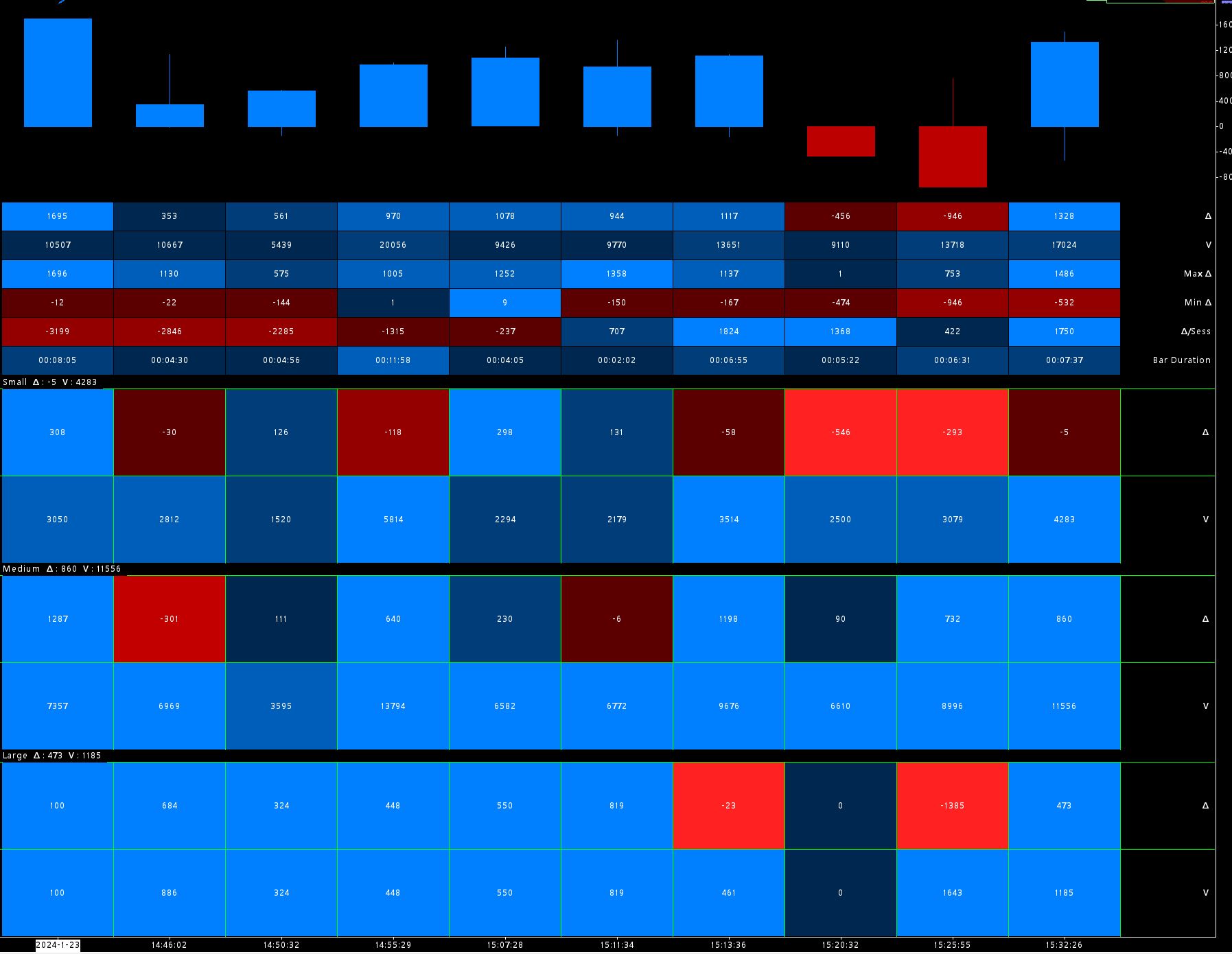

When using Study/Price Overlay on a Numbers Bars Calculated Values study the Grid Lines (SG51) is missing.
The overlay grid is green and I cannot seem to find a way to change it.
Is there a way to have the SG51 subgraph be included on a study/price overlay?

At the moment the same problem/question. 6+ years later ;-)
Now it's SG55 Grid Lines.
All "green grid lines" NBC are imported with study overlay.
Date Time Of Last Edit: 2024-01-23 20:51:37
imageNBCoverlay.JPG / V - Attached On 2024-01-23 20:51:32 UTC - Size: 196.57 KB - 259 views

You can not "Overlay" the Numbers Bars Calculated Values to another chart. When you do this, you will get the values for the chart it is put on, not the original values from the source chart.
The only method for getting the data from one chart to another using the Numbers Bars Calculated Values is described at the following link:
Numbers Bars: Overlaying a Numbers Bars Calculated Values Study from Another Chart

Thanks for the clarification. At SierraChart you never stop learning and you may sometimes forget something.
I will now follow the path described in the documentation. -> It works -> Grid lines change be changed now ;-)!
Nevertheless, the “overlay” seems to work somehow (see picture - 1. NBC=total Volume | 2.3.4.NBC=Volume filtered). The volume filtered data from the other charts with NBC were transferred correctly with overlay.
Thanks!
[2024-01-24 16:12:35]
We can not say why the Overlay worked in this case, but in general it is not setup to function correctly. The method described in the documentation is the only way to do it to ensure that you have the correct information.
