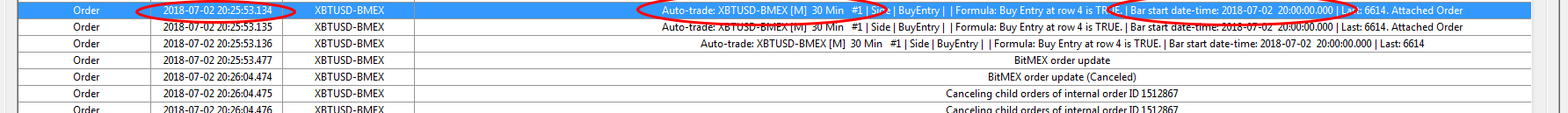

[2018-07-02 18:42:58]
User513228 - Posts: 41
Few days after i created this topic was okay again. But few minutes ago did it again and i get signal in NON-SIMULATED mode. Now i tried install latest version, run backtest but this order is still there. Check attachment. BTW im using RENKO Chart. Maybe is problem there

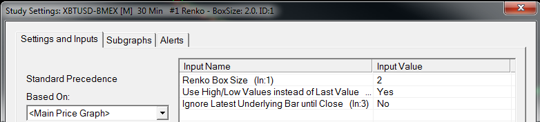

[2018-07-02 18:53:05]
My Renko chart config in attachment. Last two months was okay. Problems stared when i created this topic

[2018-07-02 19:39:09]
Okay now we understand the problem. We are declining support for this. Do not use the Renko study. We provide no support for that whatsoever and we are going to need to remove it.
Use the Renko bars as documented here:
Renko Bar Charts
