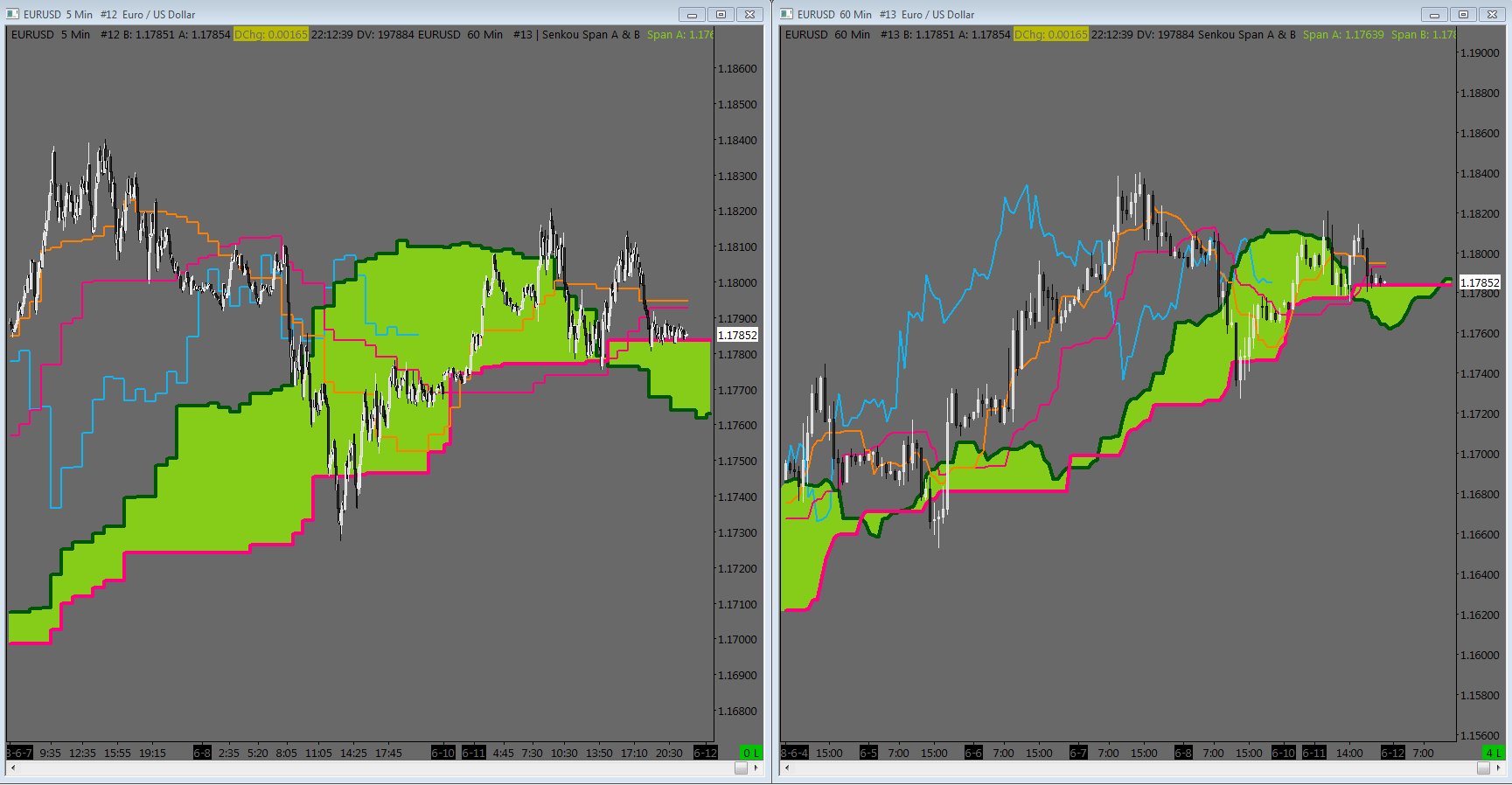

grantx - Posts: 244
http://www.sierrachart.com/image.php?Image=1528537180819.png

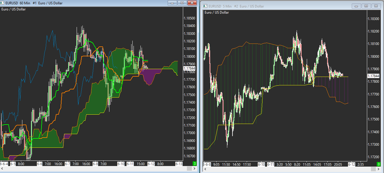

I am using Study price overlay to get 'senkou span A B' from a higher timeframe chart to my lower timeframe chart.
THe problem is that it is not filling properly. See the image.
[2018-06-11 17:43:55]
Not sure exactly what you mean by filling properly, but have a look at this documentation:
Chart Studies: Filling the Area Between Two Study Subgraphs within Different Studies
[2018-06-11 18:42:19]
grantx - Posts: 244
If you look at the picture that I posted you will see that the Kumo cloud (ichimoku indicator) is not filling in that area properly.
It has lines in it. It needs to be a solid colour.
The study you recommended does not work because these indicators are coming from another chart using the 'study price overlay'.

grantx - Posts: 244
My main higher timeframe chart looks like this:
http://www.sierrachart.com/image.php?Image=1528746144835.png
The 2nd lower timeframe chart looks like this:
http://www.sierrachart.com/image.php?Image=1528746207963.png
I am using the 'study price overlay' to get the ichimoku study from the 1st chart to display on that 2nd chart but as you can see it is not displaying properly.
I need to have that region filled in because it is distracting with the lines.
@ElmStreetTrader Im not sure what you mean. Id appreciate if you would be kind enough to elaborate.

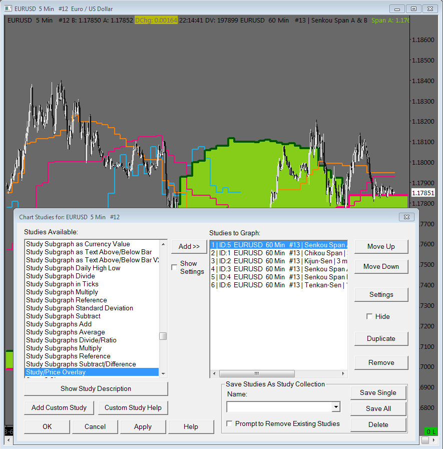

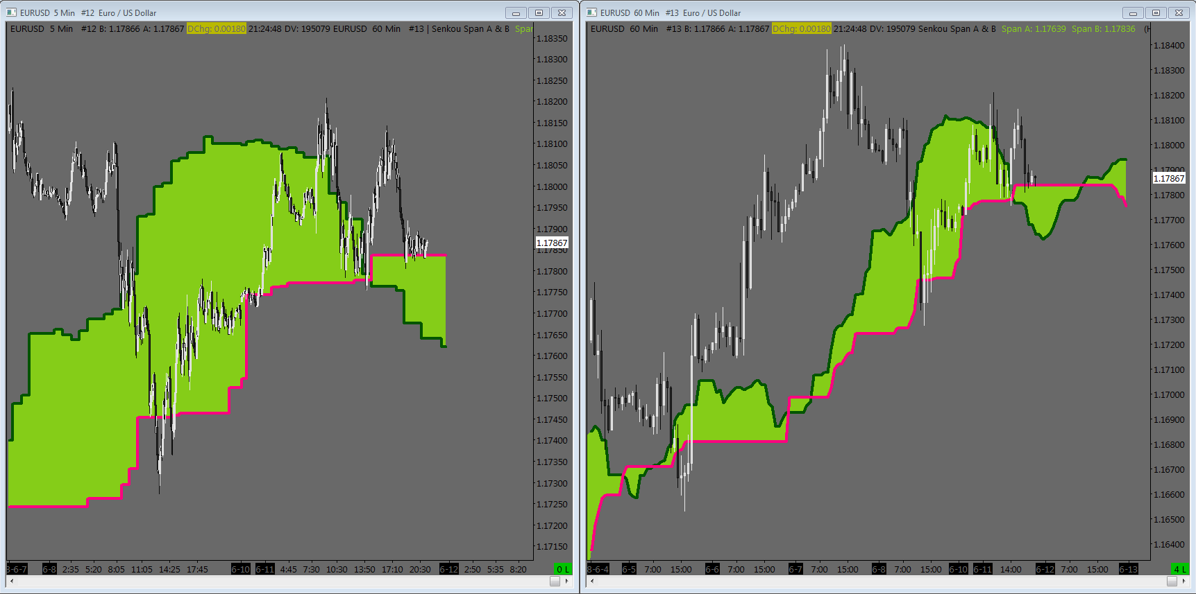

ElmStreetTrader - Posts: 48
This is what I get:
imageEU2.PNG / V - Attached On 2018-06-11 20:13:30 UTC - Size: 99.61 KB - 533 views

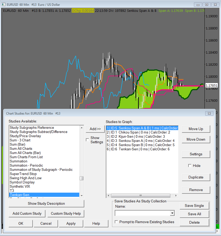

And here are the study windows:
imageEU3.PNG / V - Attached On 2018-06-11 20:15:47 UTC - Size: 66.27 KB - 491 views
imageEU4.PNG / V - Attached On 2018-06-11 20:15:57 UTC - Size: 79.09 KB - 489 views

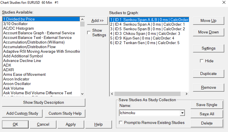

grantx - Posts: 244
Here are the charts with settings.
image1.PNG / V - Attached On 2018-06-11 20:30:46 UTC - Size: 73.74 KB - 656 views
image2.PNG / V - Attached On 2018-06-11 20:30:50 UTC - Size: 38.96 KB - 473 views
image3.PNG / V - Attached On 2018-06-11 20:30:54 UTC - Size: 39.26 KB - 489 views

[2018-06-12 07:28:41]
grantx - Posts: 244
It worked! Your studies worked.
Why yours worked and mine didn't is a mystery to me. I restarted the pc this morning for the first time in a few days so maybe that...
Thanks for your help ElmStreetTrader. Appreciate it.

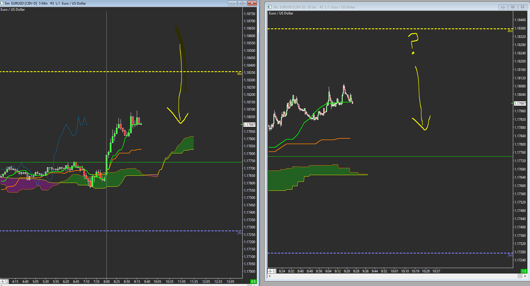

grantx - Posts: 244
One last thing. See how the kumo cloud is projected forward in the 1st chart but in the 2nd chart it stops at a point and goes no further?
Any ideas on that?
imageCapture.PNG / V - Attached On 2018-06-12 08:27:50 UTC - Size: 73.82 KB - 544 views
[2018-06-12 08:41:13]
I don't think you'll be able to get that aspect to match.
