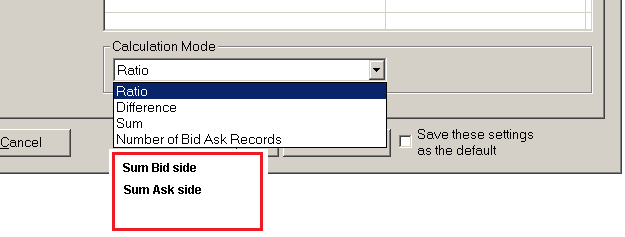

We have a few calculation methods for this study. Can you add the ability to SUM:
1. Just the Ask side.
2. Just the Bid side.
Two subgraphs, abv/below zero line similar to the way the "bid volume vs ask volume" study displays. thx
see pic
Date Time Of Last Edit: 2013-10-13 21:45:36
imagebidask depthbars.png / V - Attached On 2013-10-13 21:41:31 UTC - Size: 6.82 KB - 907 views

Al SC Developer - Posts: 434
In ver 1036, there is a new option "Bid Depth vs Ask Depth", which will show the bid and ask depth in a similar fashion as the bid volume vs ask volume study.

SgtJ - Posts: 154
Al, thanks for the addition. I think what I said above was a little misleading re bid vs ask study. W/ the new option was hoping it would still display in a fashion that showed the OHLC of the individual bars similar to how the other depth options work...is that a doable change/option?
In ver 1075, two new options were added to match your original request (Sum Bid Side and Sum Ask Side). These will display with OHLC bars. Also, the difference sub-graph (and others) can be changed/hidden.
