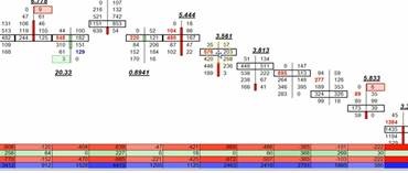

Hi there,
I am looking to create a 'numbers bars' chart which has the candlestick running through the middle of the bid/ask numbers instead of surrounding the numbers.
Unfortunately when I try to do this, the candlestick is too wide and overlaps the numbers (even though I have reduced the width of the candlestick using the graphics options).
The only way this will be possible is if there is a way to increase the space between the bid/ask numbers in the numbers bars. I have currently selected the “Two Spaces” option under the “Numbers Separator Character”, but this does not give sufficient space down the middle of the bar.
Could you please help me achieve a chart?
Thanks,
Talai
imageValtos.jpg / V - Attached On 2018-05-29 19:48:01 UTC - Size: 13.54 KB - 923 views
[2018-05-30 05:44:52]
This is not supported.
You instead need to use this Input to draw a candlestick around the Numbers Bar:
http://www.sierrachart.com/index.php?page=doc/NumbersBars.php#Input_OpenAndCloseMarkerStyle
Date Time Of Last Edit: 2018-05-30 05:47:02

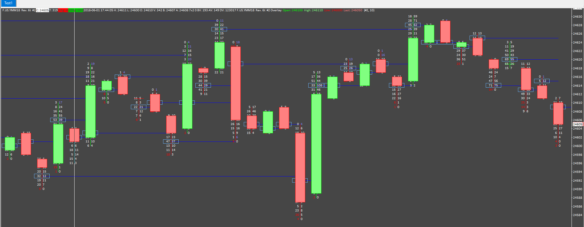

[2018-05-30 08:48:11]
binaryduke - Posts: 387
Another way to achieve this on a Numbers Bars chart is by using the Study/Price Overlay Study to overlay the main price graph on the chart. If your candles appear too wide, use Global Settings>Graphics Settings - Global>Other to reduce the candlestick width %. Here they’re at 8% and the numbers bars text is 10 point. Chart Settings chart draw type needs to be set to Candlestick.
Screen grab and study collection attached.

[2018-05-30 11:20:02]
User311951 - Posts: 31
I have done as suggested but the candles still slightly overlap the text.
Is there anyway the bid/ask numbers can be separated more than by just 'Two Spaces'? Will changing the font help?
[2018-05-30 19:31:40]
We can add a three or four space separator option for bid volume and ask volume in Numbers Bars.
Date Time Of Last Edit: 2018-05-30 19:31:59

[2018-06-01 15:51:12]
User523480 - Posts: 18
No matter what I do I cannot get the box size smaller to make the numbers fit in around. Even by using the global setting and changing the value of the width, the bar thickness wont change a bit.

[2018-06-01 17:34:05]
This simply means that your chart is not using the global settings and you can adjust the candlestick width using the chart's own graphics settings:
Chart>Graphics Settings - Chart>Other
[2018-06-01 21:18:12]
John - SC Support - Posts: 48464
We have gone ahead and added additional numbers separators. So there is now a 3 Spaces and 4 Spaces option for the Bid/Ask separator. This will be in the next release - 1757.
