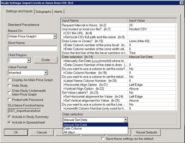

| @sstfrederik - Posts: 413 |
One thing you can try. Remove the SST_ImportLevelsfromCSV.dll and SST_ImportLevelsfromCSV_64.dll from your SC data folder and restart SC. Attached a pic of the location of the "All days setting" The lines that are drawn are SG's so you can use them with the cbboac study. First SG is the first line etc. Zones use two SG's first is top price, second SG is bottom price and so on. Another edit: If you do not import the labels and not set the alignment using the study inputs, you can also set Subgraph name and value label individually in the subgraph settings. Date Time Of Last Edit: 2018-06-08 13:10:51
| [2018-06-08 13:17:56] |
| LucentTrader - Posts: 42 |
I have removed the SST_ImportLevelsfromCSV.dll and SST_ImportLevelsfromCSV_64.dll from the SC data folder and restarted SC. The SST_ImportLevelsfromCSV_64.dll was not downloaded. I appreciate your assistance. I will process the payment for the study today as the csv import is of value to me. Thank you, Mark |

| [2018-06-08 13:31:51] |
No apologies necessary. Your support is stellar exceeding my expectations. The study works with "All Days" selection displayed. |
