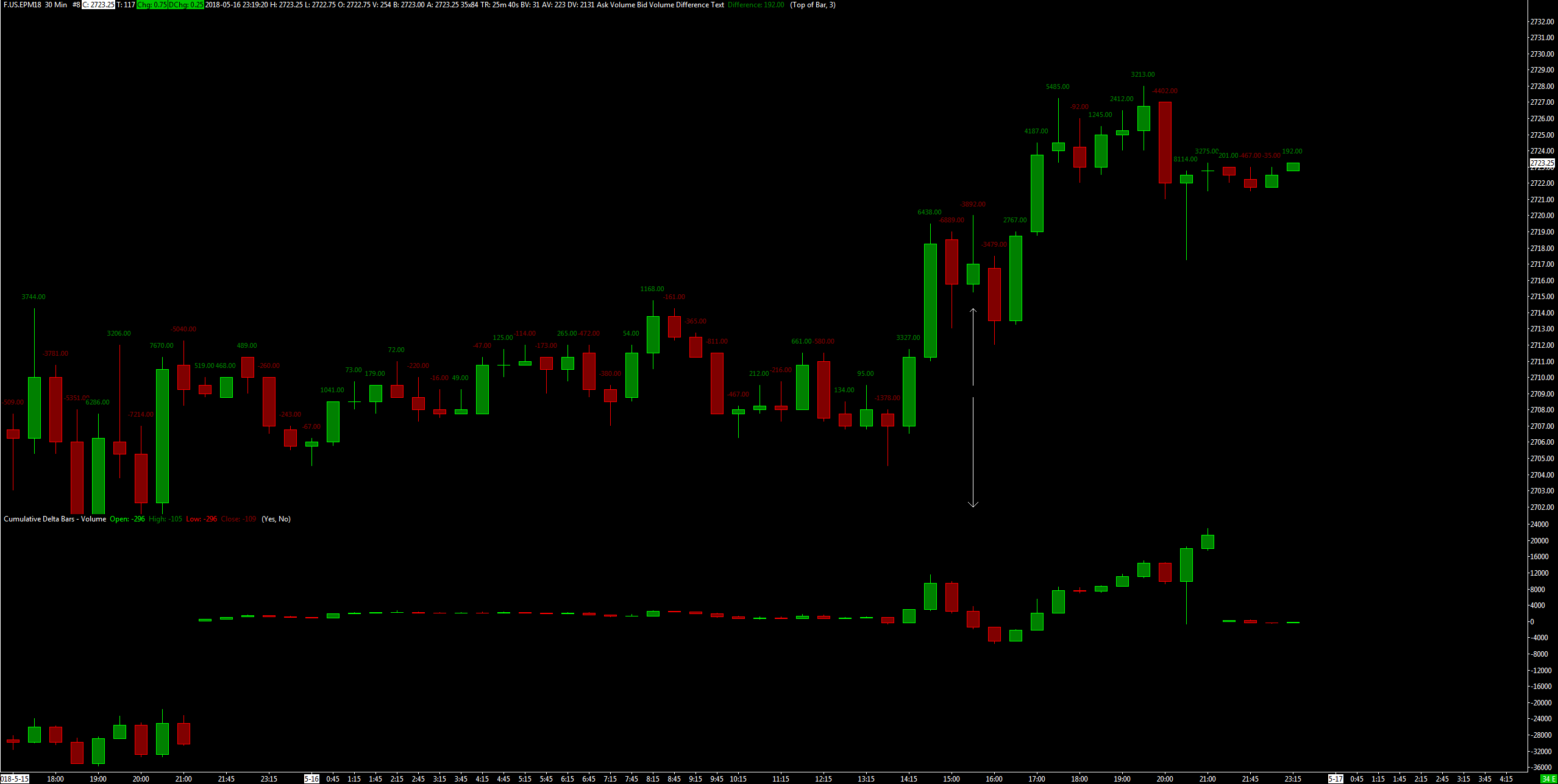

Is there a way the cumulative delta bars - Volume indicator can give an alert if the delta is positive but the price bar is negative and vice versa?
The link here is an example: http://www.sierrachart.com/image.php?Image=1526509174362.png
Thanks,
Cathal
[2018-05-17 15:54:09]
John - SC Support - Posts: 48438
Yes, you just have to reference the Close of both the study and the Main Price Graph. We have put together a Study Collection with this setup. You can find it here:
https://www.sierrachart.com/AdditionalFiles/CumDeltaVolAlert-BarCloseOpposites.StdyCollct
Note that if you add this study collection to a chart with existing studies, then you will need to rework the alert to reference the correct study IDs and subgraphs.
Also, in this case we used the Close values and enabled the option for Alert on Bar Close.
