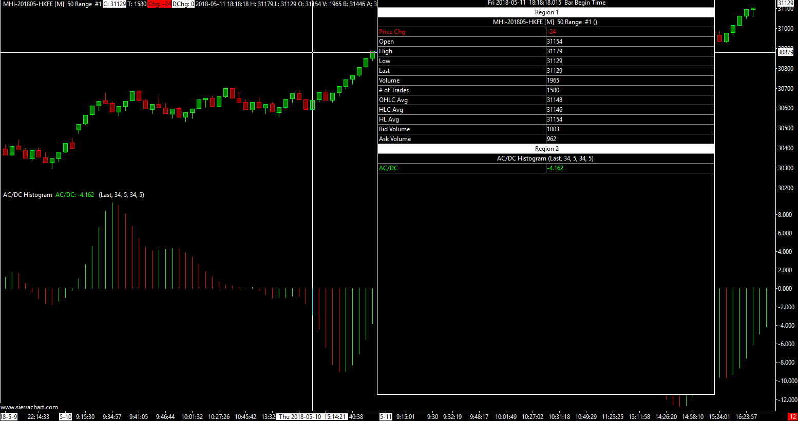

i'm trying to create c++ study with, for example, "AC/DC Histogram". Its output values, as seen in Chart Values window (uploaded screen), come with green or red in colors. How may i capture or identify this color code in cpp apart from its value?

With that particular study, the coloring is based on the slope using the Subgraph Auto colouring setting.
Therefore, you just need to look at the values and determine the slope.
