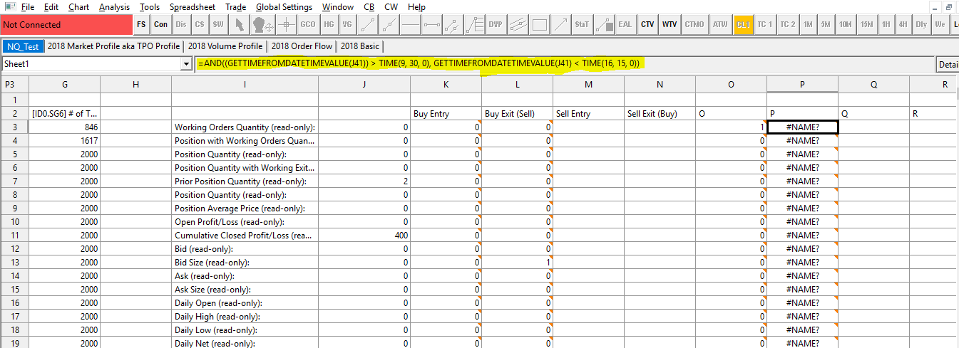

Hi, I want to test signals only on RTH in the spreadsheet for trading study. I copied your code at this link (Spreadsheet Systems, Alerts and Automated Trading: Limiting Trading to Certain Time Ranges) and dumped it in a open cell in the spreadsheet study (cell P). Please see 'Time Formula' attachment. The code is exactly the same as per link so why do I get a #NAME? error (I did look at the Spreadsheet errors section but in this instance I dont know what the issue is). Cell J41 is the relevant cell for date and time in my sheet.
Then I reference cell P in my 'Buy Entry' (K) column as can be seen in attachment 'Buy Entry'. However, when I run a backtest with the reference to GETTIMEFROMDATETIMEVALUE, I get no signals although after manual inspections, there are clear instances where signals should be given. When I remove the GETTIMEFROMDATETIMEVALUE reference from my 'Buy Entry' column I get my signals again.

The GETTIMEFROMDATETIMEVALUE function does not exist. Use the FRACTIME function instead.
https://www.sierrachart.com/index.php?page=doc/SpreadsheetFunctions.html#FRACTIME_Function
The formula is meant to go in J28.
Here are two more formula examples to disable autotrading using J28:
Spreadsheet Example Formulas and Usage: Disable Trading From Spreadsheet Study for Trading
[2018-05-05 21:26:38]
Yes this is correct. What happened, was the GETTIMEFROMDATETIMEVALUE function was intended to be added at the time the documentation was updated, and then it was later realized that FRACTIME is equivalent and it was not added and we forgot to correct the documentation.
