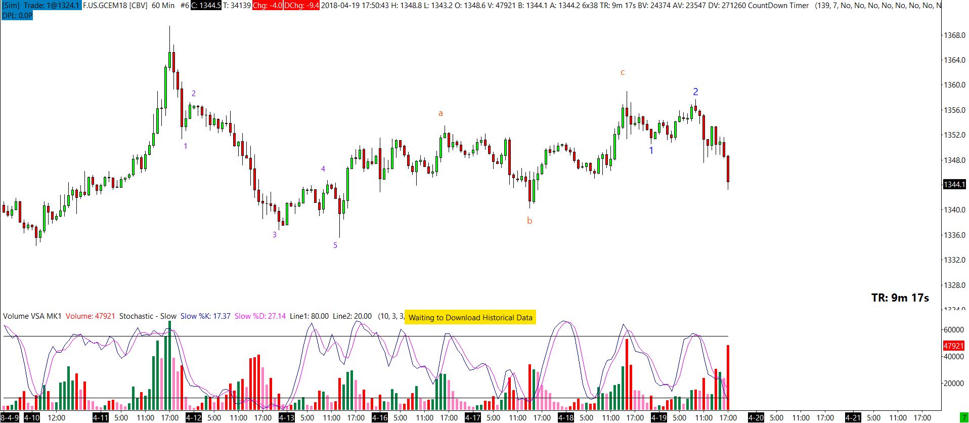

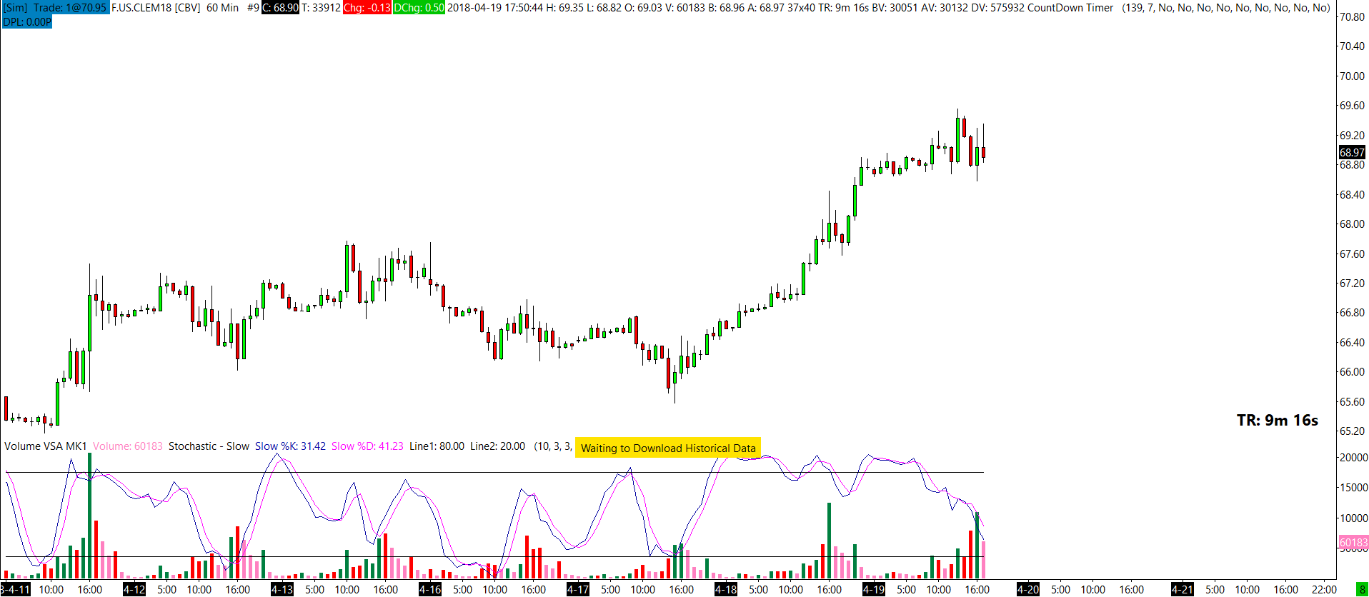

The program downloads data on different contracts every few / several minutes and during this process hangs for different periods of time, sometimes it is only a few seconds and sometimes a few minutes. I checked the settings on the other account on the same computer as this one and on the same fast internet and only here is the problem ...the problem exists when connecting the internet in different places
imageF.US.CLEM18 [CBV] 60 Min #9 2018-04-19 17_50_46.794.png / V - Attached On 2018-04-19 18:07:37 UTC - Size: 68.22 KB - 398 views
imageF.US.EU6M18 [CBV] 60 Min #3 2018-04-19 17_50_39.784.png / V - Attached On 2018-04-19 18:07:52 UTC - Size: 94.95 KB - 402 views
imageF.US.GCEM18 [CBV] 60 Min #6 2018-04-19 17_50_43.780.png / V - Attached On 2018-04-19 18:09:52 UTC - Size: 80.89 KB - 424 views
[2018-04-24 09:29:46]
This may be caused by a custom study you are using. Run Sierra Chart in Safe Mode:
Sierra Chart - Software Login Instructions: Using Safe Mode
Otherwise, refer to help topic 30:
Http://www.sierrachart.com/index.php?page=doc/helpdetails30.html
Most likely the problem is caused by a study. Remove the studies one by one from the charts to see which one is causing the issue.
