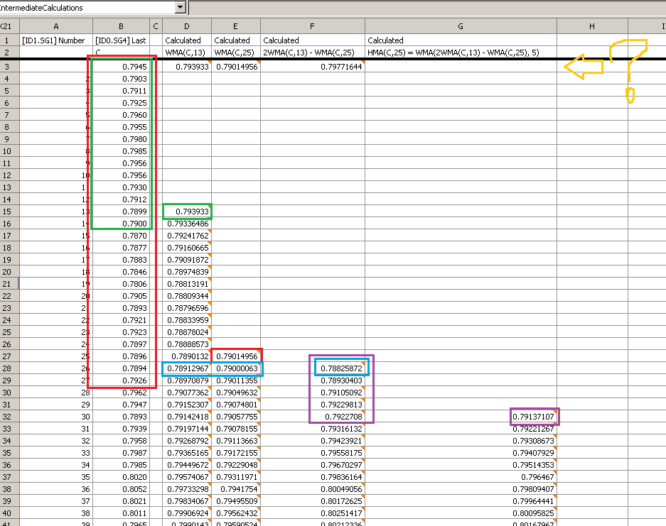

Thank you for the response. I have been looking at the Moving_Average_-_Hull.148.scss reference spreadsheet on how the HMA is calculated. I am trying to replicate these HMA calculations in to my own spreadsheet system to avoid the circle reference and I can't figure out how to calculate the data for Column G, Rows 3-29. I understand how the HMA is calculated in multiple steps but I don't understand how you would get results for Column G, ROWS 3-29 if the formula calculates the data this way. I attached a picture of the spreadsheet and how each column of calculations references data. It's not until ROW 30 that you get the HMA using a 25 period length. How are the results for Rows 3-29 being calculated in an HMA study that I'm adding to my chart?

We did not look at this comprehensively but one thing about the spreadsheet which shows the formulas is that the rows are ascending in time and not descending as compared to when using the Spreadsheet study.
Aside from that we are going to add the HULLMOVINGAVERAGE and the WEIGHTEDMOVINGAVERAGE functions to the spreadsheet component.
Date Time Of Last Edit: 2018-04-20 19:02:54
