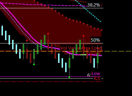

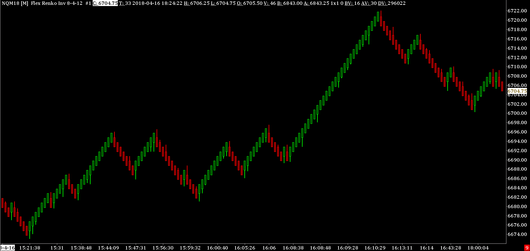

I have been having an issue with odd-shaped candles on my charts (below screenshots). As these are flex renko bars, there should be no wicks in both directions. Can you please advise what may cause this problem?
imageweird_candles.png / V - Attached On 2018-04-16 06:42:37 UTC - Size: 8.74 KB - 513 views
imageweird_candles_2.png / V - Attached On 2018-04-16 06:42:48 UTC - Size: 8.32 KB - 493 views

as a good example you can look at 2018/04/16 at 16:13 - a huge tail

Unfortunately, with the data we are using from the Sierra Chart Exchange Data Feed we are not seeing that:
http://www.sierrachart.com/image.php?Image=152408341557.png
This is from your Chartbook. The timezone is US Eastern.
We can see the problem in your chart image, but we cannot reproduce and it is hard for us to resolve without being able to to reproduce it.
We see you are using Rithmic but there really should not be any problem with the Rithmic data. But in any case a data issue should not cause this. We definitively want to resolve this. Just not sure how we can reproduce though.

We actually do see how in this particular case the 1 second data is causing that particular appearance where there is a reversal. This is because Sierra Chart will maintain the true open, high, low, close values for the bars rather than manipulating them.
