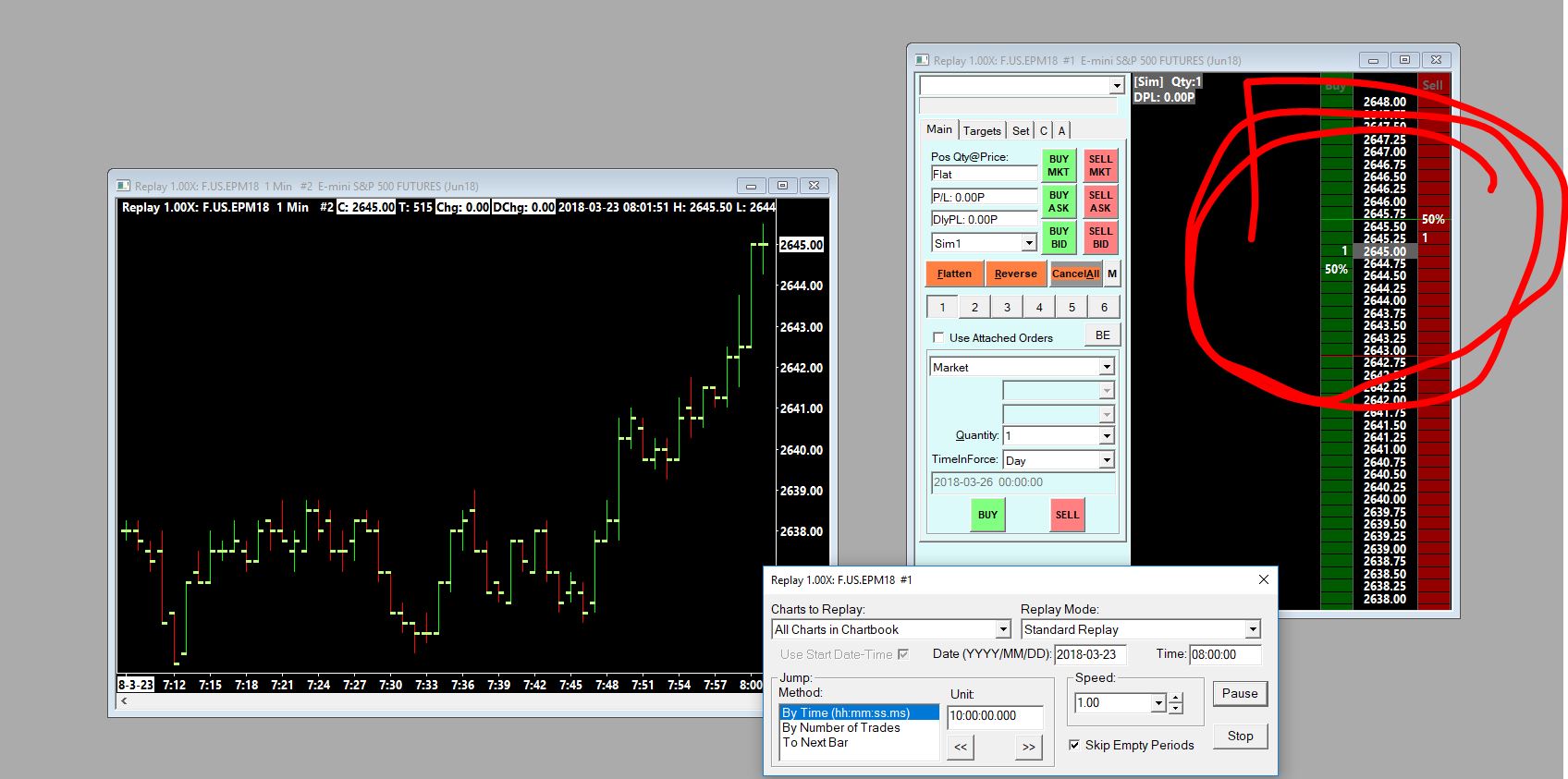

User884307 - Posts: 173
Hi
Just updates to 1723 and still same problem with replay and tradeDOM.
The screenshot demonstrates whats happening.
The Bid / Offer "1"s at the top do not move and you can see the current simulated price at the bottom with the black box. Also in live market going to sim it does not clear the market depth when going into replay mode.
http://www.sierrachart.com/image.php?Image=1521887142301.png
As of writing this version 1717 is last version to work correctly. It even uses the market depth data in the ladder if set to save.
I hope this explains things better
Cheers

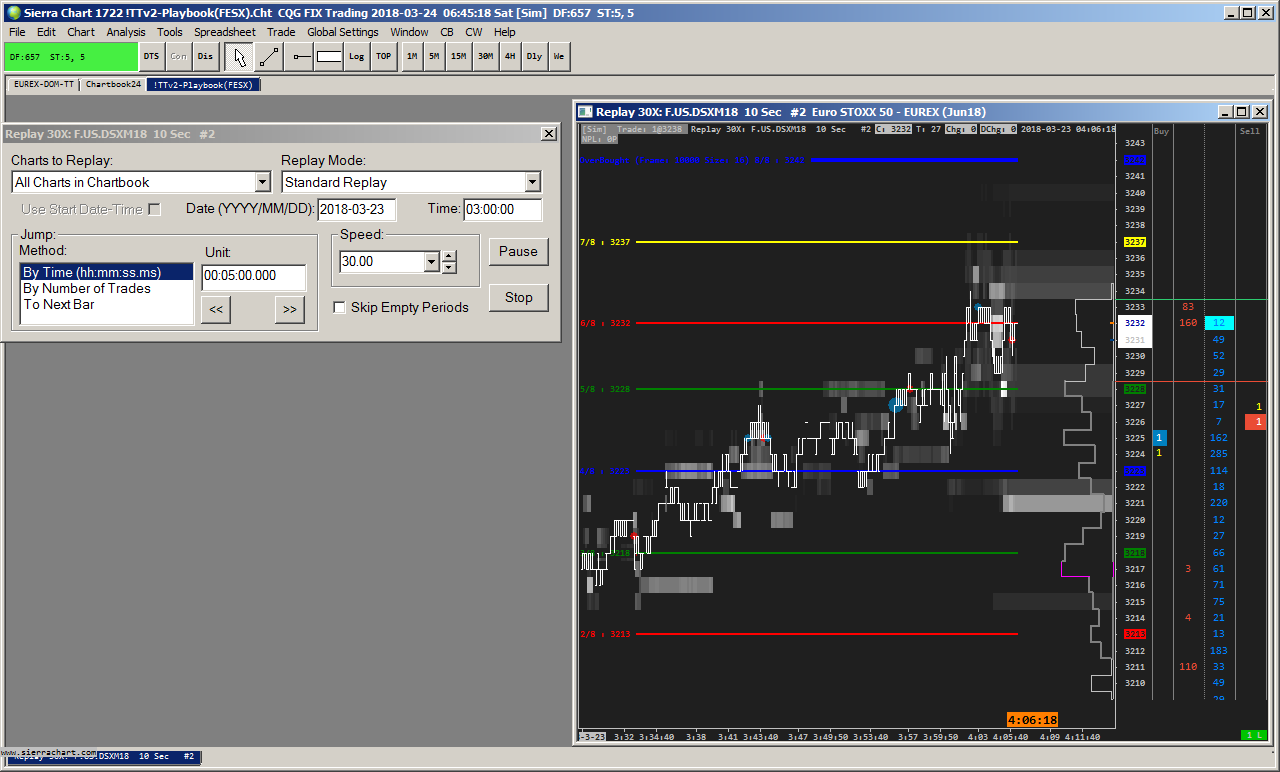

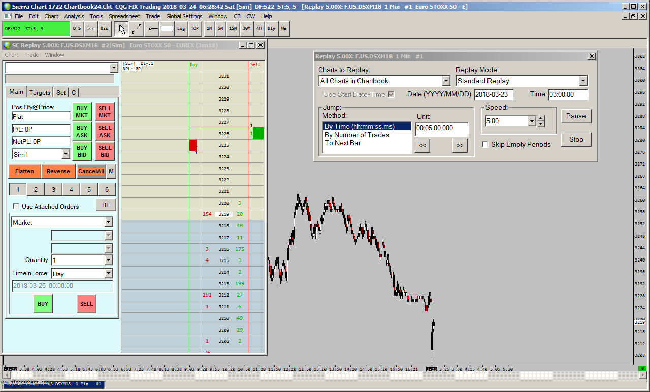

ticinotrader - Posts: 431
Dear Support,
I am experiencing the same issues when replaying in v1722. I'm trying to do replay 100% similar to the way what I always used and worked perfectly. The issues are the following:
Market Depth (bid/ask levels) is not shown at all
Bid/Ask shows 1 and stays at the same place and does not follow the price as it moves up/down
Please see two images for examples:
http://www.sierrachart.com/image.php?Image=1521887324715.png
http://www.sierrachart.com/image.php?Image=1521888320721.png
The first shows a freshly created chartbook with a single 1min chart and a DOM.
The second clearly shows that although the Bid/Ask levels on the DOM are not shown, the Market Depth data used for the replay is correct/exists because the Market Depth Historical Graphs are shown correctly.
Can you please advise?

There were 3 market depth related issues that occurred during a chart replay due to the significant internal changes relating to market depth data.
This is not itself a problem chart replay but instead related to market depth data during a replay. We are releasing 1725 now. The basic functioning of chart replay was always fine.
We do need to work on a problem though where when pausing a replay and resuming, the market depth data is reset and it takes a moment to rebuild. Not sure why we did it that way, there was a reason but we still need to look into this.

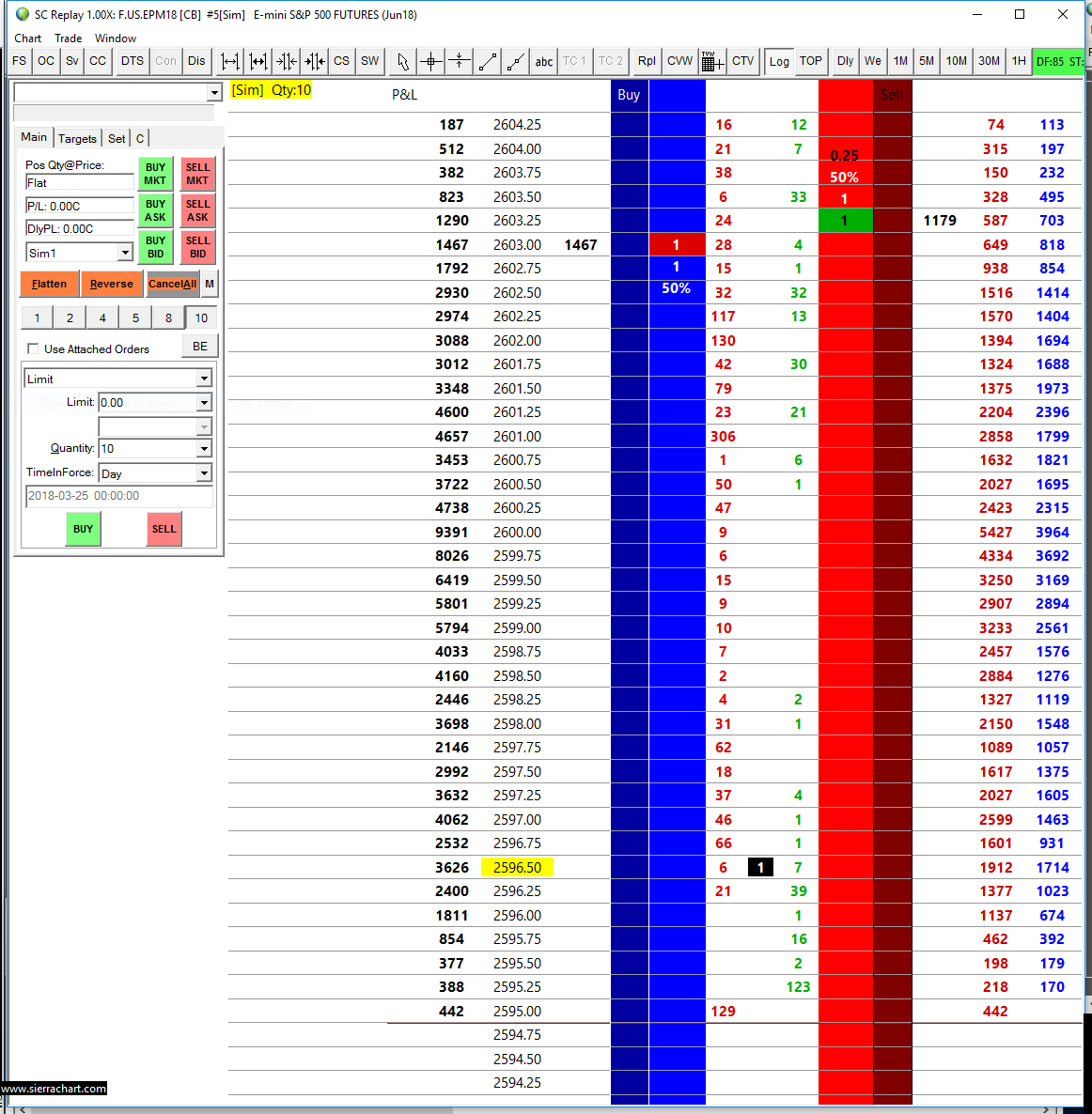

User7817001 - Posts: 96
morning, having similar issue with '1' showing in DOM, even after using 1725
see attached

[2018-03-26 05:13:35]
see attached
This is normal if there is not market depth data for the time period being replayed. Refer to:
Replaying Charts: Replaying of Market Depth Data
Date Time Of Last Edit: 2018-03-26 05:13:48
[2018-03-26 11:50:33]
It also works for me, after I enabled local storage of the data, thanks folks.
