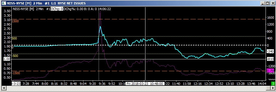

Good afternoon,
The attached picture will help understand my question.
I have a left side scale and a right side scale. When I use my crosshair, the value on the right side scale is correct, but the one on the left is not (it goes by 1.00 increment).
If you look at the picture, with the left side scale, my crosshair is between 1.10 and 1.50, but the "highlighted value" given with the crosshair is 1.00.
Is there a way to have an accurate value on the left side scale?
Thank you,
image18-03-23, Fri, 14-06-35.JPG / V - Attached On 2018-03-23 18:07:44 UTC - Size: 203.47 KB - 520 views

[2018-03-27 00:26:31]
This is because the left side scale is being rounded to the tick size of the chart. We will remove that from the left side scale.
