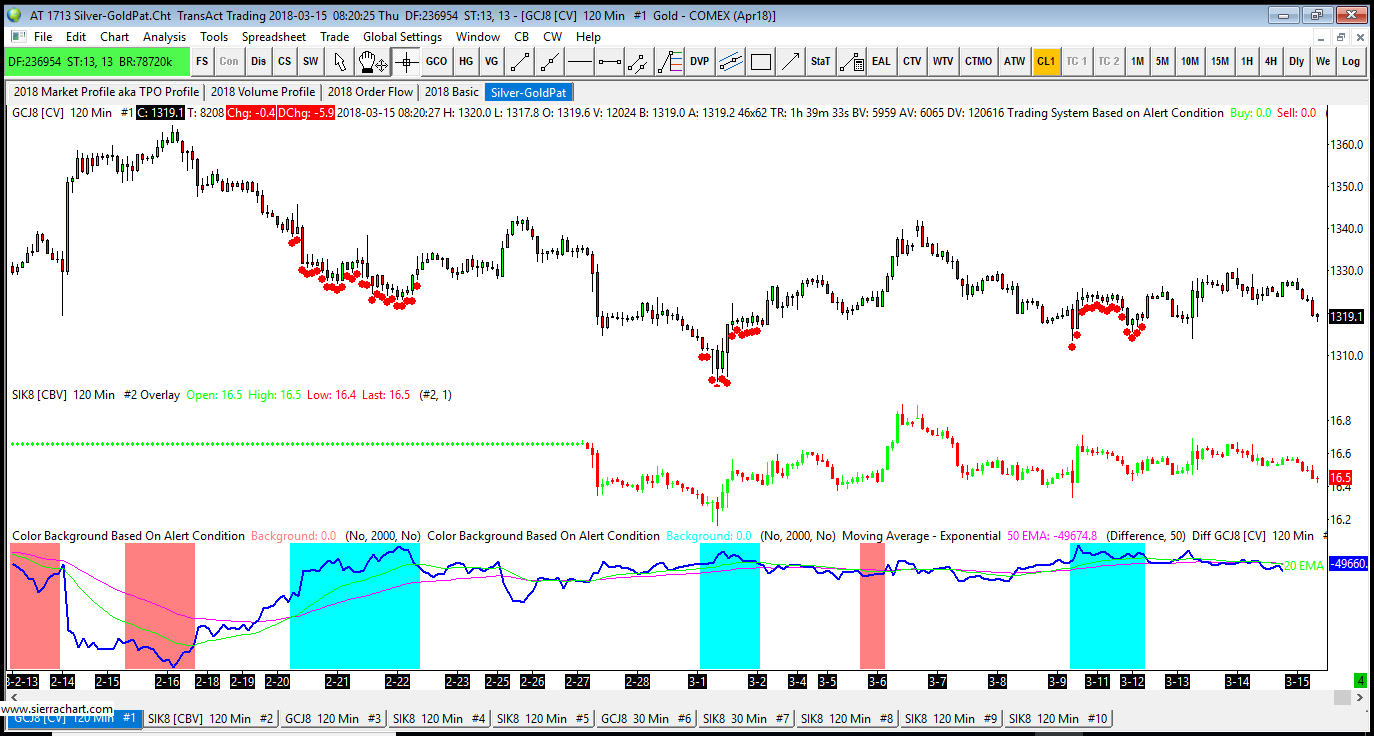

For some reason the overlay chart in the middle cuts off 2/27, was wondering why and how to maybe correct it. Looks like it is calculating the spread(difference) correctly on the bottom.

The most likely reason is simply that the the chart that is being overlaid (Chart #2) does not have data prior to 2/27. Refer to the following for changing how much data is loaded for a chart:
https://www.sierrachart.com/index.php?page=doc/ChartSettings.html#DaysToLoad
If there is missing data, then follow the instructions here:
Date Time Of Last Edit: 2018-03-15 18:39:53
