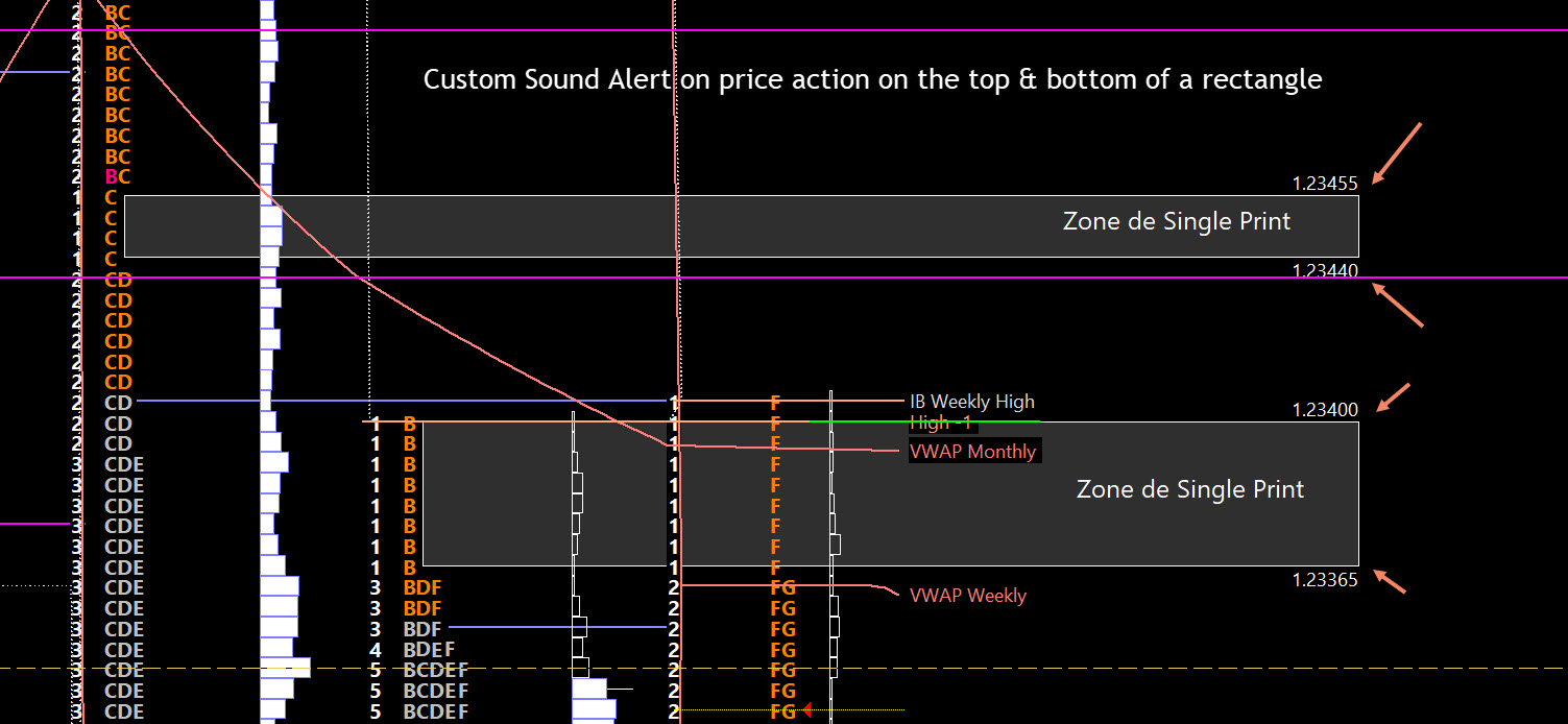

Hello Support,
is it possible to define a custom sound alert both for the top and the bottom of a rectangle box ?
In the case illustrated by the image attached, it is to trigger an alert when a single print area is touched by the price action.
It would be nice to include this feature directly inside the rectangle avoiding to make another horizontal line for both side of the box !
Thanks for your feedback.

[2018-03-14 20:40:30]
John - SC Support - Posts: 48483
If you are wanting to use the Last Price to check with the rectangle, then you can create an alert on the drawing for when the price crosses the rectangle. You can find the information for how to set this up here:
Chart Drawing Tools: Chart Drawing Alerts
It is also possible to create a Simple Alert through the Chart Settings which references the Chart Drawing. This alert will be based on whether the price or a Study Subgraph have crossed from above or below the rectangle. This is done by referencing the Anchor Points for the rectangle. An example of how to do this for a Study Subgraph is #39 on this page:
Study/Chart Alerts And Scanning: Alert Formula Examples
The general documentation for how to reference the study anchor points in Simple Alerts, can be found here:
Study/Chart Alerts And Scanning: Referencing Chart Drawings
Date Time Of Last Edit: 2018-03-15 19:41:01
