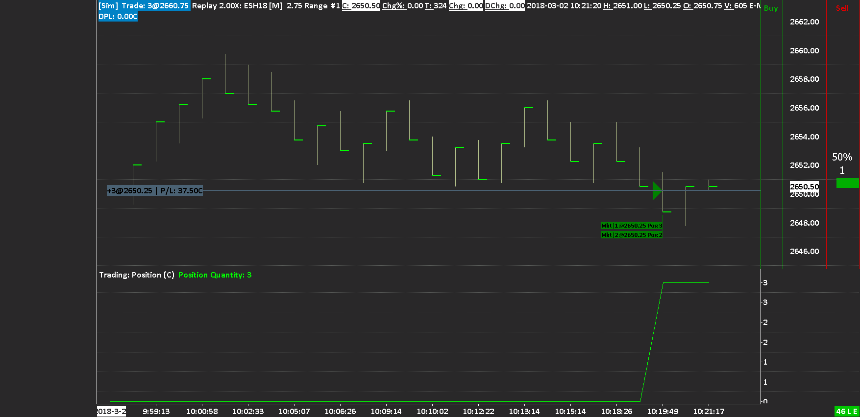

I had a (rare) instance where the replay of a trading system showed a trade in the Trading Activity Log (and drew an arrow on the chart) but the Trading:Position Quantity did not register the trade on that bar, until i Recalculate All Cells manually a bar or two later.
Is it possible the trade happened so close the the bar close that the Replay system didn't have time to 'finish' accounting for the trade properly in Trading:Position Quantity?

User48838 - Posts: 134
Dear Support,
It is definitely reproducible. How would you like me to demonstrate the action? It happens at 10:19.49 EST on my replay of last Friday's chart of an ESH8 2.75 Range chart at 2650.50 Limit, I start the chart at 9:30.
The issue occurs with Replay at 10:19.490 eastern time on Friday March 2, 2018
TY

[2018-03-06 09:18:41]
Unable to reproduce when submitting an order near the end of that bar.
We saw the position immediately from the study:
http://www.sierrachart.com/image.php?Image=1520327870182.png
There must be some other explanation for what you are seeing.
[2018-03-07 14:41:56]
We are now able to reproduce this and we are looking into it. At first we did not run the test exactly as you had described in post #4. We think this is just a small millisecond comparison issue.
Date Time Of Last Edit: 2018-03-07 14:47:04
[2018-03-07 15:05:22]
i tend to agree with you, thank you for reconsidering.
[2018-03-07 15:15:53]
Yes this is all it was. A small millisecond comparison issue. Problem now resolved.
