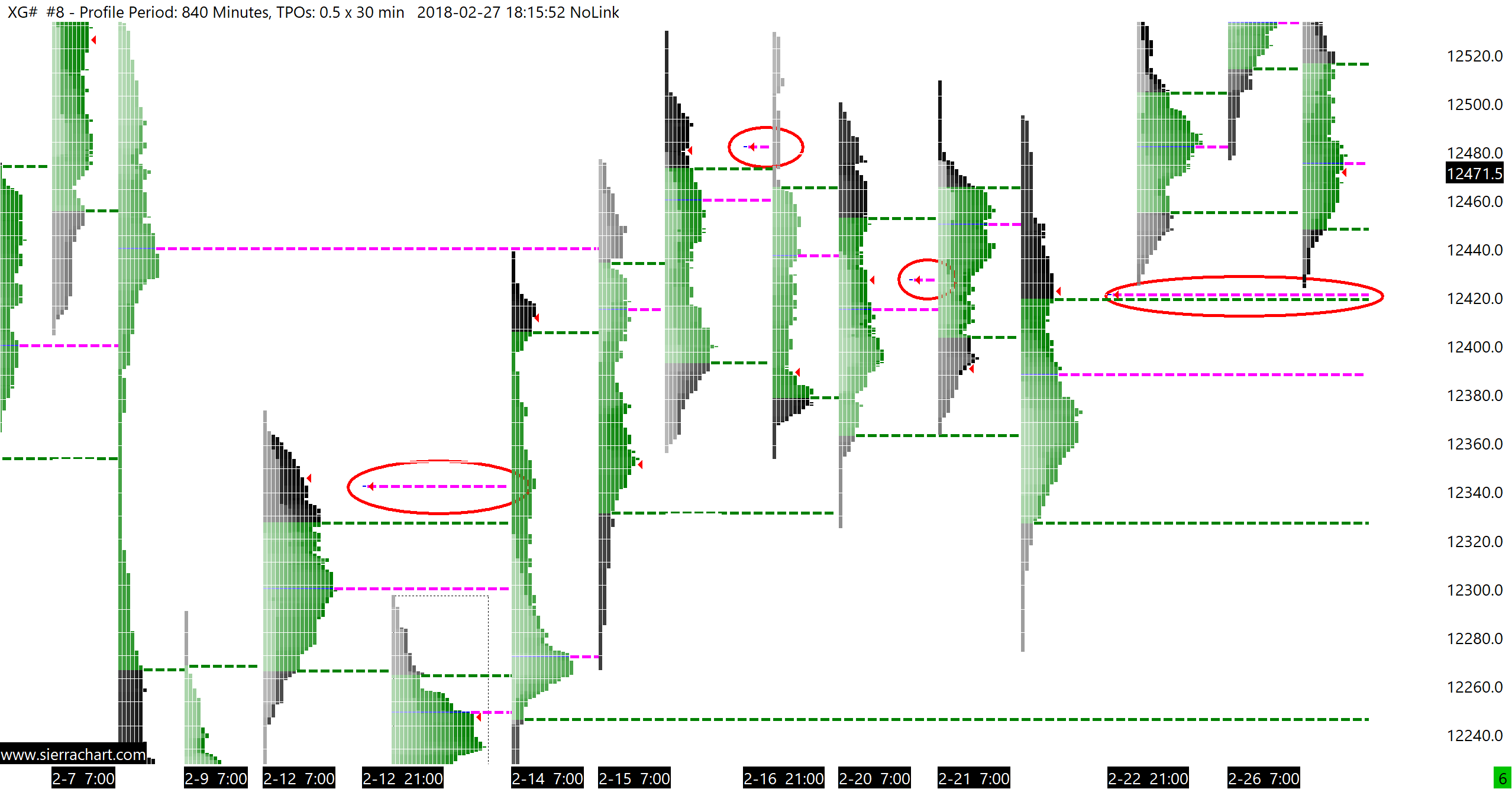

In the uploaded image of a TPO chart, I have highlighted with red elipses unwanted lines (with an arrow at the leftmost edge) that appear to be related to the closing price of the day, carried forward until intersection (though not on all days due to an offset?)

I have tried various methods of deleting these lines, thus far without success. In a similar vein, I am having trouble changing the properties of other markers.
Perhaps they are related to a "default" setup overriding chart settings. If you suspect this, where might this be accessed?

Please note that the unwanted lines (but not the also unwanted small red triangles associated with them) can be toggled on and off using the "Extend Value Area" function (none / until future intersection). But of course this also toggles off the valid Value Area lines.

OK so yes those lines are the Value Area lines. So what is the question if you know how to remove them or change where they are extended to?
The red triangle cannot be removed because that indicates the last trade price.
[2018-02-28 22:33:46]
Another thing we notice is that you have the Profile Time Period set to 840 minutes rather than 1 Day. We recommend using 1 Day so that you do not have that very small separate TPO profile.

This latter comment has resolved the issue to my satisfaction.
