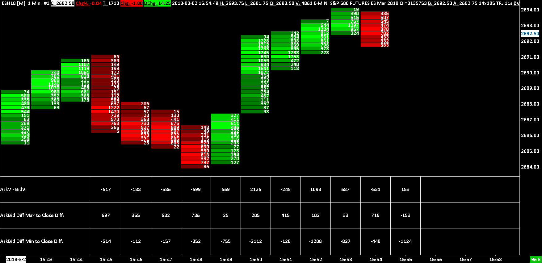

[2018-03-02 13:21:51]
User884307 - Posts: 173
..... just an update, in numbers bars calculated values with pullback column enabled...
high/low pullback ask/bid vol Diff is not calculating either, just displaying zeros
[2018-03-02 20:55:57]
At times those values are going to be the same. That is not unusual. Here's an example of where they are different:
http://www.sierrachart.com/image.php?Image=1520024090178.png
The calculations are verified to be correct.
