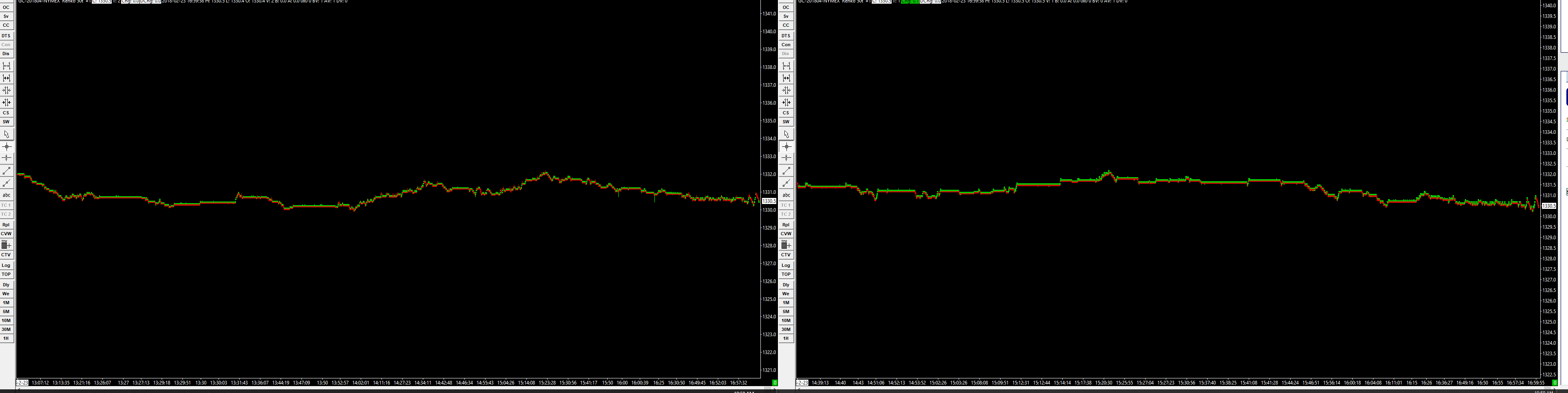

doctor10 - Posts: 88
Time signatures are wonky resulting in long renkos to make up gaps.
Similar issue came up around version 1650.
I have attached an image.
Thanks,
image2018-02-25 (6).png / V - Attached On 2018-02-25 15:58:16 UTC - Size: 85.44 KB - 395 views
When reducing the ticks per bar on a renko chart, time isn't being converted correctly. This results in gaps of time being dropped from the chart. As a result of that, large bars are drawn to make up the difference between where time started to be distorted and stopped.
A similar issue popped up around version 1650.
The reason I uploaded that photo was to show a side by side comparison between a pre-v1700 and post v1700. Not going to do that individually because I already arranged this photo for you to look at.

We still do not understand this at all. Data is never going to be dropped from the chart when you change the Renko settings. That is just simply an impossibility. We just have to let this go because we are not understanding it.
However, one thing we can tell in the chart image you gave and this is somewhat hard because we cannot see the top line completely, is that it looks as though the tick size of the chart is set wrong. For GC futures it should be set to .1. Refer to:
Chart Settings: Tick Size (Chart >> Chart Settings >> Symbol >> Symbol Settings menu)
So that is the first thing to do is to get the Tick Size and Value Format correct.
And then also reset the scale with Chart >> Reset Scales.

[2018-02-26 21:44:10]
BOTH OF THOSE FRAMES ARE RUNNING THE SAME TICKS PER BAR. THE ONE WITH DISTORTIONS IN TIME AND PRICE IS POST 1700. THE ONE WITHOUT DISTORTIONS IN TIME AND PRICE IS PRE 1700.

What do you have the Tick Size of the chart set to?
And why would you make a lower than .1? This does not make any sense.
And if you do, Renko bars will require that the Price Display Format also be set to correspond with the tick size. So you probably at least will want to make that .01.

You also did not tell us what the Tick Size is set to and if the Price Display Format is not set to correspond with it then the result you are going to get is not likely to be as intended.
We cannot provide further help. Due to the new implementation of Renko bars, the result you are getting from the settings you are using, are likely not to be what you expect.
You need to continue to use older versions of Sierra Chart.

So you are telling me sierra chart has inexplicably changed?
In GC's case I have been running .001 tick size on .1 price display. THIS HAS BEEN FINE FOR YEARS. No bar size or time distortions.
Seems like you are more concerned about who I think is answering these questions then finding out technically what has changed so that you can fix it.
Telling me that this new found distortion post-1700 is a result of my settings is just not true at is actually just insulting at this point since I am trying to bring your attention to something.
Use v1689 and open GC intraday with 5 days. Set renko to 50, tick size to .001, and price display format .1 then apply.
Do the exact same thing in v1700 and on and see what happens.
Look at the difference and figure out what is going on.
***** YOU WILL ALSO NEED INTRADAY STORAGE TIME UNIT TO BE SET TO 1 TICK ******
Another difference I noticed between pre1700 and post is in Data/trade settings
Instance client ID has to have a visible value now. As in before it could be blank.
IB stop order trigger method has to have a value now. As in before it could be left blank.
Also in the Intraday Data Editor you can see that the values are being stored differently post 1700 at Renko setting=50, Tick size= .001, and price display format=.1.
As in I can find the same data bar to bar at Renko setting=50, Tick size= .001, and price display format=.1. on any two versions before 1700 but post 1700 the data is different.
These are the only other differences I have picked up.
Date Time Of Last Edit: 2018-02-27 20:48:30
Renko bars have a new much improved implementation and require the Price Display Format when comparing values. So if the tick size is .001, that extra precision is not used when you set the Price Display Format to .1. This is something we cannot change.
This makes no sense. There cannot be any problem with this. Also it is not unusual to see the same data record to record. Trades very well can have the same price and volume.
We really cannot help you here. And are prepared to offer you a refund if you are this terribly unhappy. You need to decide if you want to continue to use Sierra Chart.

[2018-02-28 18:00:35]
Refer to our response above.
And once again just adjust the Price Display Format to .001. This should be all that you need to do if you want to use the tick size of .001.
