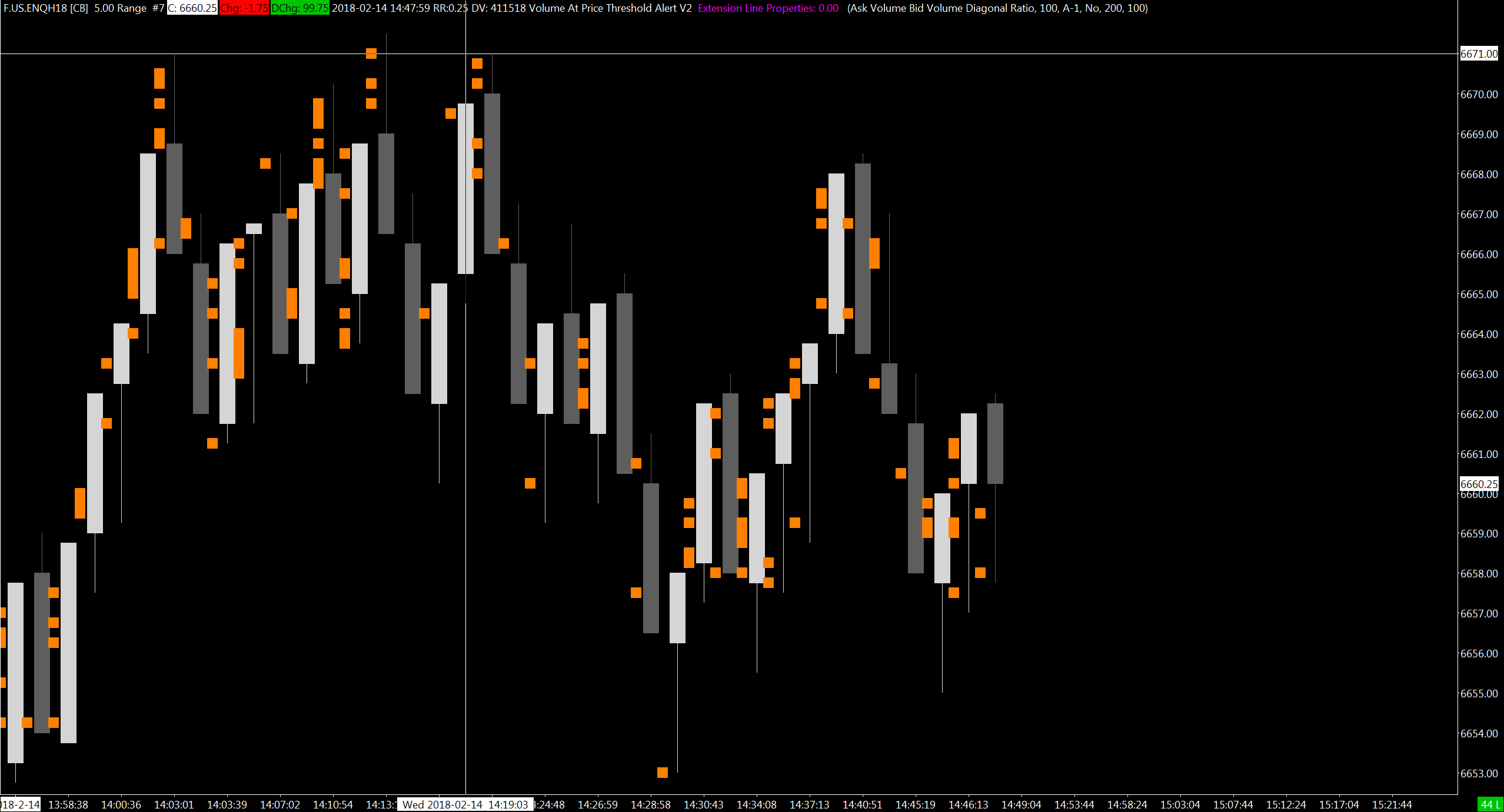

[2018-02-14 19:50:18]
RonW - Posts: 105
http://www.sierrachart.com/image.php?Image=1518637681569.png
Volume At Price Threshold Alert V2 Extension Line Properties 0.00 (Ask Volume Bid Volume Diagonal Ratio, 100, A-1, No, 200, 100)

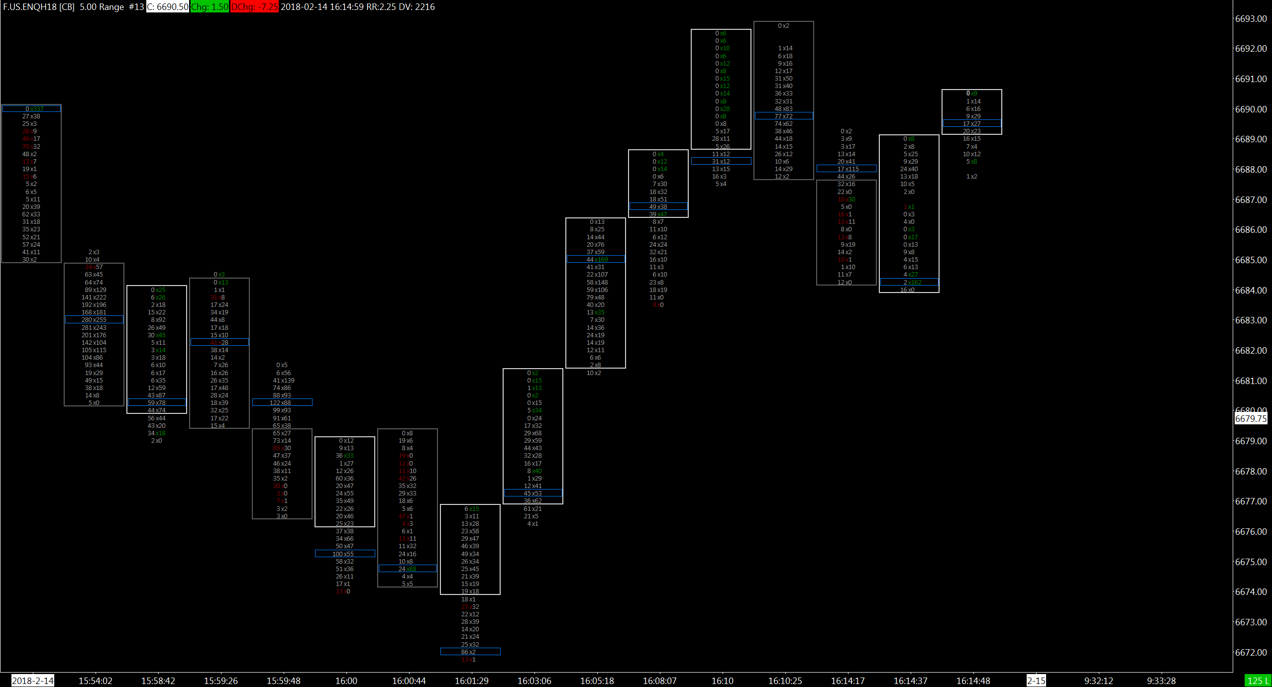

[2018-02-15 00:25:20]
RonW - Posts: 105
http://www.sierrachart.com/image.php?Image=1518653272309.png
Here's my Numbers Bars chart. Interestingly, my Enable Diagonal Zero Bid/Ask compares is set to no. Text coloring method is "Based on Diagonal Dominant Side AskVol BidVol Percentage." When it is zero on the bid and 6 on the diagonal ask, the ask is colored green, which I want.
In the Volume at Price Threshold Alert V2 0 bid by diagonal 6 offer does not get a marker. I would like it to get one, the same way 1 bid by diagonal 6 offer gets a marker.
