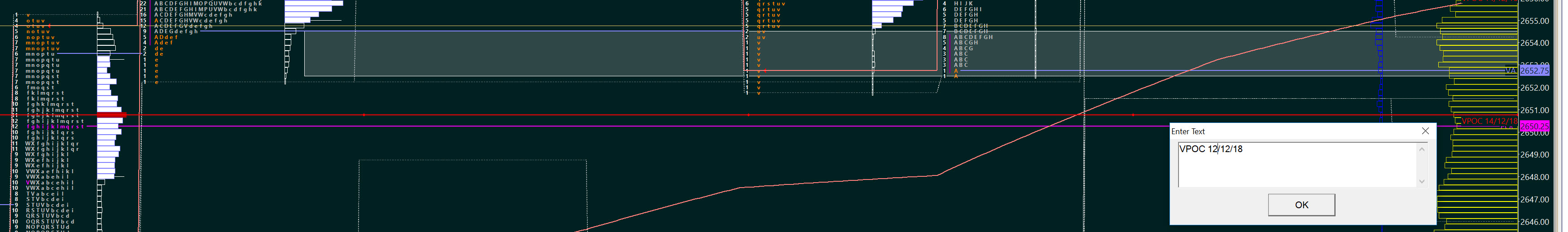

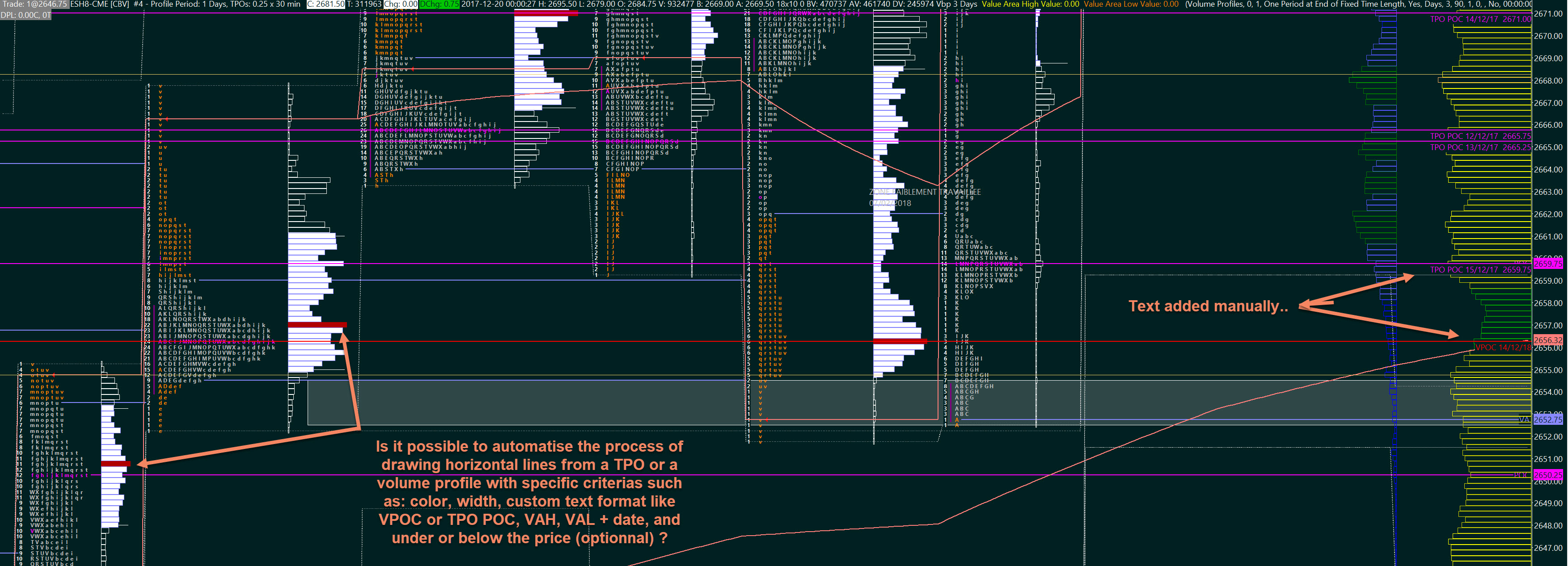

every day, I do place manually horizontal lines with specific information such as, VPOC, TPO POC with the date and the session (Europeano or US or Asian)
Please see attached file.
I do spend quite a bit of time to do that for each asset.
Is it possible to automatise the process of drawing horizontal lines from a TPO or a volume profile with specific criterias such as:
color, width, custom text format like VPOC or TPO POC, VAH, VAL + date, and under or below the price (optionnal) ?
I know that it is possible to have the TPO POC drawn with a line, but there is not the date, a title or the price of it directly below or above the line. More clarity is always an edge.

extend TPO poc:
Time Price Opportunity (TPO) Profile Charts: Extend TPO Point of Control
extend VPOC:
Volume By Price Study: Extend Point of Control
the only thing not supported is adding the date above or below the extended line - which would be amazing i agree :)
[2018-02-09 17:25:31]
John - SC Support - Posts: 48483
In addition to what whats1thingnow points out, is that you can control the line style, width, color, naming of the lines and price. You adjust these parameters using the Subgraph Inputs on the Subgraph tab of the TPO study. You can find the documentation for this here:
Time Price Opportunity (TPO) Profile Charts: TPO Chart Color and Width Settings
With respect to saving a Study to be applied to another chart, you can use the Study Collections option for this. The documentation for this is found here:
Study Collections
