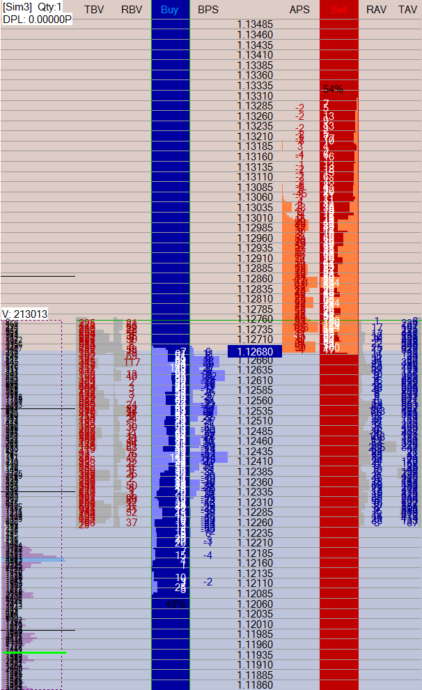

Andersenqwer1 - Posts: 4
Hello SC Support!
1. In regard to post #1 about "Maximum Depth Levels Displayed = 10" I can't find this option now. Has it been deleted?
https://i.ibb.co/MkJ1TG5/6-3-2019-10-14-23-PM.png
2. I have a question about recording Market Depth Data: will it still be recording if I do replaying of my single chartbook (with all 4 charts replying in it)? Or do I need to keep a separate chart/ chartbook with recording options on when I do replaying of my main chartbook to keep recording the data?
3. Rithmic Demo has 102 ticks Bids and Asks.
https://i.ibb.co/C2x6chj/6-3-2019-10-25-12-PM.png
http://www.sierrachart.com/image.php?Image=155959067491.png
They all recorded just fine. But as far as I can understand from your post #4 CME provides only 10 levels of Depth Data. Where do the other 92 levels come from? Can I trust/consider them as a sourse of reliable information?

1. The option referred to in the first post has been moved. You will find the option to limit the display of the Market Depth data in this option: Chart >> Chart Settings >> Advanced Settings 3 >> Maximum Market Depth Levels. Refer to the documentation for this here:
https://www.sierrachart.com/index.php?page=doc/ChartSettings.html#top
2. As long as the chart for the symbol is open and you have specified in the Symbol Settings to store the Market Depth Data, then it will collect and store the data. It does not matter if the chart is running in Replay mode, it is still getting the data.
3. As noted in post #4, there is additional levels available from the CME, but it requires implementing a different data stream. Since Rithmic has additional depth levels, then they have simply implemented this and it should be accurate. We have also implemented this in our data feed, so you can now get 200 levels of depth with the major symbols when using the Sierra Chart Real-Time Exchange Data Feed. Refer to the following post about the additional levels in the Sierra Chart Real-Time Exchange Data Feed:
