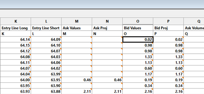

More specifically when I'm using the replay function and rewind say a minute or two, my spreadsheets do not refresh. I have to do it manually. I've attached a screenshot of what it looks like. The cells in columns M and N are blank and I have to click on 'recalculate all formulas' to refresh it. It affects everything including buy, sell, exit, and management. Please advise as far as what needs to be done to prevent this from happening.

[2018-01-18 19:59:24]
This clearly is a study calculation order/dependency problem. Refer to:
Chart Studies: Study Calculation Precedence And Related Issues
