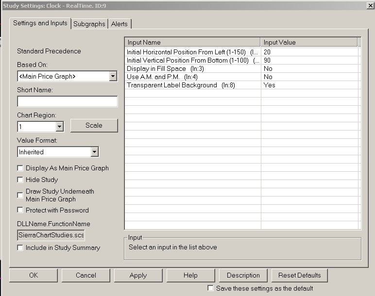

DevTrader79 - Posts: 48
Didn't work. Any idea ?
Screenshot included
imageReplayTimeProblem.jpg / V - Attached On 2018-01-10 15:32:11 UTC - Size: 490.8 KB - 464 views
[2018-01-10 19:16:51]
We do not see a problem with this. The Clock-RealTime study matches exactly the current time being replayed. What is the exact name of the clock study that you added to the chart?

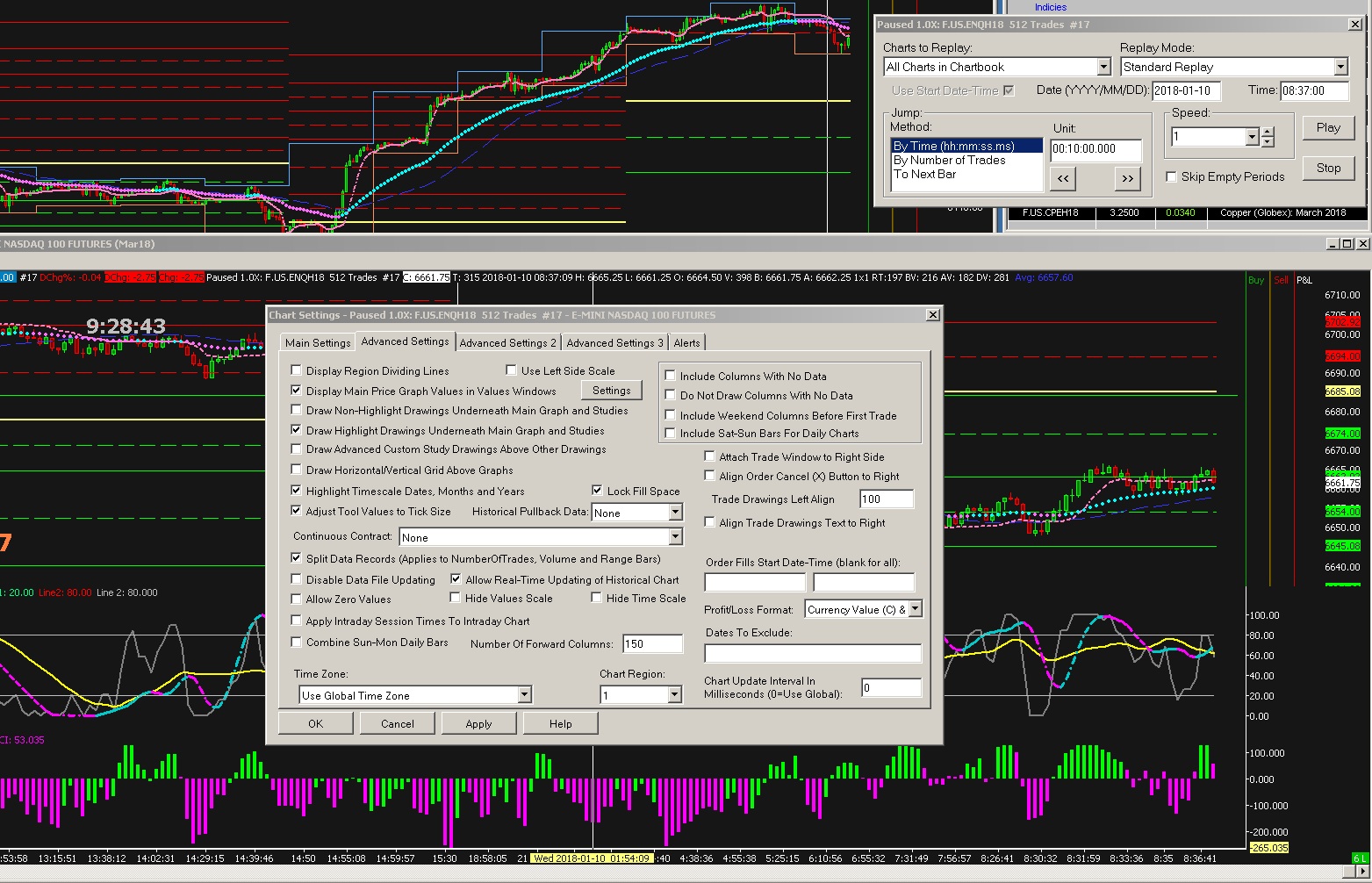

[2018-01-11 14:14:00]
Clock-RealTime
imageRealTimeClock.jpg / V - Attached On 2018-01-11 14:12:54 UTC - Size: 119.56 KB - 449 views
[2018-01-11 17:54:14]
This is not making any sense. As long as you are on the current version of Sierra Chart, tell us the version, then the Clock-Realtime study will during a replay indicate the last time of the last bar in the chart. This is totally reliable.
This has been verified.
[2018-01-11 18:31:03]
There is another thought about this which can be the source of the problem. Make sure you are on the latest release:
And go to Tools >> Manage Chart Drawings Window. Remove any text drawings which seem to be related to the real-time clock.
