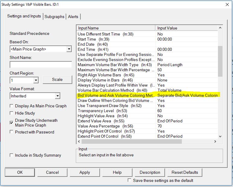

-Easy way to export the settings of a study to a txt file. An export/import button to easily send settings to others or back them up. If there is something similar to this already I am not aware of it.
-The option to expand the size of the Study Settings window. It's basically impossible to see the settings full names and the values with the size of the window and for some reason, this can't be maximized or made larger.

1. Use Study Collections:
http://www.sierrachart.com/index.php?page=doc/StudyCollections.html
There is also this feature to send Chartbooks and Study Collections to another user:
File Sharing
2.
There should not be a problem with this. We need to see a screenshot of what you are seeing.
Here are the instructions to attach that:
Date Time Of Last Edit: 2018-01-08 02:22:42
[2018-01-08 02:31:11]
lex0429 - Posts: 12
Thanks very much!
Attached is a screenshot of what I am talking about. Volume Profile study has a bunch of settings where the input name and input value are long that it's impossible to see the full text of each with the static window size.
Appreciate the quick, accurate response, as always.
imageSC.JPG / V - Attached On 2018-01-08 02:31:04 UTC - Size: 116.85 KB - 528 views
[2018-01-08 03:09:14]
You can see the text fully by dragging the divider line between Input Name and Input Value at the header of that list of Inputs, to make the left side wider.
And then when you select a particular Input, the actual input values can be fully seen in the control below.
We will make sure the documentation explains his.
Date Time Of Last Edit: 2018-01-08 03:09:24
[2018-01-08 03:18:28]
lex0429 - Posts: 12
I am aware of that but what I was talking about was the ability to resize the window so you could see the input name and value without having to move that divider to see one or the other in cases where the text is long.
