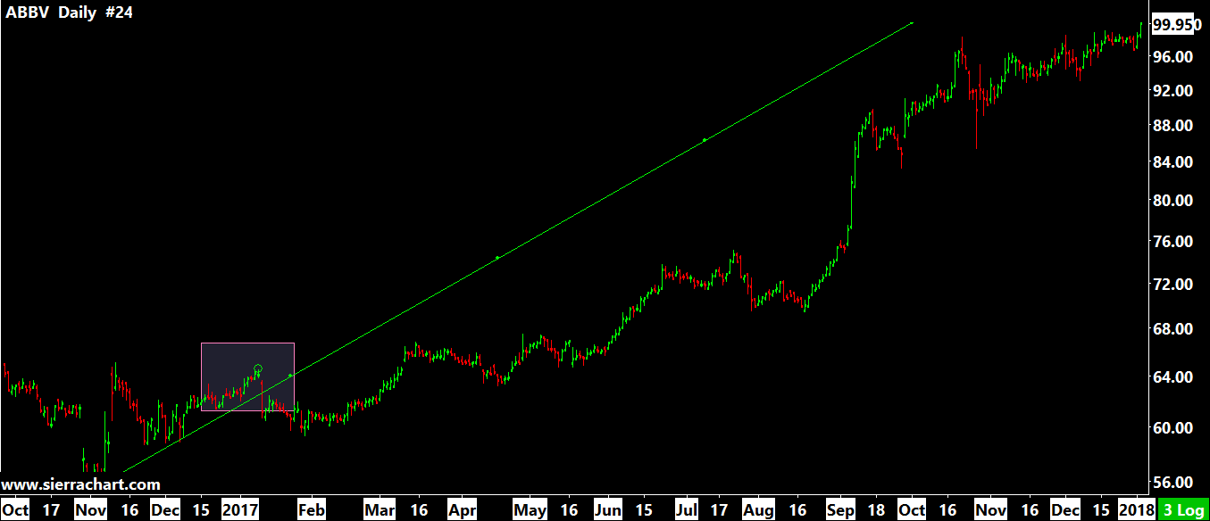

When using a log scale, the Ray and Parallel Ray tools do not draw correctly. The anchors are set properly, but the lines are drawn incorrectly. Also, you can not select the ray by clicking on it, but instead need to click where the drawn ray would be.
The following is an example with the ray selected, and the anchor/ray difference highlighted:
http://www.sierrachart.com/image.php?Image=151507769721.png

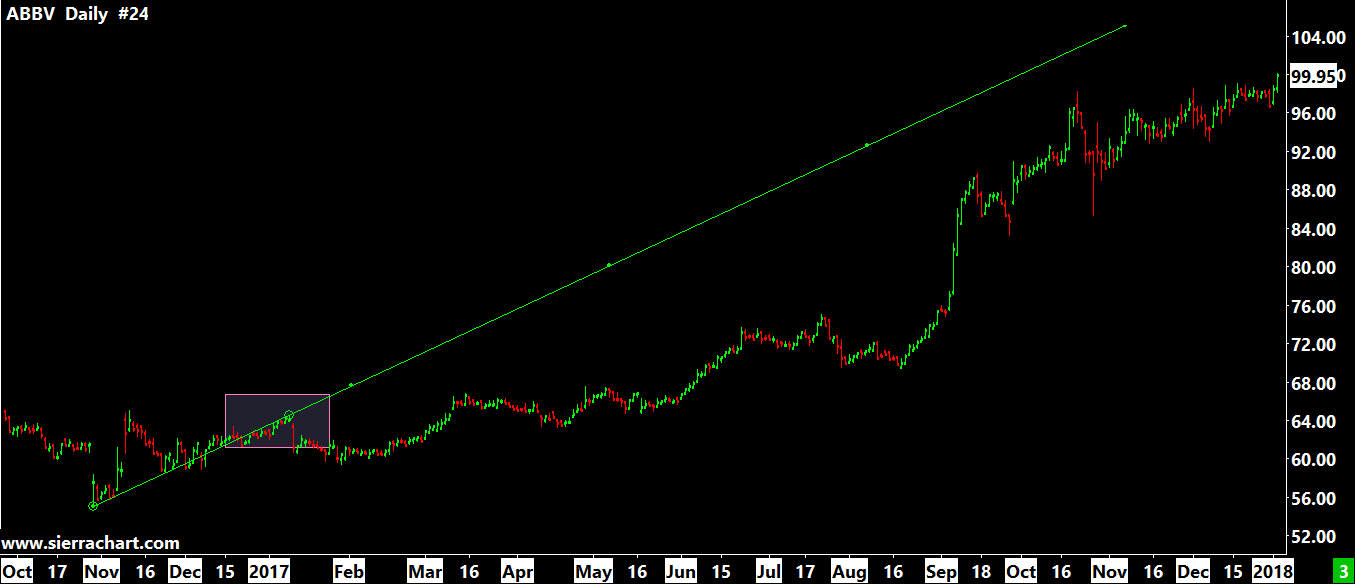

The following is the same chart after switching to linear scale:
http://www.sierrachart.com/image.php?Image=1515077792294.png

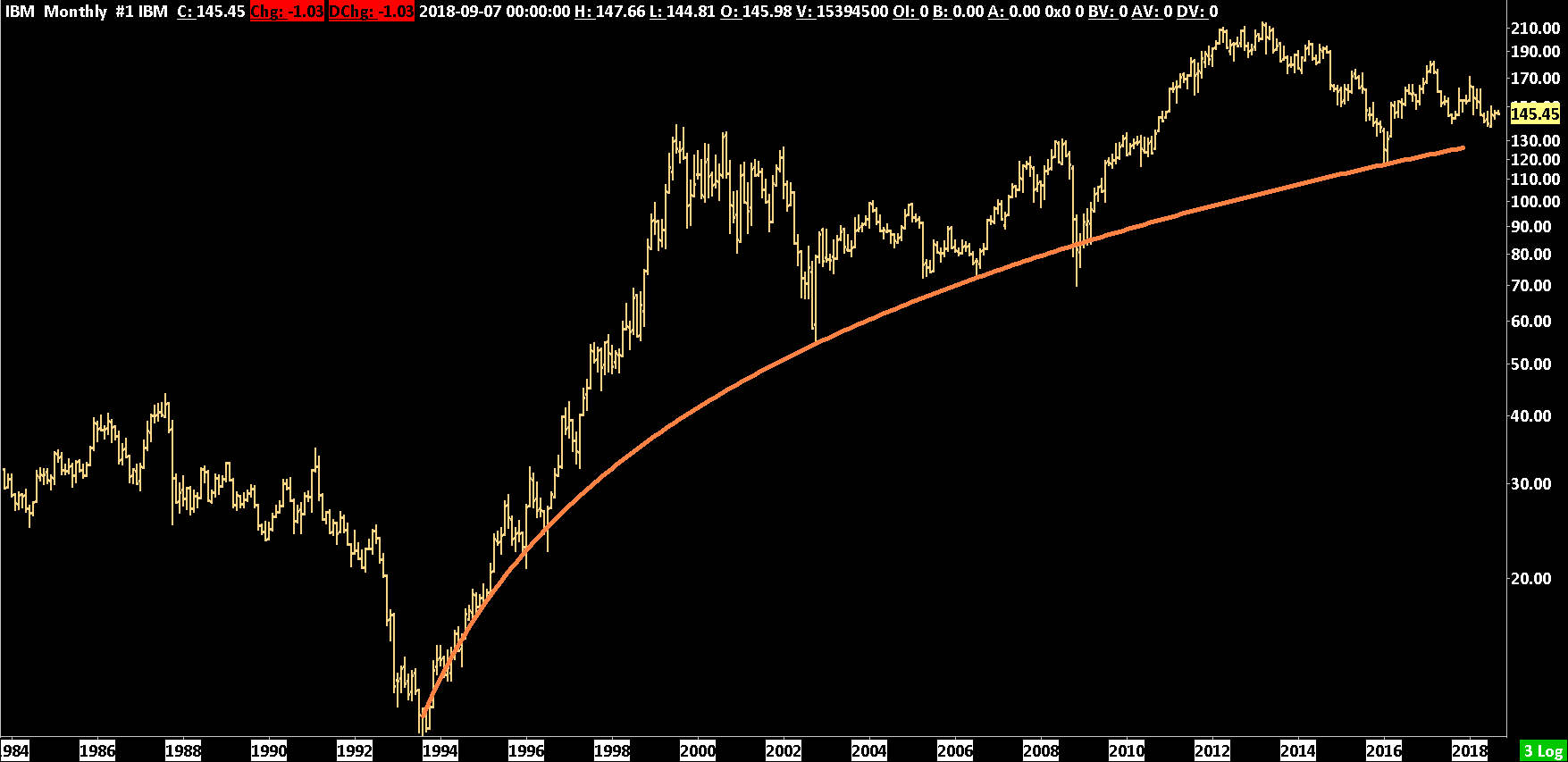

What we need to do is draw each portion of the line between chart bars as a separate segment on a logarithmic scale so there will be a curved line. That is something we are working on. Currently when a line is extended, the extended endpoint is going to map to a specific value on the vertical scale and a specific bar. That is the proper way to do it.
I think SC has lost a lot of users to Tradingview due to lack of some simple features like this one.
We do not really care and we do not think this is the case anyway. We will fix the problem with lines not appearing.
And as far as extending a line on a logarithmic scale, it is done properly if the line is straight, despite what you think. But really the only true proper way to do this is to draw the line as different segments and have it be a curved line.
The simple fact is is that on a logarithmic scale, the concept of a straight line is fundamentally flawed to begin with. That is the core problem. The lines are currently extended properly and will *never* change and we do not agree with anyone who differs on that. There has to be a standard way in which a line is extended to extend to proper endpoint values based on Date-Times and the actual vertical axis price scale. We did a very thorough analysis of this today and we are 100% certain that the way it is done now is correct. There must be consistency with chart drawings between different types of scales, linear or logarithmic, and the chart bars and study values. We will never engage in faulty extension methods which apparently trading view is using. If you want to use substandard software, Trading view by your own admission, you are welcome to leave Sierra Chart. That is perfectly fine with us.
The only true way to draw a line on a logarithmic scale is to draw it bar by bar and have it be curved.
Think of a chart graph which is linear and has a line on it and then you change to a logarithmic scale. The only way to accurately represent that line as it was before is for it to be a curved line.
For consistency therefore, being that the coordinates of a line use the standard linear chart values, when extending a line, these values are used for the extension using a standard linear equation, and then there is the final transformation to the logarithmic scale during drawing. All this makes complete sense. It cannot be done any differently.
Update: We realize why the lines are not drawn on a logarithmic scale, it was because of incomplete development (Still in progress) to be able to draw curved lines on a logarithmic scale to represent proper intersection with the price bars and ultimately give you what you want which is the ultimate perfection. This is going to be corrected in version 1801. But the curved line support will not be supported until a later release.
Here is an example of a properly drawn line on a Logarithmic scale:
http://www.sierrachart.com/image.php?Image=1536486926607.png
At every chart bar, the line is where it is supposed to be. And that is what users expect.

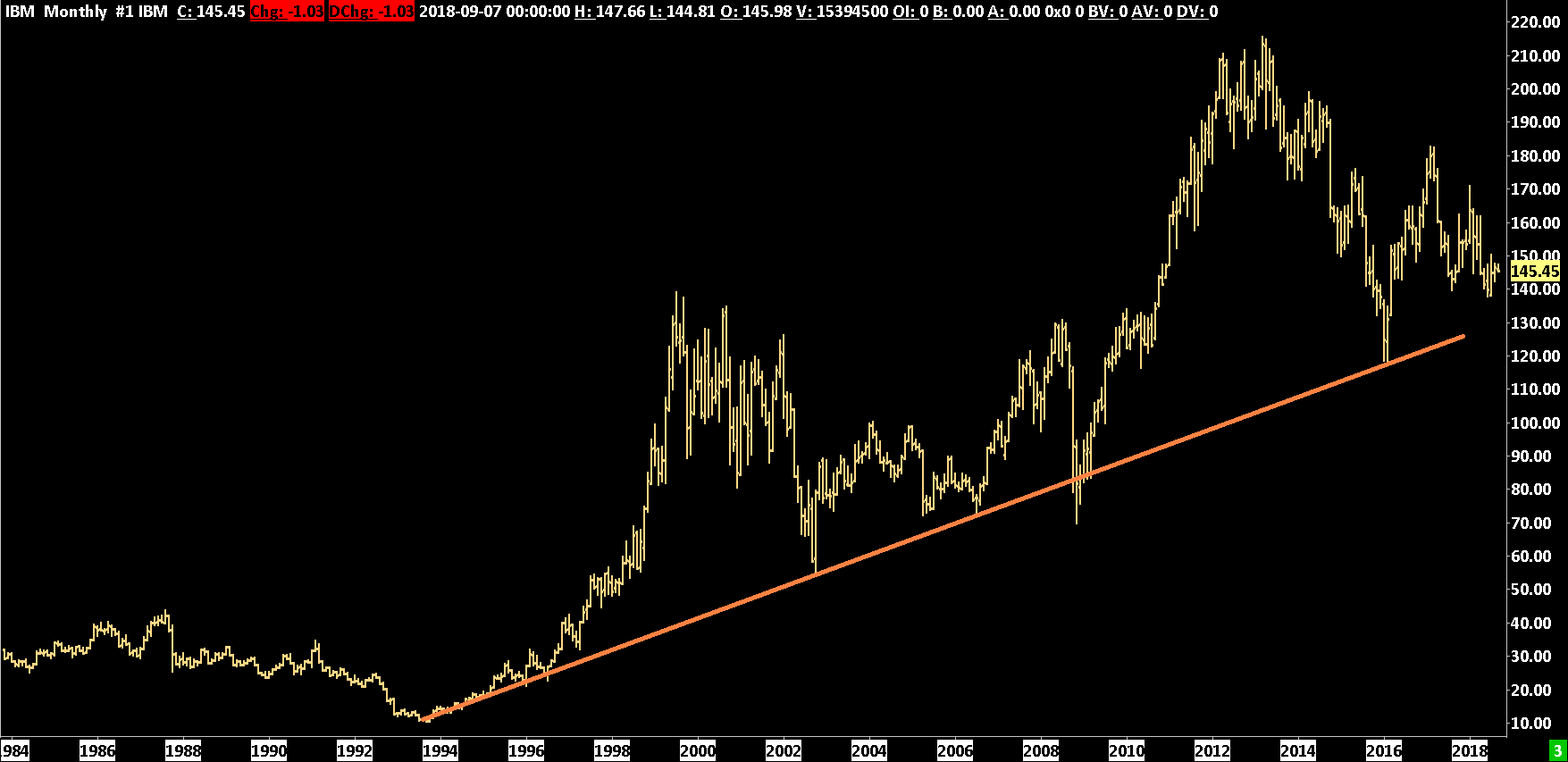

Same line without logarithmic scaling:
http://www.sierrachart.com/image.php?Image=1536486960979.png
