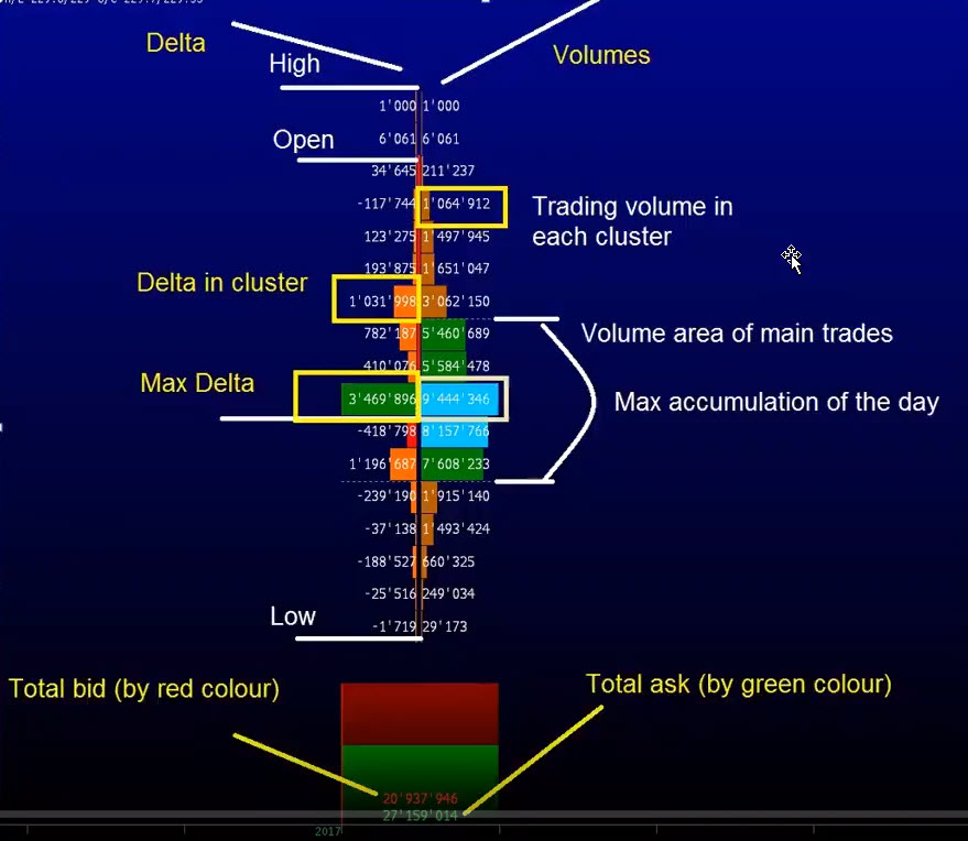

Hello Support,
I wish to be able to represente my chart with the same information as the one displayed on the attached file.
Delta in cluster
Max Delta
The volume in numerical value in histogram
Is this possible ?
Do you have a chart sample of that example taken from Volfix ?
Thanks.

You can do this with the Numbers Bars study:
Numbers Bars
In regards to clusters, not sure if they are referring to a single price level or two adjacent price levels. The Numbers Bars study will only work with single price levels and adjacent price levels for comparisons and color coding.

I'm currently switching from volfix to sierra. What I really liked at volfix is the cluster coloring referring to an absolute number of volume (looked up with a tool called volume search aver a few months e.g. 1%/5%/10%). Is is possible to change the color method from percentage to an absolute number? Or change the percentage value to a monthly volume?
Thank you!
[2019-05-10 16:15:23]
John - SC Support - Posts: 48336
You can color the Numbers Bars study using Actual Volume numbers. Refer to this particular Background Coloring option:
Numbers Bars: Background Coloring Based on Volume - Actual
When using an Actual value coloring, you then enter the values in the Column # Actual Volume Compare Thresholds Input Setting. The documentation for this input can be found here:
Numbers Bars: Column # Actual Volume Compare Thresholds
We are not sure what you are looking for in terms of a Monthly volume. But the chart bars can only be set to 1 Month per bar.
