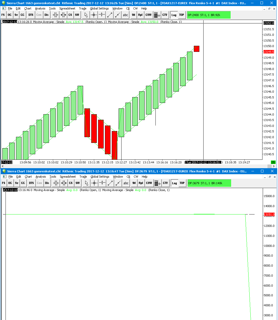

It seems that on some charts, Renko Open and Renko Close are often equal to 0.
Here's a sample on FDAX.
I plot SMA(Renko Open,1) and SMA(Renko Close,1)
Sometimes there is a value, sometimes it's 0 and SMA gets off the chart.
imagerenkoopenclose.png / V - Attached On 2017-12-12 12:20:24 UTC - Size: 52.94 KB - 457 views

Is the Renko New Bar Mode you are using use New Bar When Open Crossed?
This would only be a problem with the last bar in the chart. And we will find a solution to that.

hm yes , looks like it, it seems I was on default settings on my chart and I didn't select the good illogical setting (the 3rd one). Will report if it happens on it
[2017-12-12 18:33:07]
It can only happen with New Bar When Open Crossed and we will solve that.
