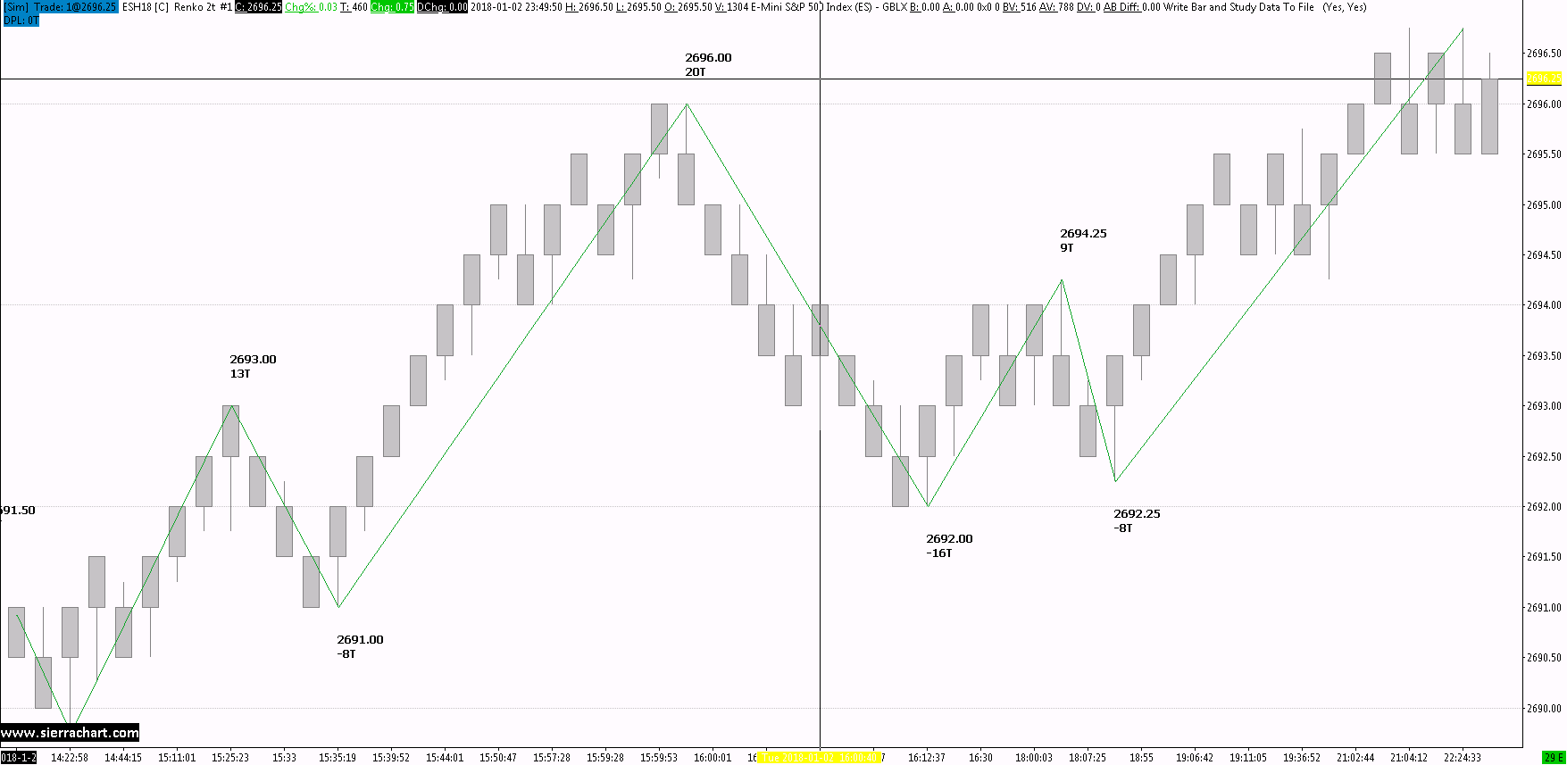

This is what we see using your Chartbook for the most recent Zig Zag Length:
Date, Time, Open, High, Low, Last, Volume, # of Trades, OHLC Avg, HLC Avg, HL Avg, Bid Volume, Ask Volume, Zig Zag, Text Labels, Reversal Price, Zig Zag Line Length, Zig Zag Num Bars, Zig Zag Mid-Point, Extension Lines, Zig Zag Oscillator
2018/1/2, 18:09:45.1, 2692.50, 2693.50, 2692.25, 2693.50, 3270, 1240, 2692.94, 2693.08, 2692.88, 1597, 1673, 2692.25, 0.00, 2692.25, -2.00, 2.00, 2693.25, 0.00, 1.25
Chart:
http://www.sierrachart.com/image.php?Image=1514955290338.png
The -2 in bold is the 8 tick Length.
