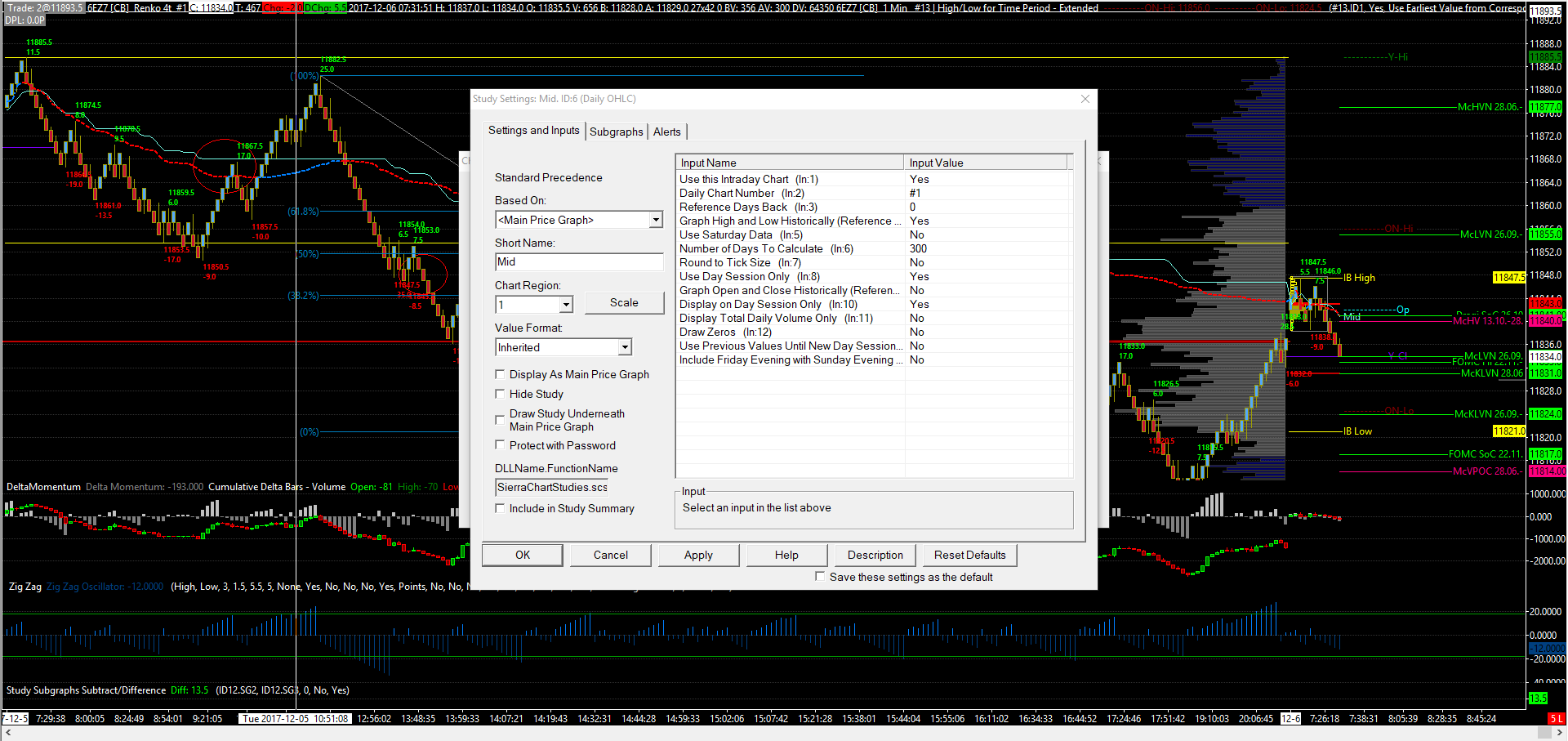

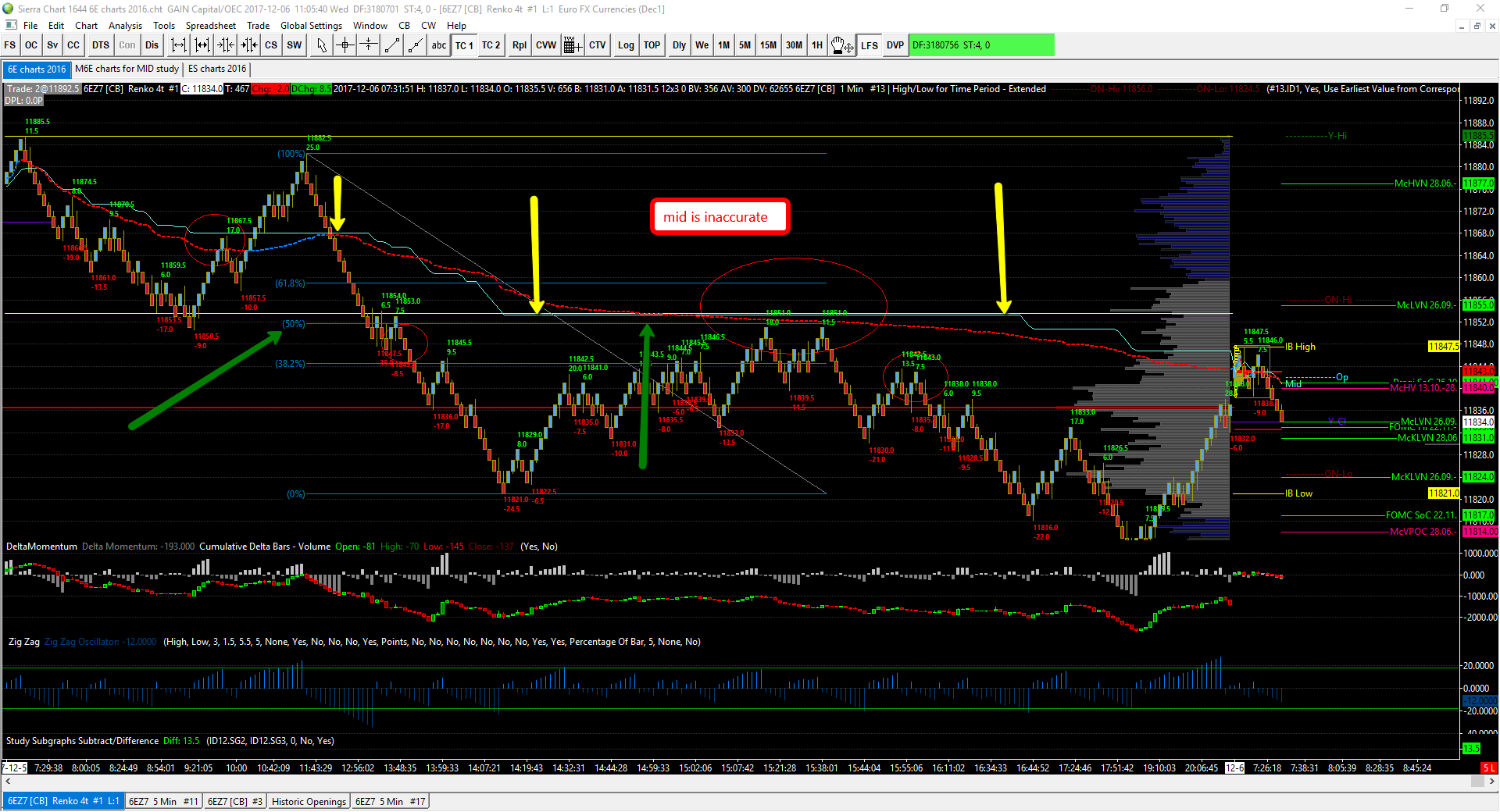

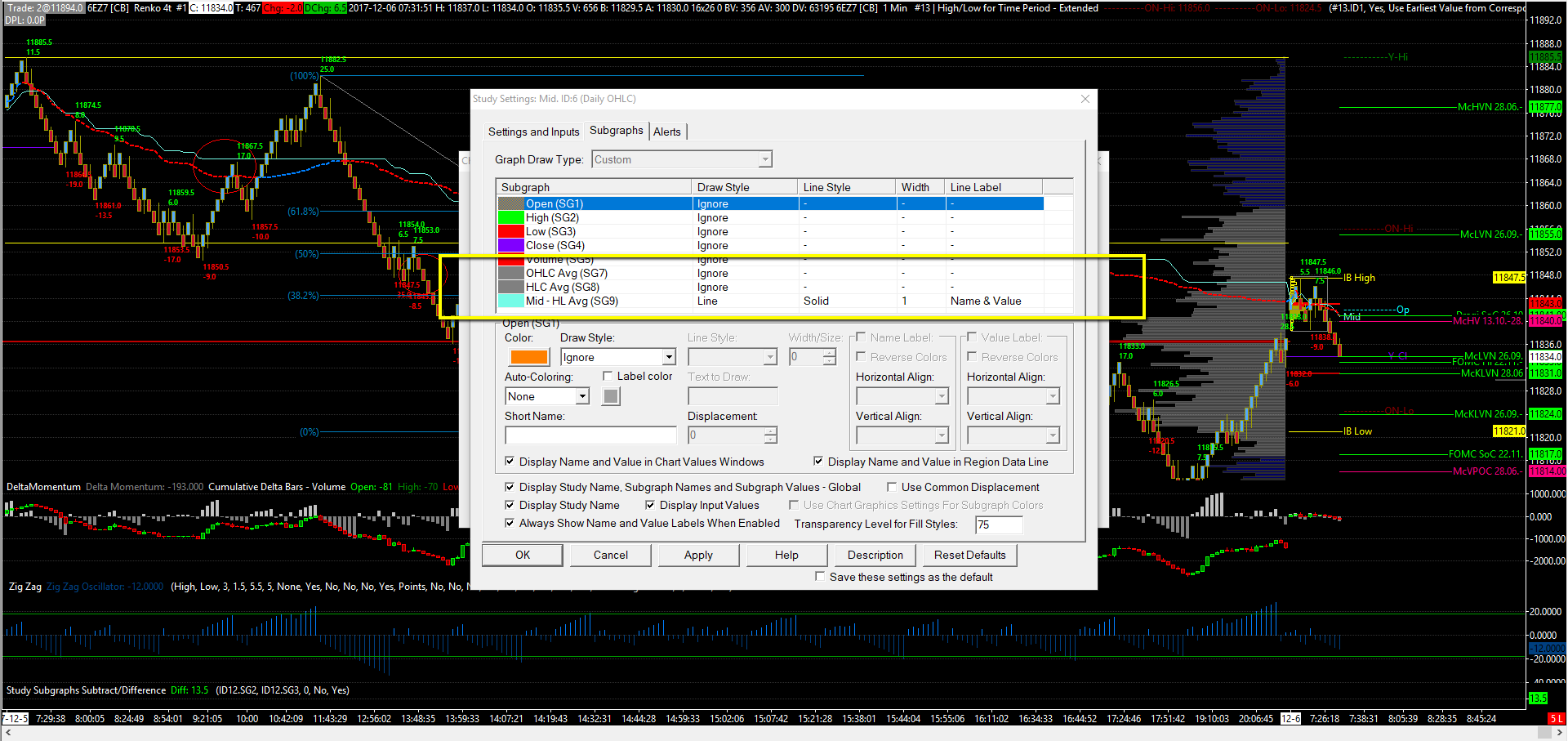

Pls help - the mid calculation is giving incorrect readingds in my observation. A few times before I have noticed it.
PLs see attached pics. The calculation gives a value of 11 851.75, where as the mid in light blue is at 11853.5 ish...
Thanks a lot for help,
best
ves

[2017-12-06 18:27:55]
First, that chart is too complex for us to make any sense of it.
You should realize that.
Here are the instructions to post an image of the chart:
The Mid - HL Average calculation is simply the average of the High and Low of the Daily OHLC study. You can verify that by using the Chart Values tool to see all of these values for the Daily OHLC study:
http://www.sierrachart.com/index.php?page=doc/Tools.html#ChartValues
[2017-12-06 22:57:46]
User97684 - Posts: 136
Thanks, sorry my bad, there is nothing wrong with the mid , it is working correctly. (I was not taking the high of the day, but the high of that particular swing).
