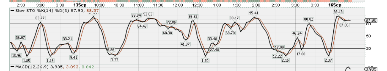

Can the stochastic values be displayed as shown on the attachment? (not on the Y Axis, but rather the places where the line turns)

The capability for this will be supported in the next release. Although it is not exactly what you are looking for but as close as we can reasonably get it:
http://www.sierrachart.com/image.php?l=1379377846708.png
There will be a new draw style called Value of Subgraph that you can use. In this image, we have 2 stochastic studies in the chart region so you can also see the normal line as well.

There is actually a way to do exactly as the image shows by using the Color Bar Based on Alert Condition by writing a formula which checks for the change in direction of the stochastic line. And set it to output the Stochastic value at the chart columns where this is true. By using the Value of Subgraph, you will then get the display that you are looking for.

What we meant in our prior posting is that the new draw style Value of Subgraph in combination with the Color Bar Based on Alert Condition can give you the exact same result as shown in the original image you posted.
