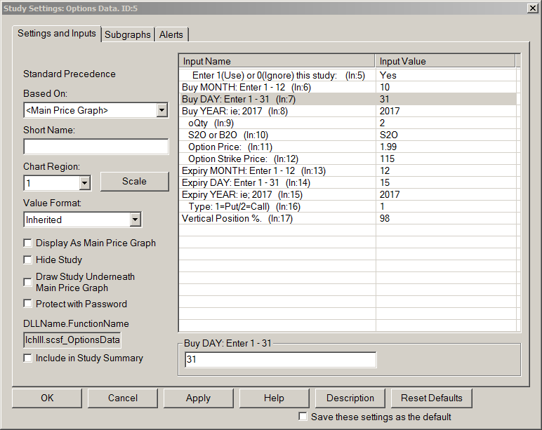

I need a faster way to enter data inputs into the Study data window.
Every trading day, I crunch over 100 symbols worth of chart data and I use a custom ACSIL study that requires 7-10 unique and custom data inputs.
In addition, most of these symbols change monthly.
So I have an enormous amount of data input that I have to manually enter.
Question 1:   Ca you provide a tab control, for the Study Settings Input Value Window?
Currently, I have to manually move the cursor (by mouse) from one data input to the next, 10 times per chart. This is exceedingly time consuming. It would be so much quicker to just tab from input to input. I would pay for this feature to be developed.
Question 2:  Even better!!! Is there any way to load symbols and inputs from a spreadsheet or text file and allow SC to build the chart utilizing the symbols and data from each line in the file?
Question 3:  Is there any way to have a Chart Update Interval that is longer 90,000 milliseconds or a minute and a half?
I really need an update in the vicinity of 5 - 10 minutes.
SC is a fantastic value and very powerful and flexible. I've been using it for almost a year now and have found it to be an excellent tool for my trading style. Thanks for developing such a loaded program at such a great price!
imagestudy_data_inputs_window.PNG / V - Attached On 2017-11-26 18:56:12 UTC - Size: 40.36 KB - 781 views

[2017-11-27 20:23:51]
1. Refer to this section here for alternative:
Chart Studies: Changing Study Inputs Directly from Chart
2. This is something you can do just with ACSIL. Just read the Inputs from your own text file.
3. Up to 10 minutes will be supported in the next release.
