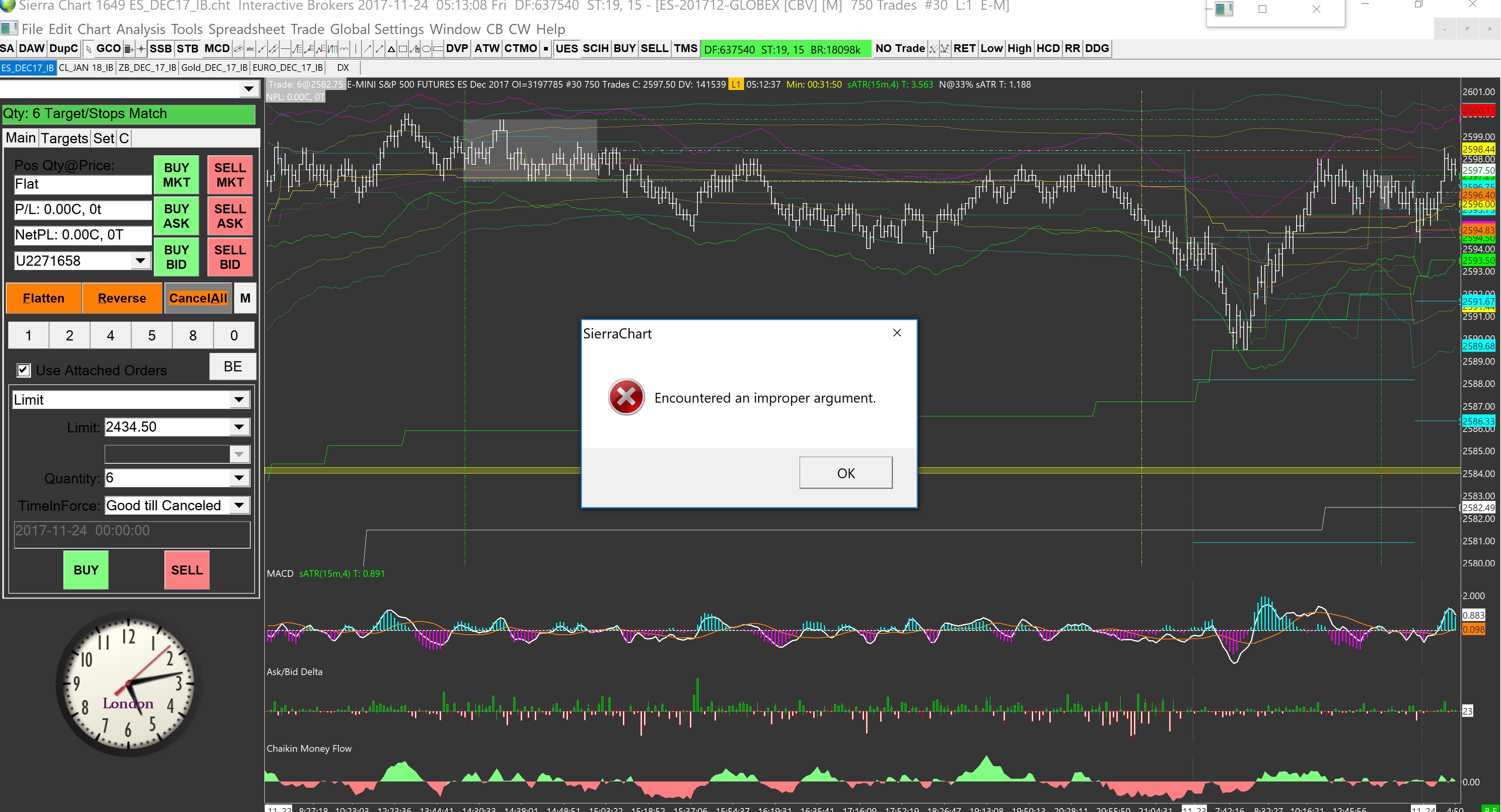

I had this message appear and I had to restart - Please advise reason/remedy
imageSC Error Message.jpg / V - Attached On 2017-11-24 05:32:49 UTC - Size: 1.34 MB - 501 views

There are two things that we need from you to determine the problem. If there is a particular Chartbook file this occurs with, we need you to attach it following these instructions:
Also attach the Sierra3.CFG file in the main Sierra Chart folder. Both of these can be privately attached.
Also did this happen after opening a particular Chartbook ?
Date Time Of Last Edit: 2017-11-24 06:07:52

This occurred just now with a DXY Chartbook. Enclosed CHT & CFG Files
Private File
Private File
[2017-11-26 22:16:12]
We were unable to reproduce that error message you are getting using this Chartbook and global configuration file.
It might be Windows 10 specific.

I rolled back the last MSW 10 update...I'll see if this works

OK when you have the problem do you notice any obvious issues with Sierra Chart?
If you still have a problem, one thing you can try but we do not know if it would make a difference, is to reset Sierra Chart to a default state. Refer to:
https://www.sierrachart.com/index.php?page=doc/helpdetails39.html

FYI I rolled back to MS Windows 10 Ver.1703, OS Build 15063.726 I have not had the issues of disappearing windows or the fatal error message now in appprox 1 day. I run 5 monitors on Nvidia cards. I am keen to keep up to date with Windows updates .. I appreciate that keeping up with MS updates in SC is hard, but do you have a process/documentation that shows what SC version is compatible with what MS Update? For the moment I have disabled updates and wait for a longer term solution _ Switching OS is not an option.
