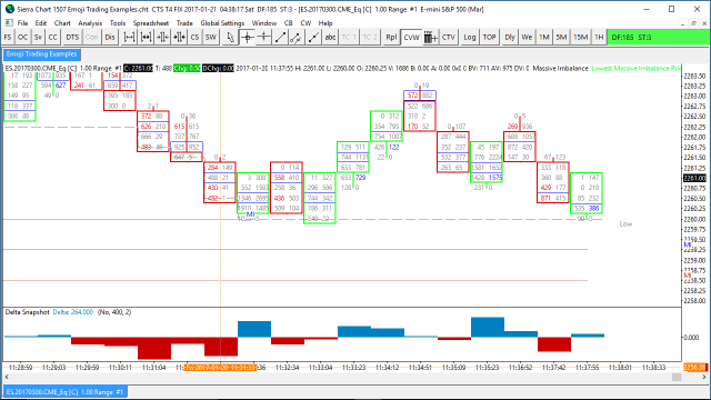

www.emojitrading.com/massive-imbalance will take a price level that exceeds a user-specified diagonal imbalance (or absolute volume level) and forward project a zone by a user-specified number of bars and/or an extension line that will project forward until price trades at that level again.
If the Edge Zones are as simple as a diagonal imbalance of x%, this is a 99% implementation that's been available for over a year, the only difference being the extension line projection ending when price trades at that level vs when the bar closes above/below the level.

imageMassive-Imbalance-Level-2-Emoji-Trading-Order-Flow-Suite.png / V - Attached On 2017-11-13 06:44:53 UTC - Size: 17.87 KB - 1731 views
