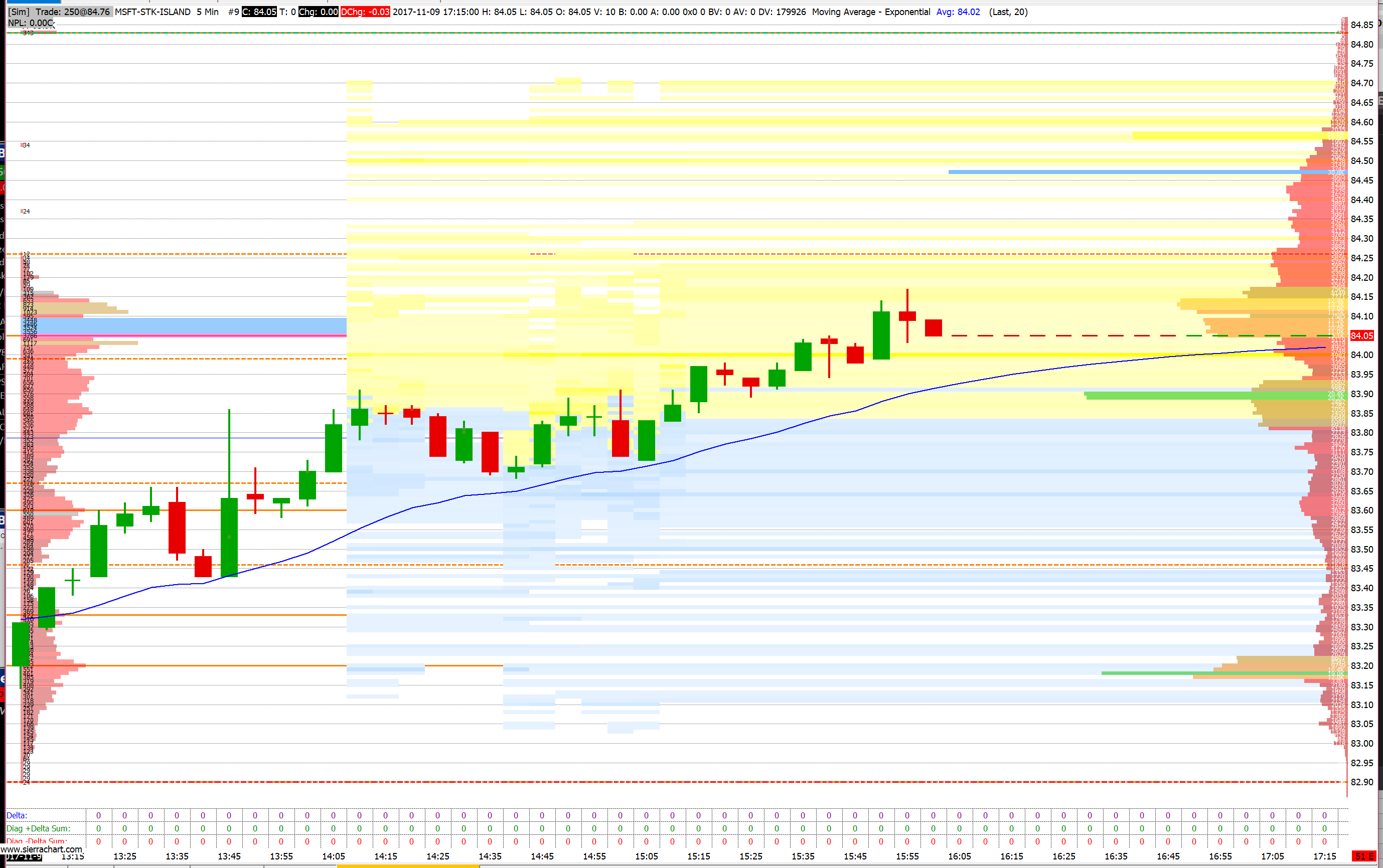

I will follow with a screenshot, but yes this parameter is setup correctly and if i use MSFT-STK-SMART/NASDAQ with IB data source, I have Large Volume Trade Indicator working, but not the depth of market, if I use MSFT-STK-ISLAND, then DOM works but Delta (Number Bars Calculated Values) and Large Volume Trade Indicator stop working.
[2017-11-10 05:04:47]
stephane - Posts: 19
http://www.sierrachart.com/image.php?Image=1510290244642.png

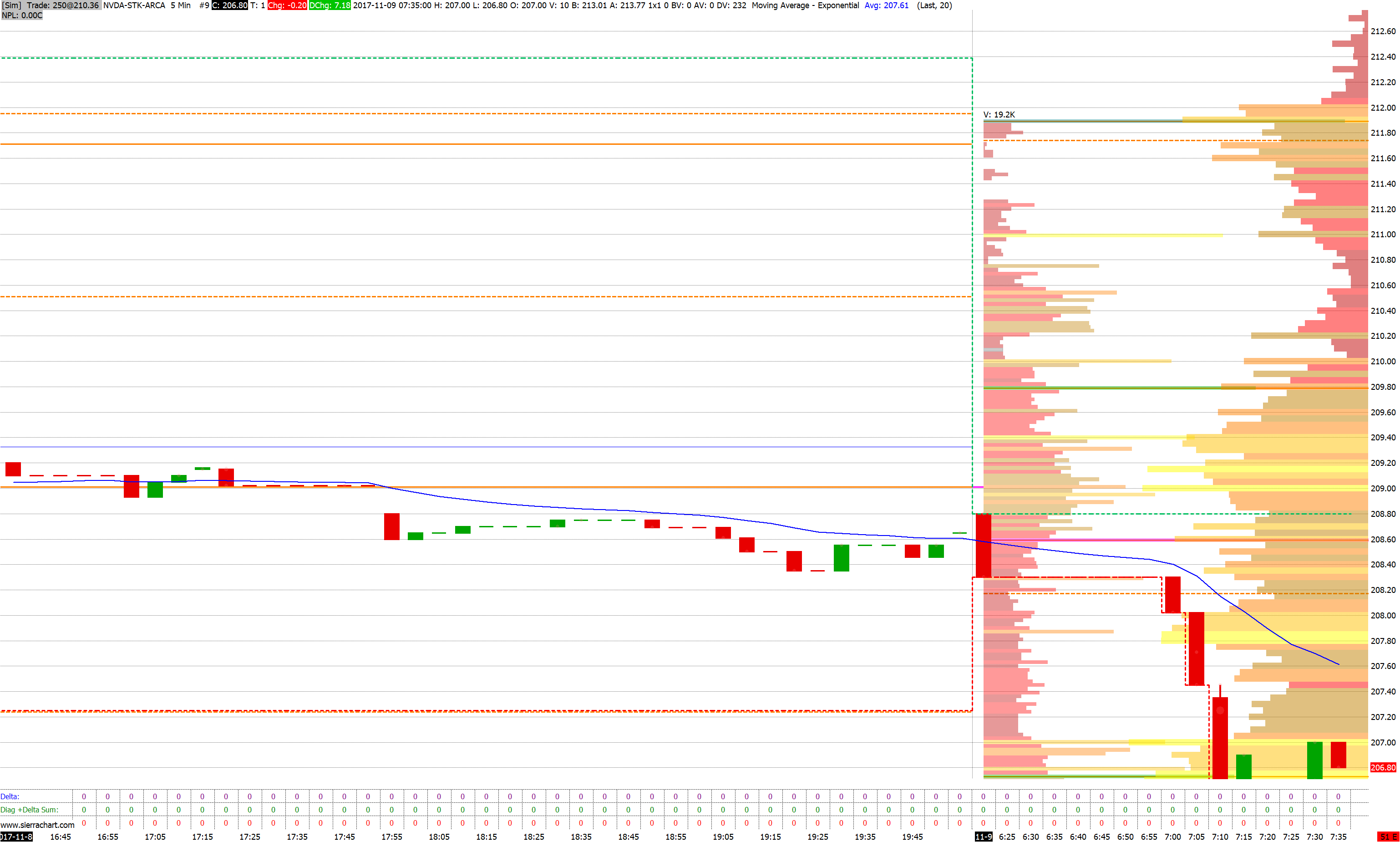

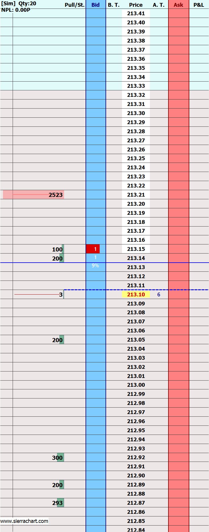

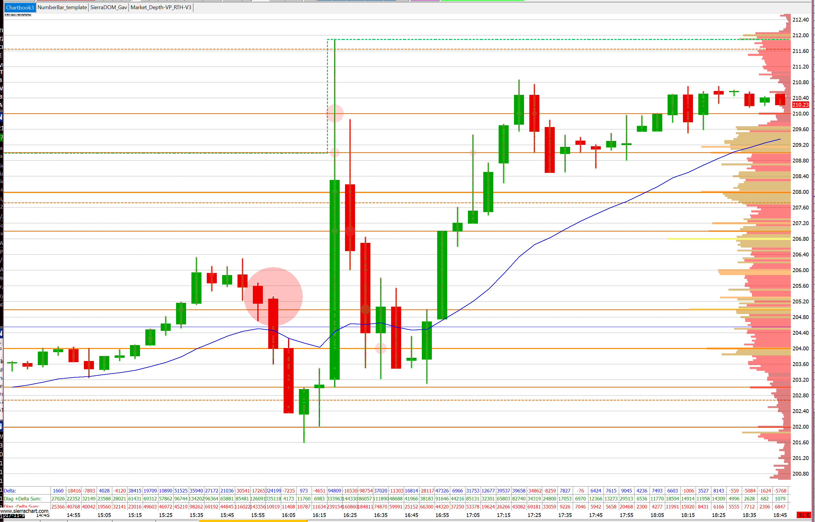

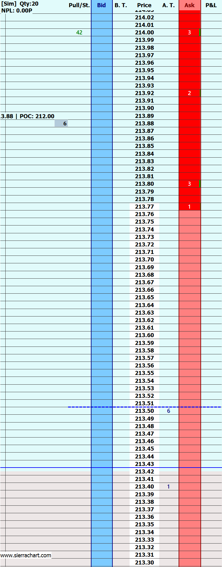

[2017-11-10 10:22:54]
So here with more 'live' data with IB:
NVDA-STK-SMART/NASDAQ (indicators working correctly but not market depth)
http://www.sierrachart.com/image.php?Image=1510307957360.png
http://www.sierrachart.com/image.php?Image=1510308080481.png
NVDA-STK-ARCA (market depth working correctly bu not indicators)
http://www.sierrachart.com/image.php?Image=1510308636826.png
http://www.sierrachart.com/image.php?Image=1510308790874.png

In fact in the later case, the Trade Volume for Bar is automatically disabled in the study (when using the last stock naming). But it is recording and showing Number Bars Calculated Values (but they are not backfilled)
