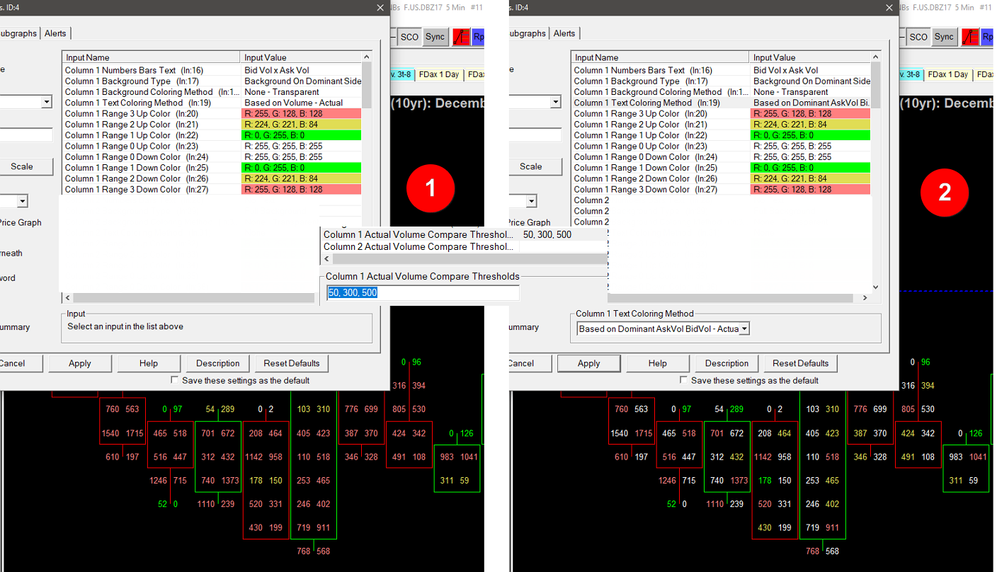

I would like to color-highlight the absolute values in NumbersBars.
Values less than 100 = blue
Values between 101 and 500 = yellow
Values over 500 = green (examples)
Is this possible?

[2017-11-04 05:20:47]
nicktrader - Posts: 817
Thank you for the fast response.
I have tried various settings, but unfortunately I did not get the desired result (as you can see on the attached pic).
In line "Column 1 Actual Volume Compare Threshold" I have entered the values 50, 300, 500
The setting "Based on Volume - Actual" shows a very unsatisfactory result (pic#)
The setting "Based on Dominant AskVolBidVol - Actual" only displays the dominant page correctly (pic#2).
My goal is to get a simple color representation of both sides, without any comparison.
For example: If I have Bid = 60 and Ask = 350 then Bid should be green and Ask yellow. That's it.
If this should be possible could you show me the individual necessary settings. It would be very helpful for me, because the big amount of text almost kills you esp. if you not an English native speaker

[2017-11-06 01:51:35]
We have to add this. It currently does not exist.

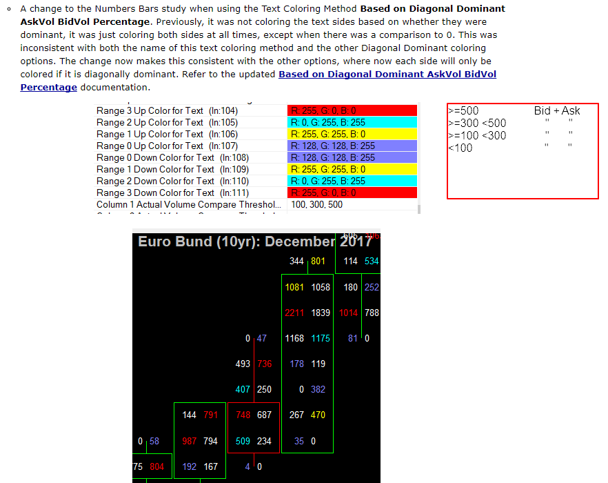

New coloring methods have been added to support what you require. Update to the current version following these instructions:
[2017-11-20 07:15:17]
Pls take a look to my pic
In Release you mentioned the Coloring method, but this is not what I was loooking for.
I'd like to have the possibility to color all values without any comparising of dominant side or percentage or ...
If bid side is 600 make it red and the ask side on the same level is only 75 make this value blue. That's it. No comparising...
Maybe this is possible but at the moment I can't see it. If it is possibility please be so kind and tell me the settings.

[2017-11-20 14:45:00]
We apologize. We had mistakenly thought this was released. It has not been. The new coloring method is named: Based on Separate Ask Volume Bid Volume - Actual
It has not yet been released.
