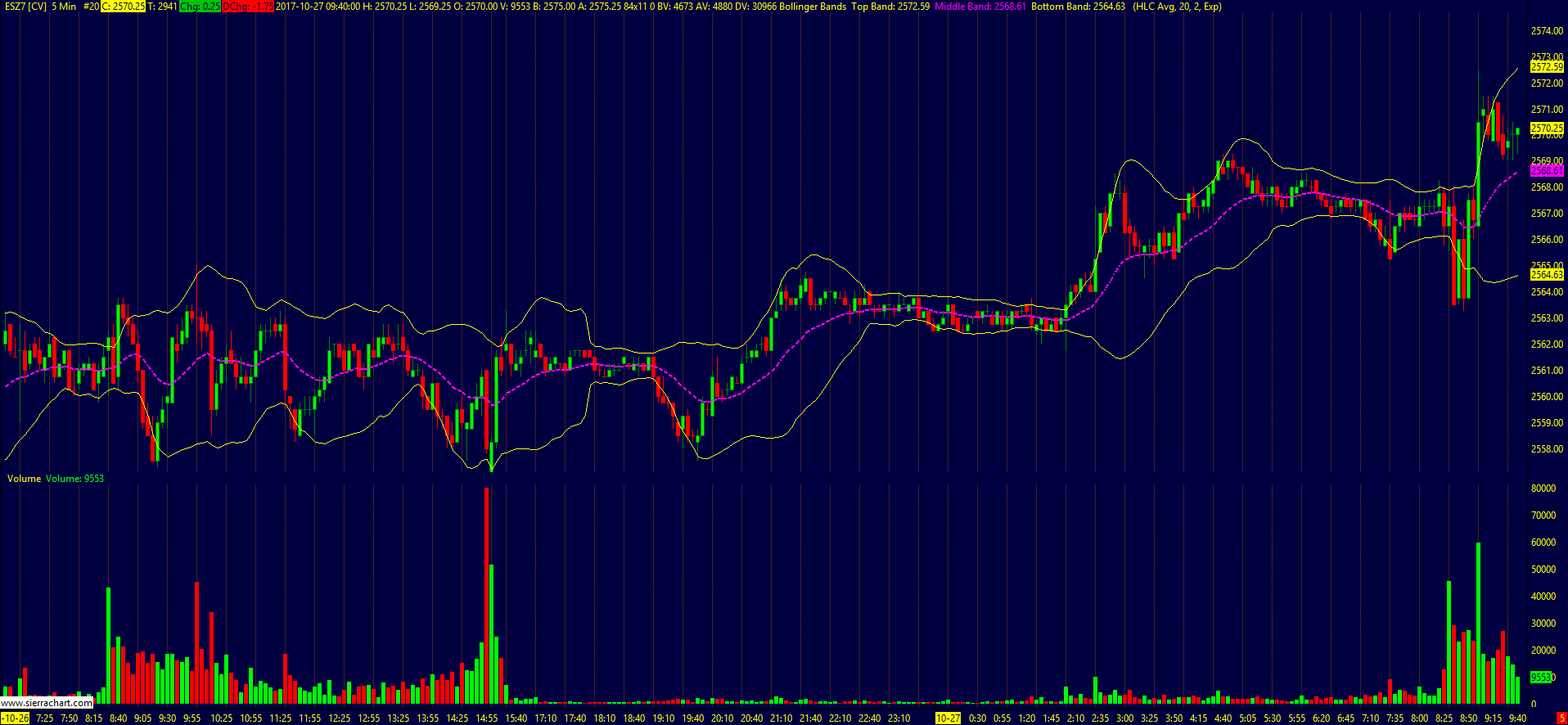

In this example I am trying to replay the chart from Friday morning, October 27. I try to replay from this point:
http://www.sierrachart.com/image.php?Image=1509327049122.png

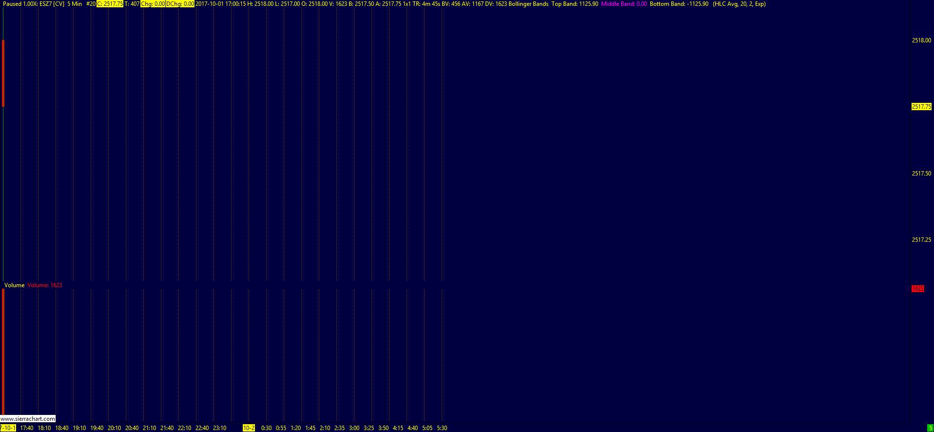

After I hit the replay button the replay chart moves to 5 pm Central time and produces the following replay:
http://www.sierrachart.com/image.php?Image=1509327282331.png

[2017-10-30 18:32:25]
There must be out of order data somewhere in the chart. The first thing to do is to set the Continuous Contract Chart Setting to None and see if there still is a problem:
Chart Settings: Continuous Contract (Chart >> Chart Settings >> Symbol >> Symbol menu)
If there is, you will need to fully re-download the data in the chart.
To fully re-download the data for a Continuous Futures Contract chart, follow the instructions here:
Otherwise, re-download all the data in the chart by going to the chart and selecting "Edit >> Delete All Data and Download".

[2017-10-31 01:56:17]
OK we realize what the problem is. On the Replay Window Uncheck Use Start Date-Time.
