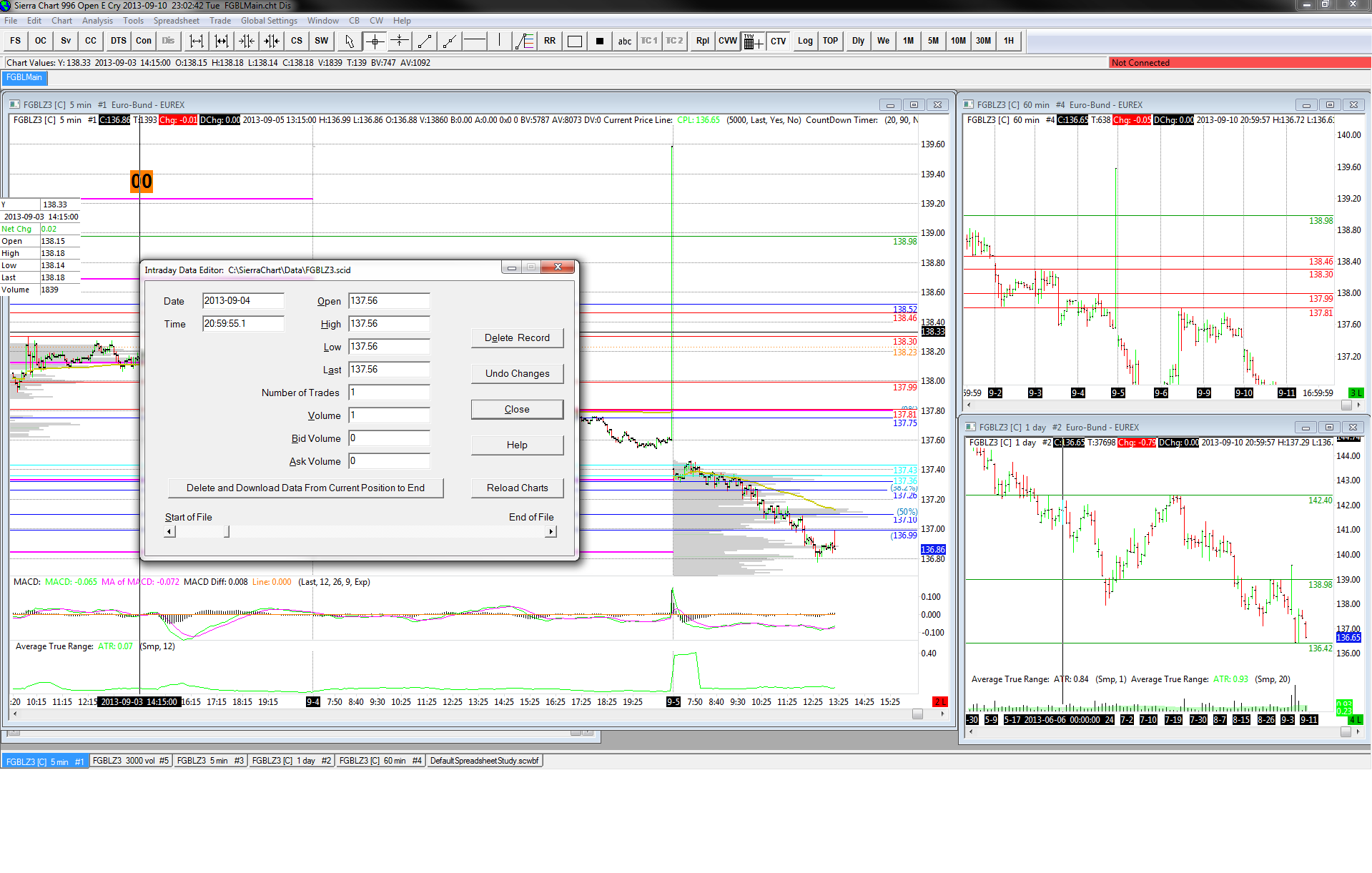

Suddenly today my chart changed for the close of 04/Sep/2013 on FGBL. Please see attached pic. Specifically the nonsense close at 139.58 showing on the intraday charts. Wasn't like this previously. Tried to select just this bar and Edit/Download Data - Intraday chart to remove this obvious junk price, but for whatever reason, scrolling through the last 3 minutes of trading, none of the data actually shows a price of 139.58. the screenshot shows the last data point before clicking once more in the direction of "end of file" takes you to 2013-09-05. Loathe to delete and redownload as have already made an adjustment on rollover (using edit- adjust data) originally there was no issue. this only appeared today.
What's the problem here?

[2013-09-10 22:24:25]
If you post an image, it needs to be an image of a single chart without any studies that clearly shows the particular problem. Follow these instructions to provide an image of the chart:
https://www.sierrachart.com/index.php?l=PostingInformation.php#Image
We are not really sure what to look at in the existing image. Although we think we see what you are referring to.
Do you notice the unexpected value when you do not use the Continuous Futures Contract option? If not, then you may be seeing data from a prior contract month.
Date Time Of Last Edit: 2013-09-11 21:02:28
[2013-09-11 07:08:18]
Pawel_Szpak - Posts: 48
The solution was in your answer. I changed the continuous chart to refer back to prior symbol. Could then edit the data to get rid of the price spike. Solved.
Date Time Of Last Edit: 2013-09-11 07:09:08
[2013-09-11 21:01:34]
This is good.
