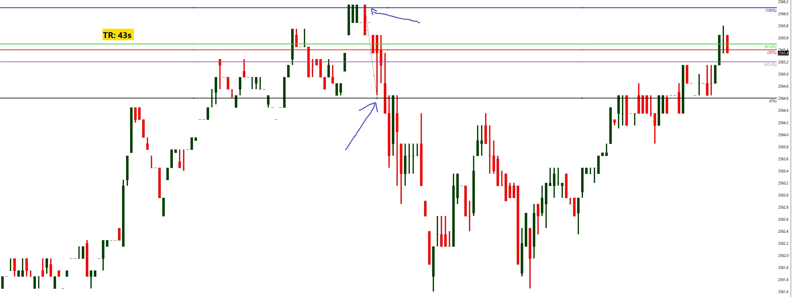

please tell me why tools like retracement and projection
do not start measureing exacly from start or end of candle bar
please look what i mean on the picture (link below)
on the top You can see that measure start lower than the top of candle
and the other choice You can see show that point start measure is lower than bottom of candle
this is 5min chart
here is image what i mean about
https://zapodaj.net/ff040fee8c612.jpg.html
Please help me with this ssue

Make sure you enable snapping when using these drawing tools so that the endpoints go to the high and low of the chart bars that you want. Refer to:
Chart Drawing Tools: Automatic Snapping of Chart Drawing Ends to Open, High, Low or Close Bar Values
You can use these commands to snap the existing endpoints of those Chart Drawings to the high and low values:
Chart Drawing Tools: Snap to High/Low | Snap Side to High/Low
