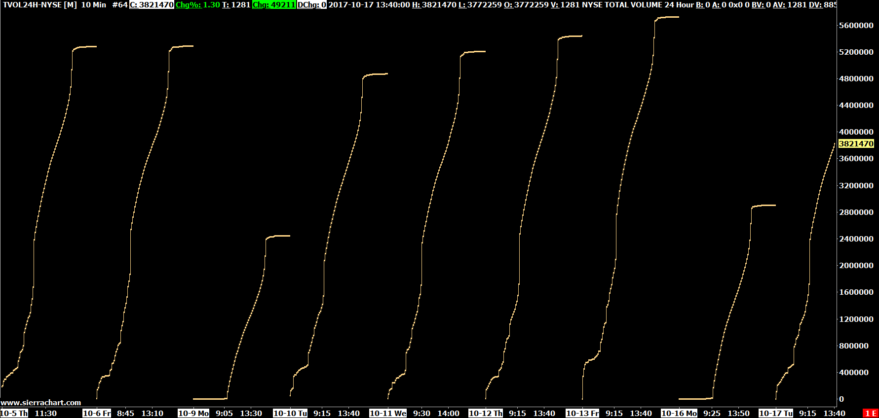

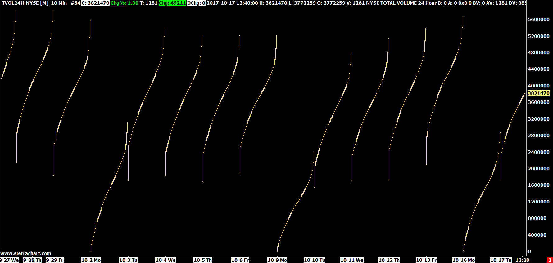

i went back for the past couple of weeks to compare....

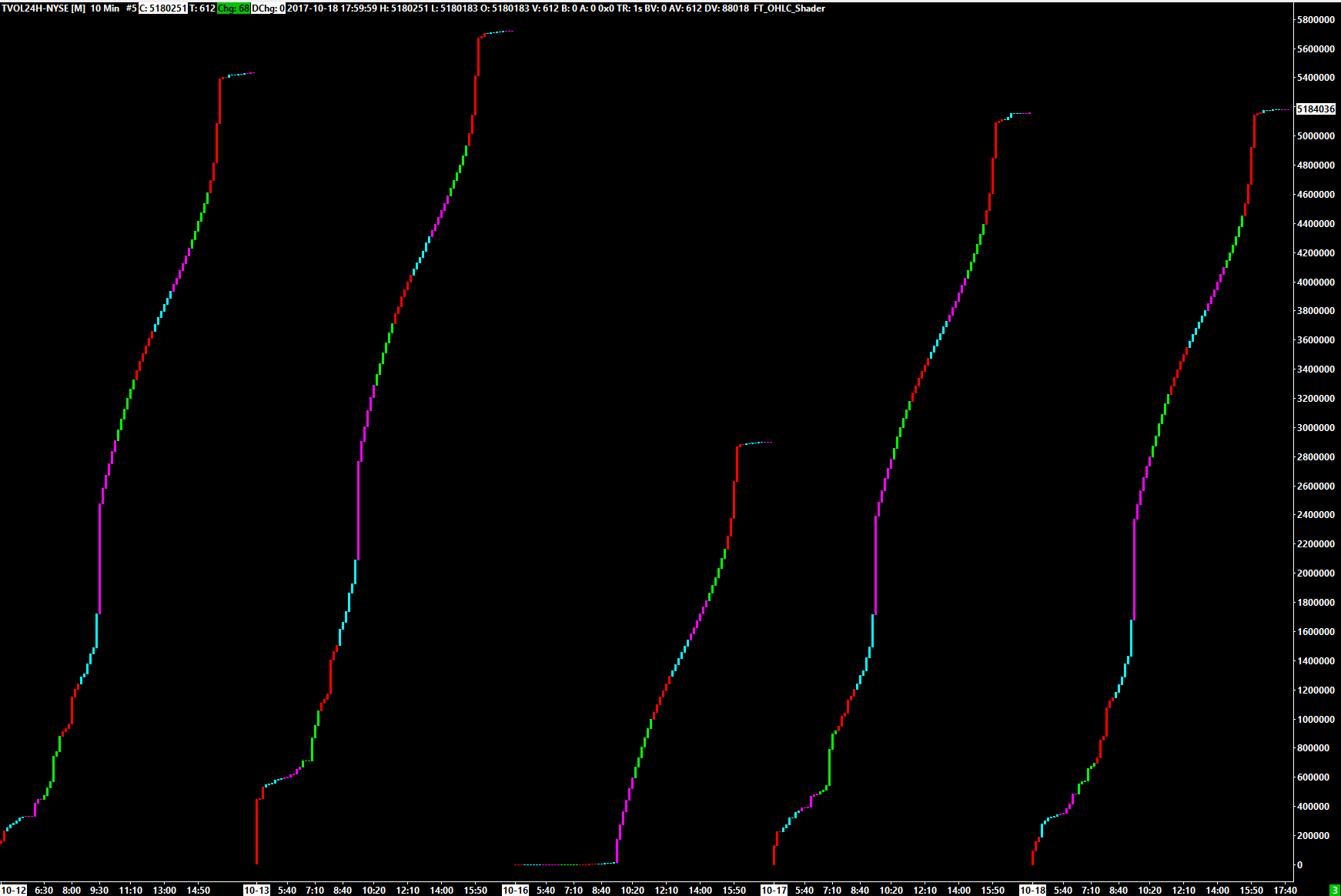

For instance today i have around 5,184,000 at end of day today 10-18-2017 (and leveling off for evening). Start time at midnight.

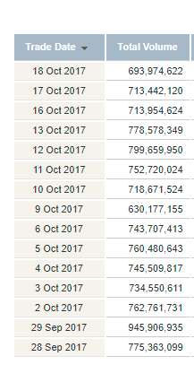

NYSE market Data shows 6,930,000 for today and looking back most days seem to be off significantly.
and the 10/16/2017 looks like about half the NYSE MARKET data
I compared IQFeed and it matches NYSE market Data consistently for instance.
Any thoughts?
image2017-10-18_TVOL24H-NYSE.png / V - Attached On 2017-10-18 23:50:11 UTC - Size: 34.08 KB - 440 views
image2017-10-18_NYSE_VOL_SUMMARY.png / V - Attached On 2017-10-18 23:55:47 UTC - Size: 16.29 KB - 453 views
This clearly appears to be that the Barchart data feed that we use was not transmitting the complete data in the premarket. We do not know why this is the case. We will need to ask them about this.
When we add together the end of day volume for TVOL24H-NYSE and TVOL24H-NYSEMKT for 2017-10-18 this is the volume we get:
6910337000
So apparently those volume numbers you are looking at from the exchange are a combination of those two exchanges.

We need to make a correction, the correct volume is 6,910,337,000

[2017-10-25 15:44:49]
User316362 - Posts: 215
Definitely some wrong with TVOL24H-NYSE again and happening on a Wednesday now...See 10/25/2017
Date Time Of Last Edit: 2017-10-25 15:45:41
[2017-10-25 17:06:26]
This was due to a hardware problem Barchart had early this morning. It is resolved. There is nothing we can do with the market statistics for today in the premarket
However, we will make sure there is no missing US equities data. We will patch the data at the end of the day.
