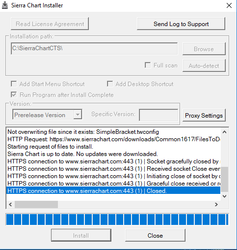

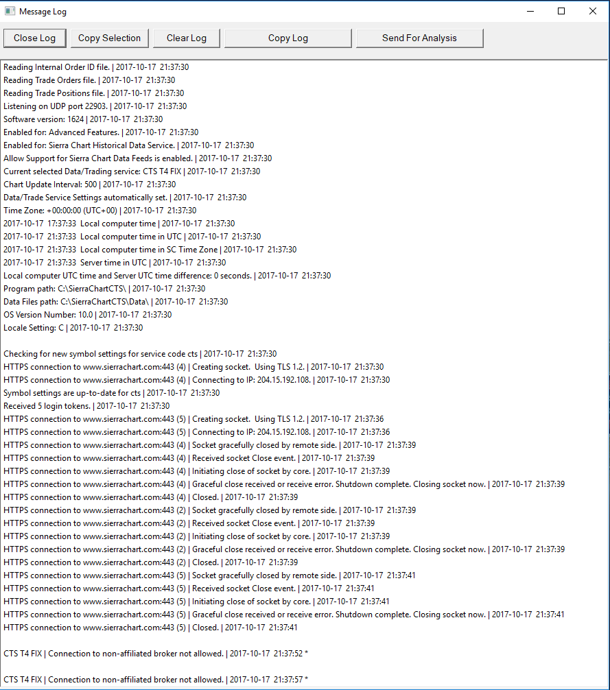

User379468 - Posts: 508
This is the entire message log, it is a new fresh install of Sierrachart in a new folder, nothing has been modified except inputing the DTS connection settings to eliminate other variables. The Service selected is CTS T4 FIX [trading].
Here it is again below. Also attached screenshot showing it is the entire log (no scroll bar available)
Reading Internal Order ID file. | 2017-10-17 21:37:30
Reading Trade Orders file. | 2017-10-17 21:37:30
Reading Trade Positions file. | 2017-10-17 21:37:30
Listening on UDP port 22903. | 2017-10-17 21:37:30
Software version: 1624 | 2017-10-17 21:37:30
Enabled for: Advanced Features. | 2017-10-17 21:37:30
Enabled for: Sierra Chart Historical Data Service. | 2017-10-17 21:37:30
Allow Support for Sierra Chart Data Feeds is enabled. | 2017-10-17 21:37:30
Current selected Data/Trading service: CTS T4 FIX | 2017-10-17 21:37:30
Chart Update Interval: 500 | 2017-10-17 21:37:30
Data/Trade Service Settings automatically set. | 2017-10-17 21:37:30
Time Zone: +00:00:00 (UTC+00) | 2017-10-17 21:37:30
2017-10-17 17:37:33 Local computer time | 2017-10-17 21:37:30
2017-10-17 21:37:33 Local computer time in UTC | 2017-10-17 21:37:30
2017-10-17 21:37:33 Local computer time in SC Time Zone | 2017-10-17 21:37:30
2017-10-17 21:37:33 Server time in UTC | 2017-10-17 21:37:30
Local computer UTC time and Server UTC time difference: 0 seconds. | 2017-10-17 21:37:30
Program path: C:\SierraChartCTS\ | 2017-10-17 21:37:30
Data Files path: C:\SierraChartCTS\Data\ | 2017-10-17 21:37:30
OS Version Number: 10.0 | 2017-10-17 21:37:30
Locale Setting: C | 2017-10-17 21:37:30
Checking for new symbol settings for service code cts | 2017-10-17 21:37:30
HTTPS connection to www.sierrachart.com:443 (4) | Creating socket. Using TLS 1.2. | 2017-10-17 21:37:30
HTTPS connection to www.sierrachart.com:443 (4) | Connecting to IP: 204.15.192.108. | 2017-10-17 21:37:30
Symbol settings are up-to-date for cts | 2017-10-17 21:37:30
Received 5 login tokens. | 2017-10-17 21:37:30
HTTPS connection to www.sierrachart.com:443 (5) | Creating socket. Using TLS 1.2. | 2017-10-17 21:37:36
HTTPS connection to www.sierrachart.com:443 (5) | Connecting to IP: 204.15.192.108. | 2017-10-17 21:37:36
HTTPS connection to www.sierrachart.com:443 (4) | Socket gracefully closed by remote side. | 2017-10-17 21:37:39
HTTPS connection to www.sierrachart.com:443 (4) | Received socket Close event. | 2017-10-17 21:37:39
HTTPS connection to www.sierrachart.com:443 (4) | Initiating close of socket by core. | 2017-10-17 21:37:39
HTTPS connection to www.sierrachart.com:443 (4) | Graceful close received or receive error. Shutdown complete. Closing socket now. | 2017-10-17 21:37:39
HTTPS connection to www.sierrachart.com:443 (4) | Closed. | 2017-10-17 21:37:39
HTTPS connection to www.sierrachart.com:443 (2) | Socket gracefully closed by remote side. | 2017-10-17 21:37:39
HTTPS connection to www.sierrachart.com:443 (2) | Received socket Close event. | 2017-10-17 21:37:39
HTTPS connection to www.sierrachart.com:443 (2) | Initiating close of socket by core. | 2017-10-17 21:37:39
HTTPS connection to www.sierrachart.com:443 (2) | Graceful close received or receive error. Shutdown complete. Closing socket now. | 2017-10-17 21:37:39
HTTPS connection to www.sierrachart.com:443 (2) | Closed. | 2017-10-17 21:37:39
HTTPS connection to www.sierrachart.com:443 (5) | Socket gracefully closed by remote side. | 2017-10-17 21:37:41
HTTPS connection to www.sierrachart.com:443 (5) | Received socket Close event. | 2017-10-17 21:37:41
HTTPS connection to www.sierrachart.com:443 (5) | Initiating close of socket by core. | 2017-10-17 21:37:41
HTTPS connection to www.sierrachart.com:443 (5) | Graceful close received or receive error. Shutdown complete. Closing socket now. | 2017-10-17 21:37:41
HTTPS connection to www.sierrachart.com:443 (5) | Closed. | 2017-10-17 21:37:41
CTS T4 FIX | Connection to non-affiliated broker not allowed. | 2017-10-17 21:37:52 *
CTS T4 FIX | Connection to non-affiliated broker not allowed. | 2017-10-17 21:37:57 *
CTS T4 FIX | Connection to non-affiliated broker not allowed. | 2017-10-17 22:04:22 *

[2017-10-17 22:09:19]
Here is the log if the Service selected is CTS Trading AMP - DTC [trading], but there is no place to input the login settings.

[2017-10-18 00:31:04]
We apologize for this. We now realize that you did provide the complete Message Log and that the way that particular message is generated is different compared to other services.
The reason for this problem is due to a programming error. And we also see that the ports were being blocked for the low-cost connection model for AMP.
This is now resolved. Update to the latest Prerelease following the instructions here:
[2017-10-18 00:49:40]
Persisting on latest Prerelease, same message log errors as above, on both:
1. CTS T4 FIX [trading]
2. CTS Trading AMP - DTC [trading]
Which one should I be using? I am using Amp provided Sierra, with Amp provided CTS T4 FIX connection, not SC Low Cost Connection model which requires SC Exchange Feed.
Also FYI the DTS settings don't save the setting for Live Server, needs to be set back from Sim every time.

Log for 1: CTS T4 FIX [trading]
Reading Internal Order ID file. | 2017-10-18 00:49:59
Reading Trade Orders file. | 2017-10-18 00:49:59
Reading Trade Positions file. | 2017-10-18 00:49:59
Listening on UDP port 22903. | 2017-10-18 00:49:59
Software version: 1624 | 2017-10-18 00:49:59
Enabled for: Advanced Features. | 2017-10-18 00:49:59
Enabled for: Sierra Chart Historical Data Service. | 2017-10-18 00:49:59
Allow Support for Sierra Chart Data Feeds is enabled. | 2017-10-18 00:49:59
Current selected Data/Trading service: CTS T4 FIX | 2017-10-18 00:49:59
Chart Update Interval: 500 | 2017-10-18 00:49:59
Data/Trade Service Settings automatically set. | 2017-10-18 00:49:59
Time Zone: +00:00:00 (UTC+00) | 2017-10-18 00:49:59
2017-10-17 20:50:03 Local computer time | 2017-10-18 00:49:59
2017-10-18 00:50:03 Local computer time in UTC | 2017-10-18 00:49:59
2017-10-18 00:50:03 Local computer time in SC Time Zone | 2017-10-18 00:49:59
2017-10-18 00:50:02 Server time in UTC | 2017-10-18 00:49:59
Local computer UTC time and Server UTC time difference: 0 seconds. | 2017-10-18 00:49:59
Program path: C:\SierraChartCTS\ | 2017-10-18 00:49:59
Data Files path: C:\SierraChartCTS\Data\ | 2017-10-18 00:49:59
OS Version Number: 10.0 | 2017-10-18 00:49:59
Locale Setting: C | 2017-10-18 00:49:59
Checking for new symbol settings for service code cts | 2017-10-18 00:49:59
HTTPS connection to www.sierrachart.com:443 (4) | Creating socket. Using TLS 1.2. | 2017-10-18 00:49:59
HTTPS connection to www.sierrachart.com:443 (4) | Connecting to IP: 204.15.192.108. | 2017-10-18 00:49:59
Symbol settings are up-to-date for cts | 2017-10-18 00:49:59
Received 5 login tokens. | 2017-10-18 00:49:59
HTTPS connection to www.sierrachart.com:443 (5) | Creating socket. Using TLS 1.2. | 2017-10-18 00:50:05
HTTPS connection to www.sierrachart.com:443 (5) | Connecting to IP: 204.15.192.108. | 2017-10-18 00:50:05
HTTPS connection to www.sierrachart.com:443 (4) | Socket gracefully closed by remote side. | 2017-10-18 00:50:08
HTTPS connection to www.sierrachart.com:443 (4) | Received socket Close event. | 2017-10-18 00:50:08
HTTPS connection to www.sierrachart.com:443 (4) | Initiating close of socket by core. | 2017-10-18 00:50:08
HTTPS connection to www.sierrachart.com:443 (4) | Graceful close received or receive error. Shutdown complete. Closing socket now. | 2017-10-18 00:50:08
HTTPS connection to www.sierrachart.com:443 (4) | Closed. | 2017-10-18 00:50:08
HTTPS connection to www.sierrachart.com:443 (2) | Socket gracefully closed by remote side. | 2017-10-18 00:50:08
HTTPS connection to www.sierrachart.com:443 (2) | Received socket Close event. | 2017-10-18 00:50:08
HTTPS connection to www.sierrachart.com:443 (2) | Initiating close of socket by core. | 2017-10-18 00:50:08
HTTPS connection to www.sierrachart.com:443 (2) | Graceful close received or receive error. Shutdown complete. Closing socket now. | 2017-10-18 00:50:08
HTTPS connection to www.sierrachart.com:443 (2) | Closed. | 2017-10-18 00:50:08
HTTPS connection to www.sierrachart.com:443 (5) | Socket gracefully closed by remote side. | 2017-10-18 00:50:10
HTTPS connection to www.sierrachart.com:443 (5) | Received socket Close event. | 2017-10-18 00:50:10
HTTPS connection to www.sierrachart.com:443 (5) | Initiating close of socket by core. | 2017-10-18 00:50:10
HTTPS connection to www.sierrachart.com:443 (5) | Graceful close received or receive error. Shutdown complete. Closing socket now. | 2017-10-18 00:50:10
HTTPS connection to www.sierrachart.com:443 (5) | Closed. | 2017-10-18 00:50:10
CTS T4 FIX | Connection to non-affiliated broker not allowed. | 2017-10-18 00:50:36 *

[2017-10-18 03:08:30]
We apologize for the delay.
The service you should be using is named: CTS T4 FIX [trading] .
We set your account to use the CTS Live server and not the Simulation server.
We tested again, and we do not notice the error related to a nonaffiliated broker.
Make sure that Global Settings >>Data/Trade Service Settings >> Service Setting >> Firm is set to AMP.
If you still have a problem, then you may not be on the latest revision. Update again with Help >> Download Prerelease.
[2017-10-18 03:22:07]
Have downloaded and updated to Prelease again, will not install, says it is on latest version.
DTS settings are set correctly as you specified, CTS T4 FIX [trading], firm is AMP, login is copied or typed exact. This login works in CTS T4 Live fine. Same error in Sierra: CTS T4 FIX | Connection to non-affiliated broker not allowed. | 2017-10-17 23:18:37 *
[2017-10-18 03:24:24]
This means you did not use Help >> Download Prerelease. Use that specific command.
[2017-10-18 03:28:39]
Yes, that is how I did it through Help>Download Prerelease. It will no longer update again because it did update to latest Prerelease 1624 the first time you suggested it.
Date Time Of Last Edit: 2017-10-18 03:30:55
image2017-10-17_23h30_01.png / V - Attached On 2017-10-18 03:30:44 UTC - Size: 22.36 KB - 507 views
