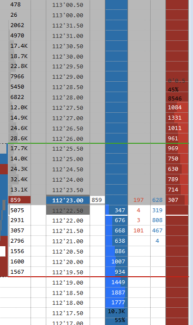

User611675 - Posts: 5
I have noticed that my dom prints are occasionally different between SC on Windoze and various linux distros using wine as well as via crossover on mac (see screenshot).
Does anybody know why this happens?
