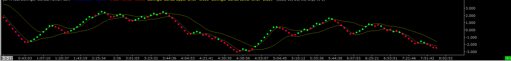

Xfanman1 - Posts: 320
This study exists in the User Contributed Studies so the formula should be available there I'd think.
jdtMACD/BollingerBands/Heiken-Ashi
Scott
imageMACD_BB_Study.PNG / V - Attached On 2018-03-12 12:04:35 UTC - Size: 25.27 KB - 968 views
imageMACD_BB.PNG / V - Attached On 2018-03-12 12:04:46 UTC - Size: 16.62 KB - 789 views

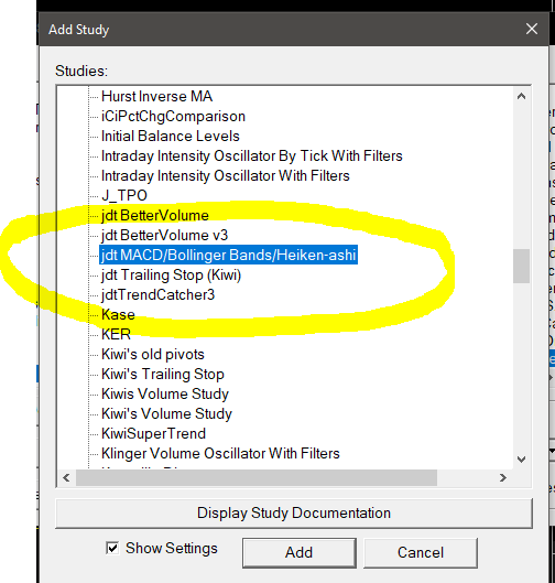

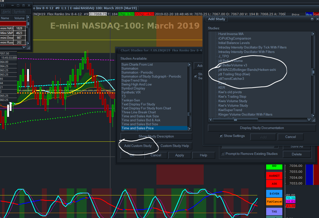

[2019-02-20 23:53:26]
You need to use the Add Custom Study button then select the User Contributed Studies and you'll find the study you're looking for as I've highlighted below.
Scott
imageBBs.PNG / V - Attached On 2019-02-20 23:53:13 UTC - Size: 122.27 KB - 900 views
