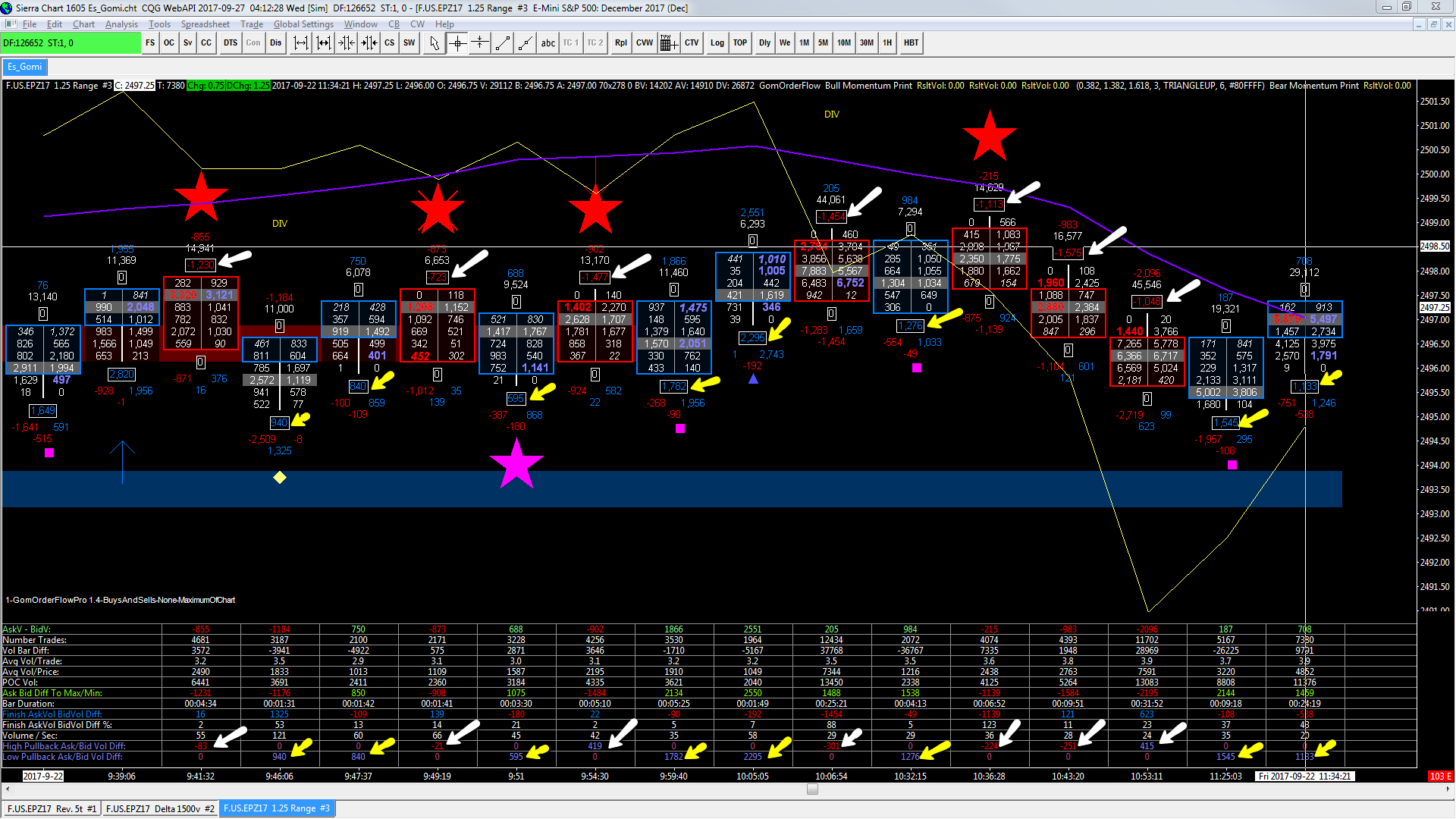

I am using GomOrderFlowPro from gomicators.com as footprint, and one data this Study provide is High COT that is the same data as "High Pullback Ask Volume and Bid Volume Diff" for "Numbers Bars Calculated Values" study from SC.
Problem is that this values are not equal when it have to be.
www_screencast_com/t/gSJakHJxPXB
Please review attach image (see Link above) as an example of what i am trying to explain...
I use Yellow Arrows to signal when "Low COT" from GomOrderFlowPro is equal to "Low Pullback Ask Volume and Bid Volume Diff" from Numbers Bars Calculated Values SC Study.
I use White Arrows to signal when "High COT" from GomOrderFlowPro is not equal to (When is has to be) "High Pullback Ask Volume and Bid Volume Diff" from Numbers Bars Calculated Values SC Study.
Could you help me to review and fix calculation for High Pullback Ask Volume and Bid Volume Diff, please ?
Thanks a lot for your help.
Kind regards.

Where can I find the table located at the bottom of the screen of the image posted by user240765.... the last two lines would be very useful to me. I use Number bars calculated study and the functions but I don't understand why I don't have a zero in the table. I think that the study does not take the last highest (lowest) but simply displays the Delta of the two. How could I only display the Delta of last highest (lowest) price.
tku
[2024-04-25 14:50:10]
We can not say why that particular image has the zeroes like it does. But you have access to the same study and information in the "Numbers Bars Calculated Values". Refer to the information at the following link for how those values are calculated:
Numbers Bars: Numbers Bars Calculated Values Subgraph Descriptions
