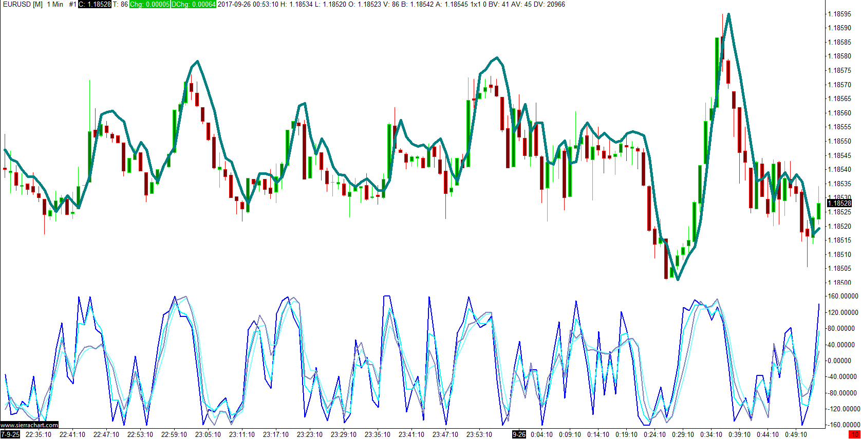

http://www.sierrachart.com/image.php?Image=1506387592863.png
I only get two of the blue lines in the lower graph (in previous exports I would get three, but I can never get all four in all of my attempts of exporting the data). I also get an additional line from chart 1, which is hidden but still shows up in the text export.
There is also additional (straight) lines that show up in the text file export, even though I have hidden these in the chart they still seem to show up. I have not experimented with deleting the lines, but the text export still picks them up even though they are hidden.

The file you attached has 14 study Subgraphs in it. That is a lot more than 8. What you are saying is in conflict with what we can clearly see in the file. Make sure you look at the bottom of the file for the most recent data.

That's exactly my point, I only have 8 in the chart, and I get 14 out, they are extra points that are hidden. I was able to eliminate the extra columns after chaining them to ignore (hidden does export in version 1613). Things are good now, thanks.
